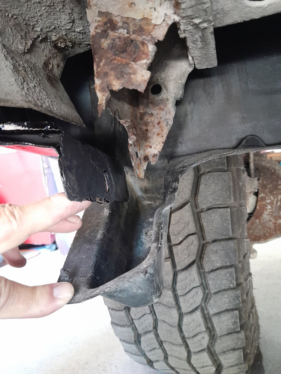

Doing a little underbody repair work so I can put my freshly painted fenders back on. The bottom bracket the fenders bolt to is completely gone on both sides so I'm making replacements. Not tried this before so this is new territory for me. Need to clean it up, punch a hole for the fender to bolt to and spot weld it in place. Coat it with POR or some other encapsulator

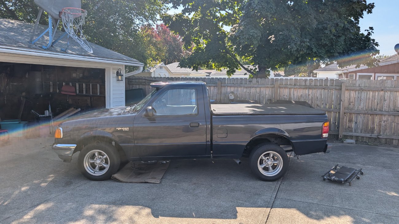

This is what I did to my Ranger last week. I flipped my rear leaf spring brackets on my 97 Ranger. I love the way it looks and it rides way better. Special thanks to Jim for his article on the subject.

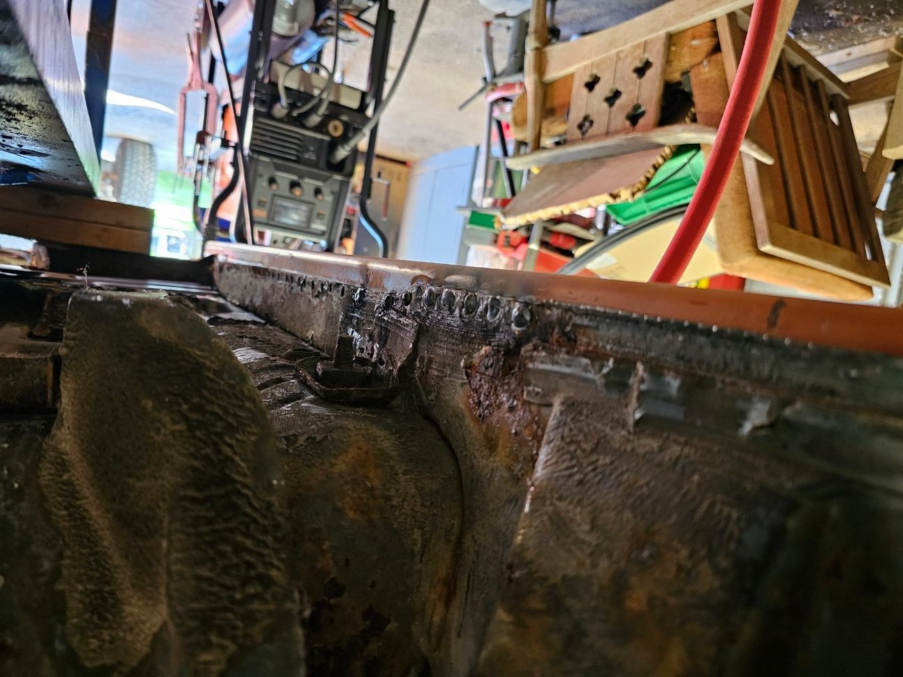

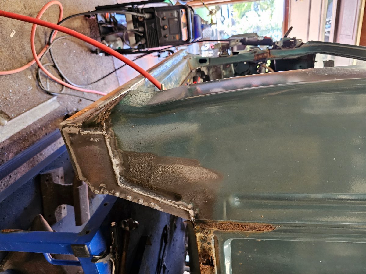

Worked on my square (ish) tube rockers on my replacement cab and did some rust repair along the way. Slowly working my way around the cab, next comes the back wall and a couple small patches in the rear of the floor.
The tube is a cross bar from a pallet rack which works out to be the perfect size and shape to box in a rocker. The outer portion of them was mangled by the scrapper I bought the truck from so I figured it was a good time to do what I always wanted to and box them in. The metal is about 0.090 so thick enough but not too heavy.
The back side of the factory rockers was punched for plug welds, once the cab is off the workbench I'll be able to get to the rest of them.
This portion of the cab corner was rotted so I chopped it out and replaced it.

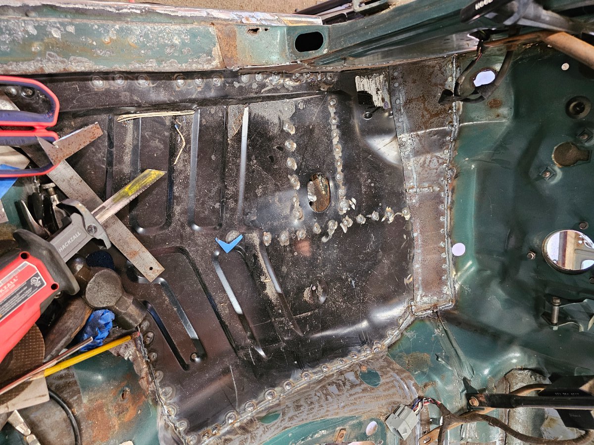

Bonus pic of the driver side floor pan all finished up, with the patch I had to add to the bottom of the firewall.
