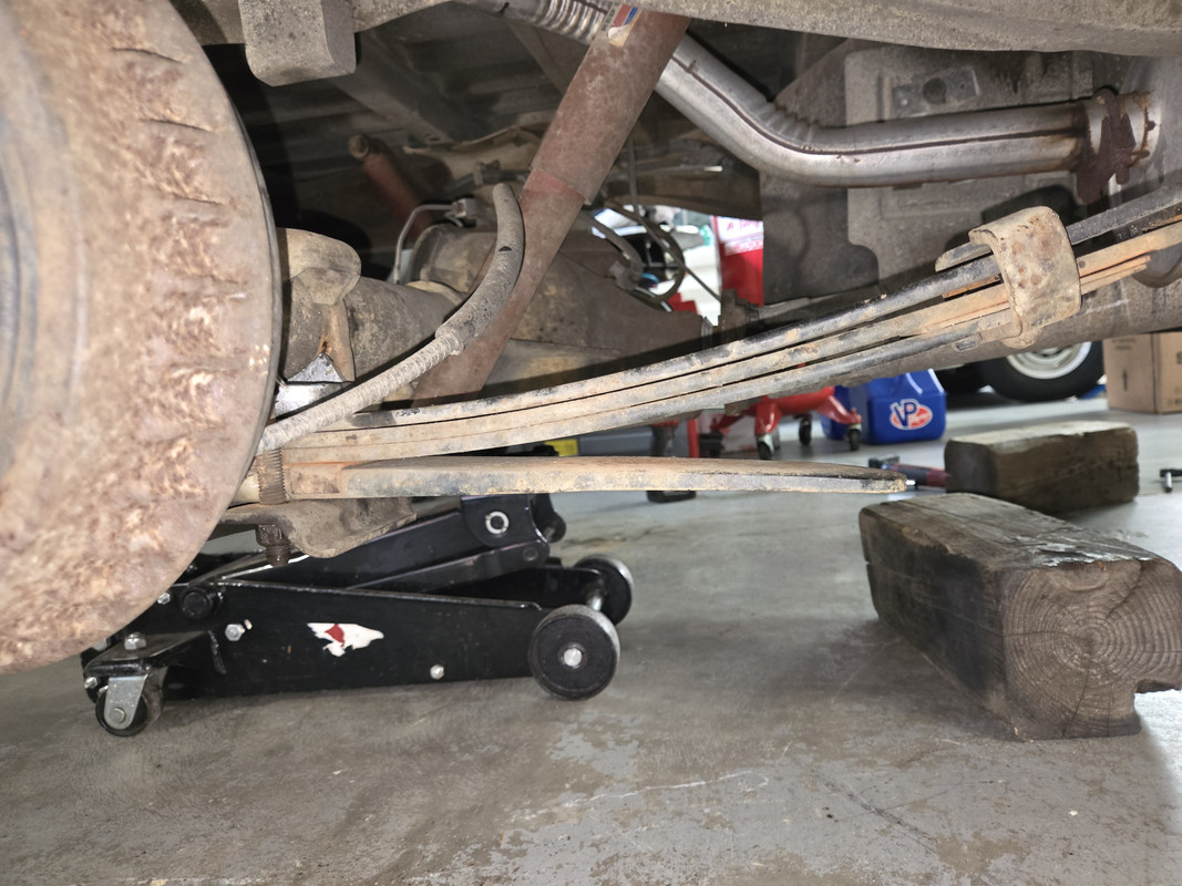

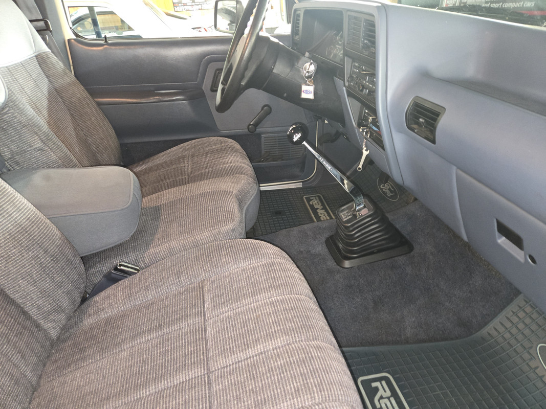

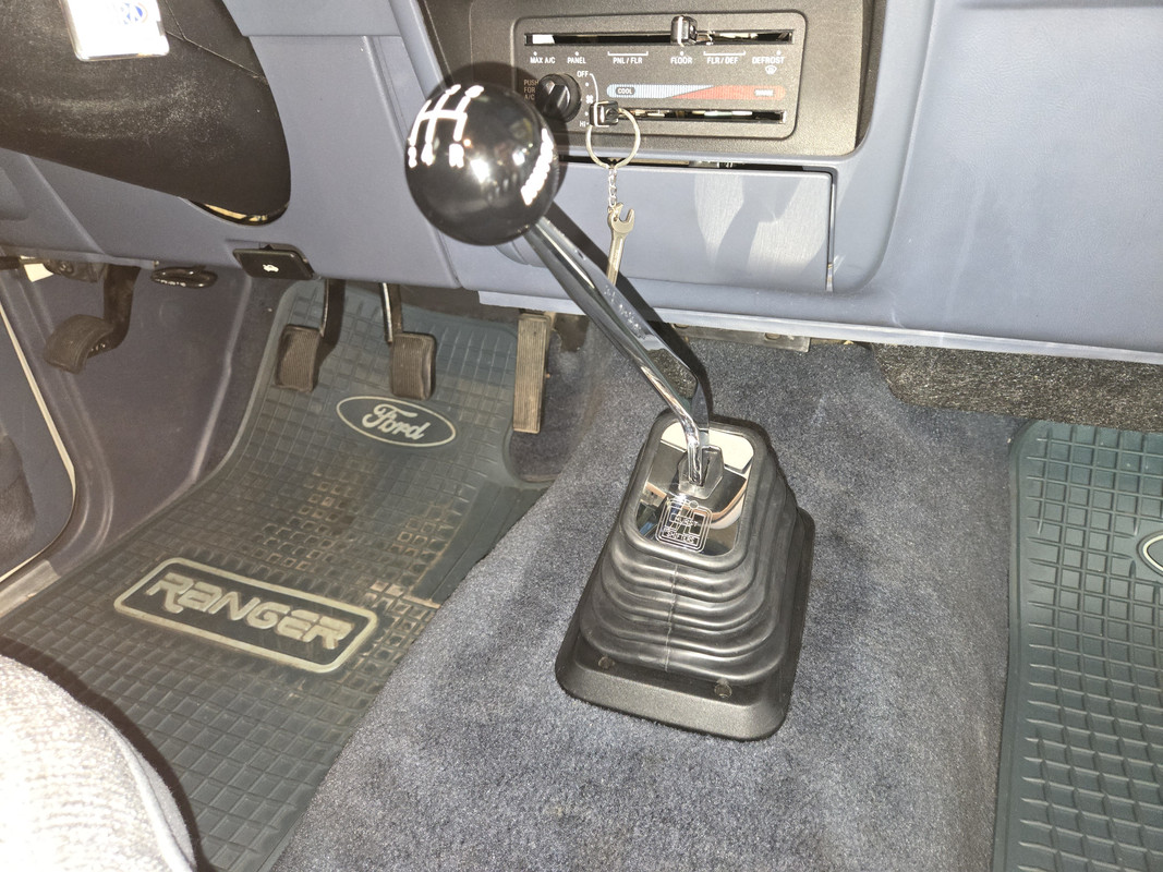

Installed a Hurst shifter on the M5OD. Dam it's super tight and short throws! Haven't driven it yet,still dicking around with the suspension.
Mocked up the rear with a spring under set up,the axle hit the bump stops before the frame lifted off the jack stands. LOL. I'm wondering if the overloads have been flipped over in the spring pack. They bend down at the front/back. Kind of doubt it because the truck was bought from an old Dude,one owner.
Normal?
Normal?
I’ve seen the overloads in both that position and reversed. I’ve also seen overloads that are pretty flat. I put them curve up on my F-150 to take advantage of it, since it’s my workhorse.
Normal?
My overloads are flat but I also don't have the OEM springs anymore either. I seem to remember my OEM ones having a bit of a curve down.
Normal?
It’s not polite to challenge old dudes regarding them being normal…
That shifter is nice. I put one in my ranger and it made such a difference in hownthe truck feels
