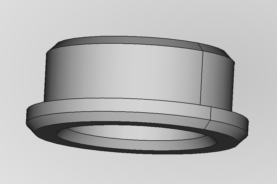

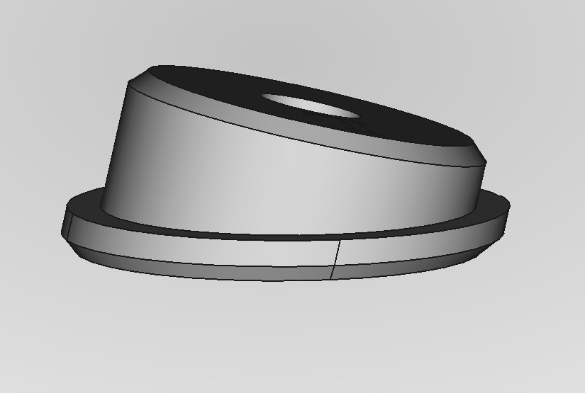

I designed and 3d printed a couple of bushings to repair a couple of screws that pulled through the top of my instrument cluster bezel.

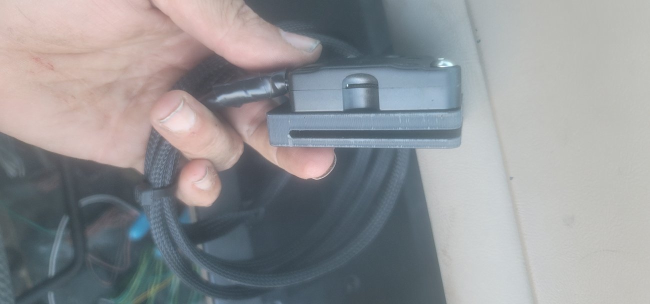

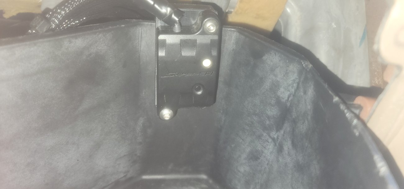

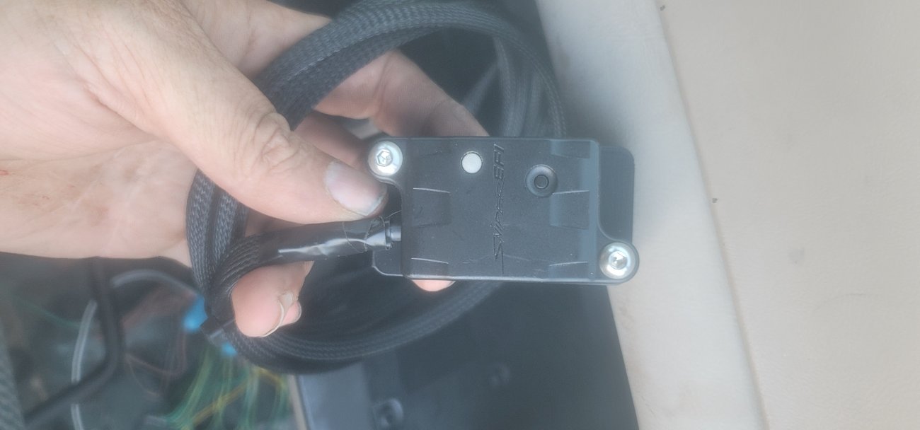

I also printed a thingie that my Holley sniper bluetooth module screws onto and clips onto the back edge of my glove box.

That was a good idea, would save a lot of bezels. More than a few are broken like that, and it's difficult to find replacements that aren't as bad or worse.

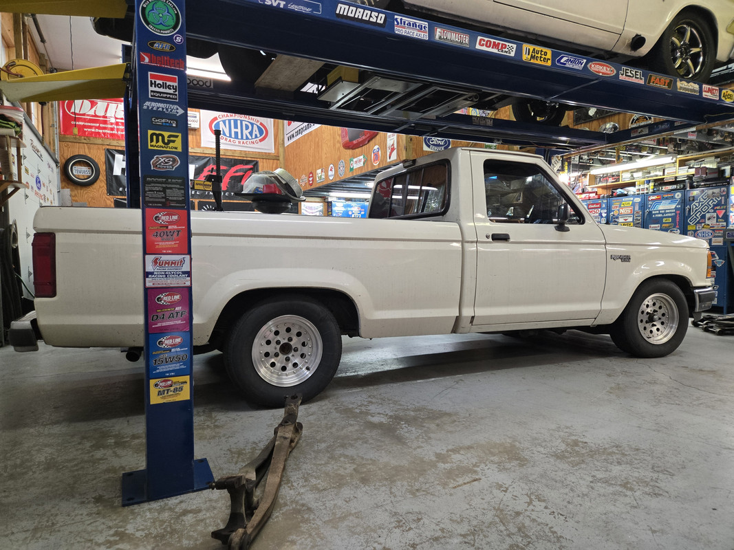

Installed drop beams. Now to get the rear down a bit more.
What you got in the rear now? Looks like maybe a shackle flip.
