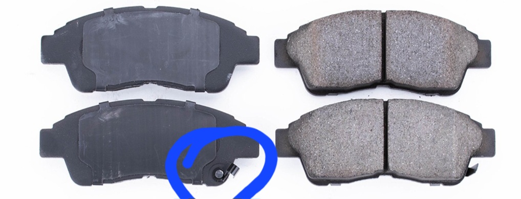

Installed Powerstop Z17 front pads a week ago. Getting a grinding noise the very first stop of the day (yes I did the bedding in process on new rotors). Have only driven it 20 miles since pads installed, but wondering if I installed them in the correct orientation. Does anyone know of the little tab in the blue circle means its an inner or outer pad? I could also have a pad guide not centered as well. I'll be taking them apart this evening to investigate so would like to make sure the pads go back un correctly. Thanks
The little "tab" is a wear indicator. It will screech when the pads wear to the point it rubs the rotor. AFAIK... it's pretty much always on the outside pad.
