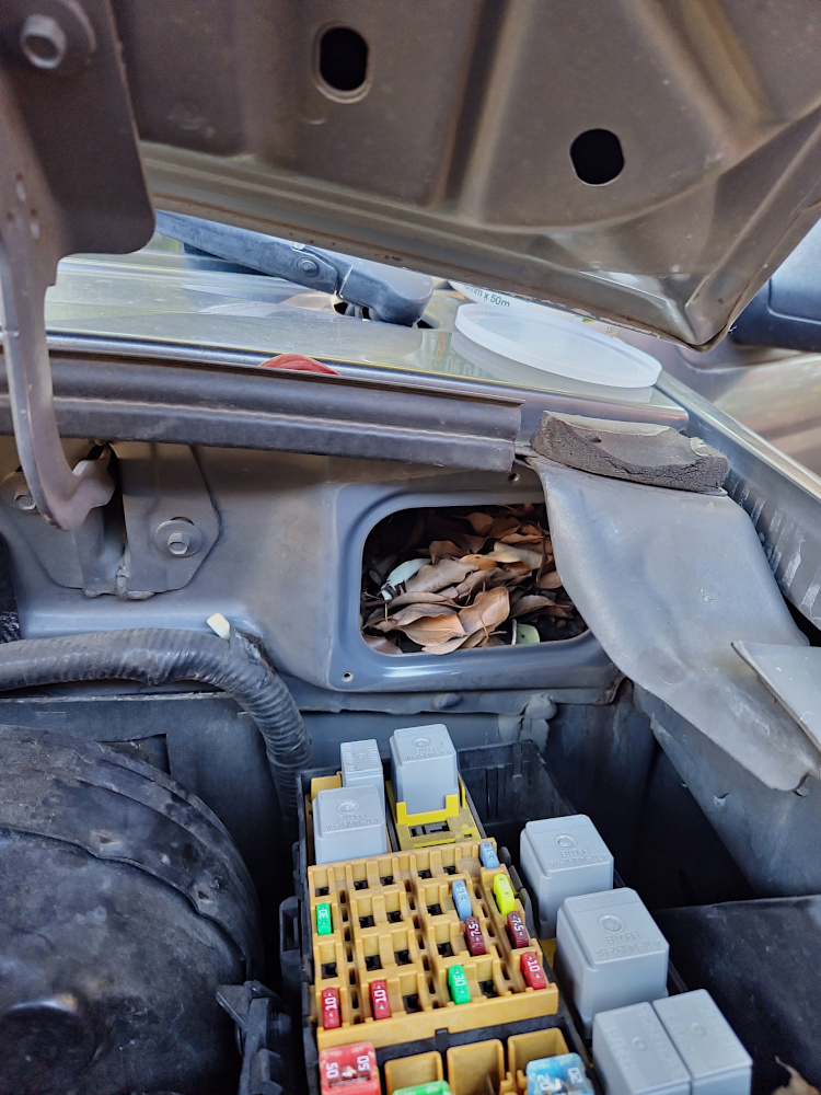

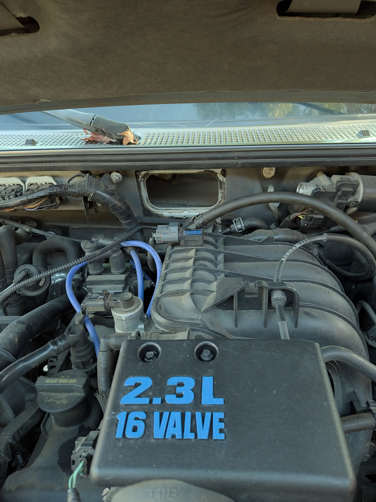

I cleaned the leaves out of the cowl. After I cleaned it the heater was still blowing leaves into the glove box and onto the passenger floor. I removed the blower motor and the glove box to clean it out which involved the use of a vacuum cleaner to suck the leaves out of the plenum from the passenger side and a leaf blower to move the leaves around the plenum so they would blow past the vacuum nozzle. It works 90%. The remaining 10% involved some small twigs, pine needles, and tiny bits of leaves. I fired up the air compressor and blew air around the inside of the plenum to get more of junk out of there. It worked. But, I forgot to turn the vacuum cleaner on this time and blew the remaining debris all over the passenger seat. I'll clean it tomorrow.
When putting the screw back on the blower motor I dropped the 1/4" extension. It rolled under the blower housing. I tried to get it out by had, but it rolled further back. I tried my magenetic pickup tool, but a wiring harness pulled it free from the magnet. I had to remove the wheel well liner and splash shield to get it and cleared 17 years of leaves from the back of that as well and broke a few more plastic clips.
Sometimes I think we need a "What dumb thing did you do today" thread. I would be a top contributor.
