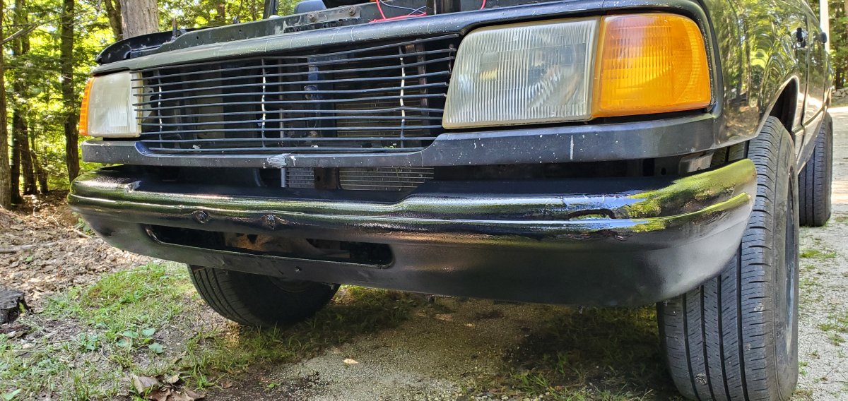

Also prettied up my Swiss cheese front bumper..
View attachment 116307View attachment 116308
MUCH better!
Somehow managed this though -__- and Isopropyl does NOTHING to help remove it. Don't feel like abusing my kidneys/liver or else I'd whip out the bottle of thinner.. really not suped about this lol.

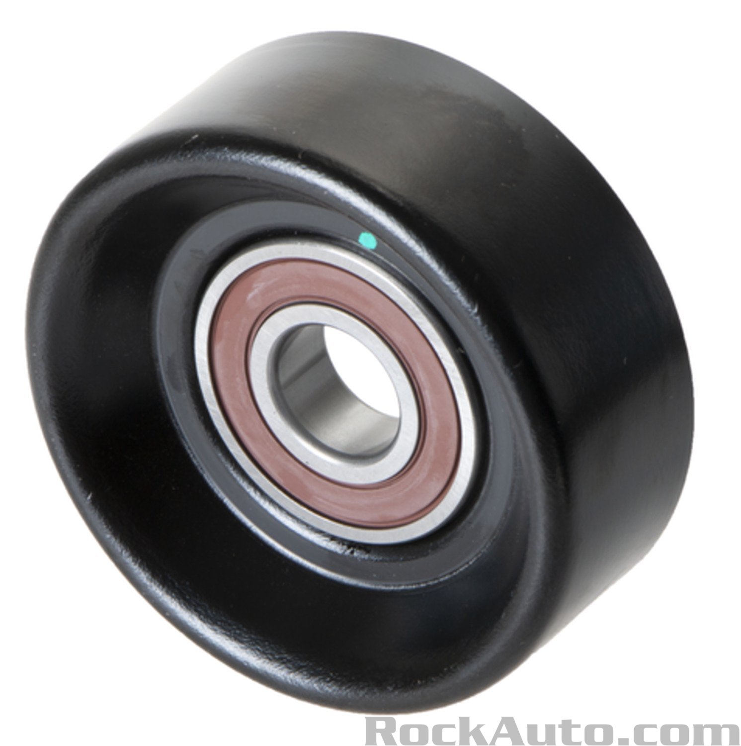

bguis this what your idler looks like?
View attachment 116319View attachment 116320
If it does, the one like Eric posted will work fine. Mine has been in for over 6 years without issues

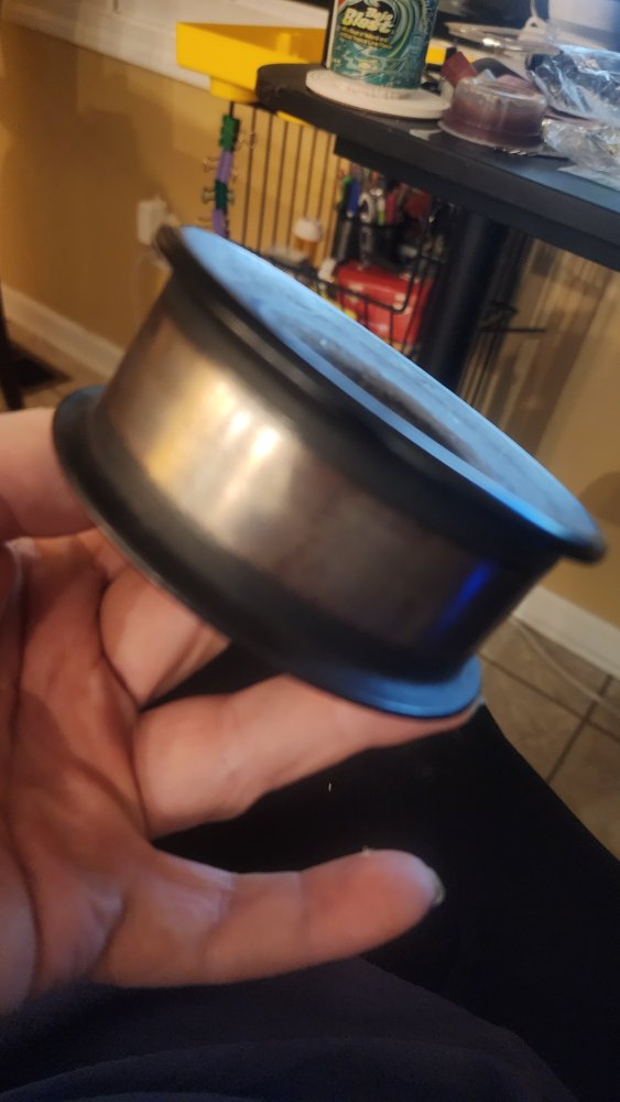

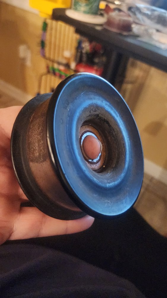

No the pulley that was on there was a plastic one that looks different. Here is a pic of what was on there:
As you can see from the second pic the belt was not riding exactly in the center of the pulley. I don't think that where it was riding was the cause but the fact that for some reason the pulley would rock at an angle to the motor allowing the belt to slip on it.
Here is a pic of the style I put on there and what I believe is the factory style from my experience and what @ericbphoto says is on his:

The belt does not have to ride in the center of the pulley. Ot just needs to be completely on the pulley. If you replaced the pulley with one of the same diameter, with or without guides on the edges, you will be fine.
Yes I replaced it with a Murray branded one with the same diameter and very close to the same offset without ridges. It looks like yours now and the bonus of no squeak yet. Oh and no rocking. The rocking was weird because it would only rock to one side but when brought back it would be perfectly strait and not rock the opposite direction. The bearing in the old one feels fine I can not feel any play in it at all. I have no idea what was causing the rocking.
If it rocked, it has play. You caught it early. Bearings are precision parts with extremely close precision clearances inside and it doesn't take much for them to be bad.
I'm thinking maybe one or two of the balls may have flat spots on them and they need to line up just right to get the play. If I had a press I'd press the old bearing out and cut the outer cage and have a good look. But alas no press without digging deep into a friends shed and it's not worth that much effort since it's fine now. lol
It doesn't usually happen that way and it's definitely not worth the effort unless you're just bored.
The grease eventually breaks down and what you would probably see inside at this point is some scoring g on the races and pitting or roughness beginning on the rolling elements. But, like I said, you caught it pretty early and it may not "look" extremely bad to the untrained naked eye.
