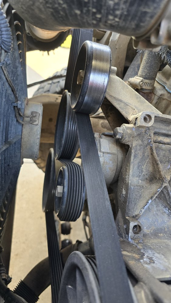

Went to O'Reilly and got the belt for Beer Fetcher. I checked online before going and saw they had an Idler Pulley in stock for it but it was a different style pulley than what was on there. The one that was on there was a flat plastic pulley with a ridge on both sides of it so I wasn't sure it was correct. I decided before I went there I would just change the belt there and if the pulley was bad change that too since I am right there. I did think of sending @ericbphoto a message and ask what pulley style he has on his engine since they are the same engine and only 1 year different but I didn't want to inconvenience anyone with something I can just measure and figure it out.
After removing the belt I spun the idler and the bearings felt great, spun smoothly and no extra force need to get it to spin. When I checked in and out play there was none but I noticed a little movement. It would rock at an angle to the motor and I knew this was not correct so I went in and had them pull the pulley they had and used their caliper to measure offset, diameter, bearing hole size, you know all the measurements to insure it would work properly. This pulley was a metal one with a rounded outer edge and no ridges on the sides. Because it was so different in that aspect I wanted to measure and be sure it would work properly. There was a slight difference in offset of 1/10th of an inch moving the pulley outward but everything else was with in tolerance on working. I finally said I'll take it and if it didn't work I'd just go back in and return it and order the other option.
I installed it and it "appeared" that the center of the pully was moved back towards the motor a little, the belt rode a little forward in the the pulley that was on there, so I was skeptical it would work but decided I'll put the belt on and see where it rode on the new pulley after starting the engine. After staring it I looked and the belt was riding dead center of this pully and, No squeak! :yahoo: I let it idle for a minute and gave it a few revs increasing the rpm's each rev and still no squeak. :headbang: I finally found the issue! Wrong pulley was installed when my friend changed it when the original went about 8 years ago. The pulley was changed then because the bearings in it went so it was squeaking then and has squeaked ever since.
I went back in and grabbed a deep well 15/16 socket and wrench since I need to retorque the eyelet bolts for my rear springs and wasn't sure I had the deep well socket and a wrench that size, If I do it wont kill me to have more than one.
When I came out I called my friend because I was so excited the squeak was gone that I needed to share it with someone, he is a mechanic, and was the one that changed it in the first place when it went bad all those years ago. Of course I got the friend response from him, "Nice!". I stayed on the phone with him all the way home and no squeak but this is only a 3 mile drive but enough that it would have squeaked if it was going to.
I call this one, 3 belts and an idler pully later, Fixed... Finally!

I know that pulley is probably a sealed bearing, but when you have it all apart, tie a rag like a scarf in the V of the pulley, and then spray penetrating oil/WD-40/lithium grease around the bearing and work the pulley a little tiny bit and it may penetrate. It may make the squeak go away. if it goes away and comes back, you know that was the culprit.
The purpose of the scarf is to keep the lube out of the belt channel. Put some brake cleaner on a rag and wipe up that channel before you put the belt on.
Also, if you can see anything that’s not supposed to be there or is inconsistent in the channel of that idler, if possible, use about a 4 inch wire wheel on a drill, assuming you can get it in there, and just drive the pulley with that wire wheel at a slight angle for a minute. That should clean out anything on the surface.
When I say turned at an angle, there was a sweet spot between just turning the pulley, and angling the brush so it cuts across the pulley. If you angle it too much you don’t drive the pulley. If you’re only driving the pulley, it’s not scraping the channel clean.
EDIT: if you can’t get a drill in there, you may be able to rig a wire wheel on an angle grinder and slide it down there.
I use that technique with all kinds of things on my bench grinder/wire wheel
my two cents, hope it helps
When I changed the tensioner back on 4/7/2019, I did try to lube the bearings and see if it made a difference but it didn't. Although putting a new belt on then did get rid of it for a few miles at least. :(
Thanks for the tips I do appreciate them. It's nice when someone is willing to share experience and explain the do's and whys of it.

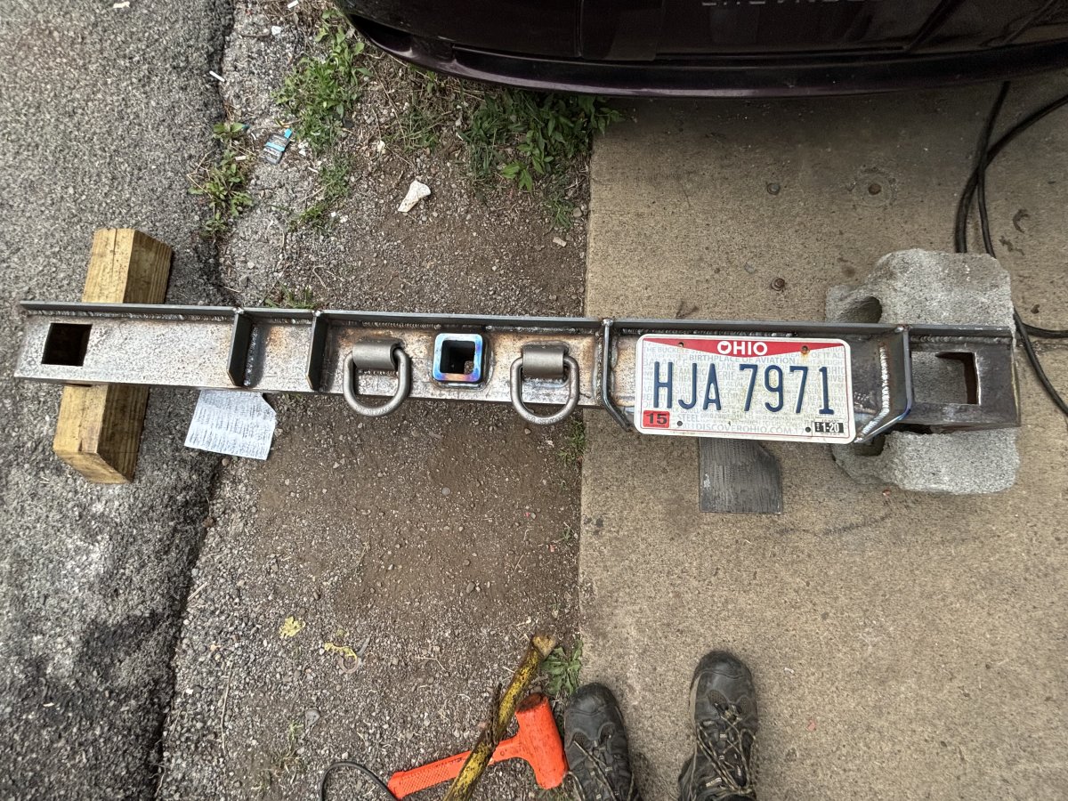

Progress has been made on the hitch bumper for the green Ranger. Unfortunately still a bunch of welding and Fab to do, have to get some bracing on the back side of the hitch, have to get the frame brackets set in place and welded, finish out the top after the bracing goes in, and that’s not even counting more grinding and welding and drilling holes. I’m probably just going to get the frame brackets and bracing done, drill my holes, soak it in WD-40, and finish it after the 25th anniversary. I’m almost out of shielding gas, money, and time.
That said, I love how this bumper is coming together.

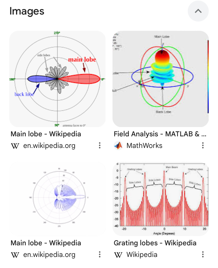

So I did a little search for broadcast patterns and broadcast lobes.
Right away, I found this:
my eyeball fell out of my head from the brain pressure.
When I looked a little more, a smart guy named @Jim Oaks has it written up on the website called therangerstation.com
“Radiation Pattern of CB Antennas”
Most people think that antennas mounted on vehicles are omnidirectional. This is mostly true, but the radiation pattern is influenced greatly by the body of the vehicle. Remember we stated that the body acts as the “radials” for the antenna? Well, we know that the body does not extend around the base on the antenna equally. Figure 2 shows how the radiation pattern of a whip is influenced by the body of the vehicle. As you can see, the shape of the pattern depends on where you mount the antenna. The pattern is “pulled” to areas where there is the most vehicle body. The pattern is the worst in directions where there is no metal body for a radial.
Figure 2 – The dashed line shows a omnidirectional pattern you would expect from a CB antenna, but as you can see, the pattern gets distorted from the car body not being even around the base of the antenna. This is why you should try to mount the antenna as close to the center of the vehicle as possible unless you desire a pattern that stresses a certain direction. Do not think of this as gain in a certain direction, this effect is actually detrimental to the overall efficiency of the antenna.
I had assumed the strongest signal would be opposite the direction of the vehicle, but it-the vehicle/ground plane- is not a “wall,”. Rather it acts to help focus the signal from the free part of the antenna. Hence, the antenna on the passenger side would do best to broadcast further up the road into oncoming traffic.
My duels are 6 foot. The bottom 1 foot is blocked forward by the cab and to the right by the headache rack. The next couple feet up are free going forward, but still blocked by the Aluminum headache rack, and contraptions, and the top 3 feet is clear in all directions. I’m going to do some research on how those variations in vertical height might affect the signal.
I’ll hook up the double cable again, disconnect the driver side antenna, and do some testing as I ride around with Lincoln. I’ll keep you posted.

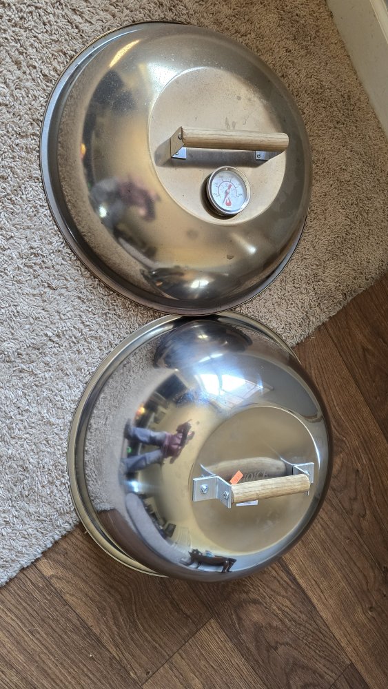

Ok. Second pizza dome has been manufactured.
Ranger received a quick-n-dirty alignment this morning that is proving to be pretty darn good. I'll drive it some more today and double check it tomorrow. Plus, retorque fasteners tomorrow. I still have grocery shopping and packing to do, plus a few minor details. But the pressure has been relieved. I feel good. Let's get this circus on the road.
The new dome is deeper than the first, so they will nest for easier packing.
