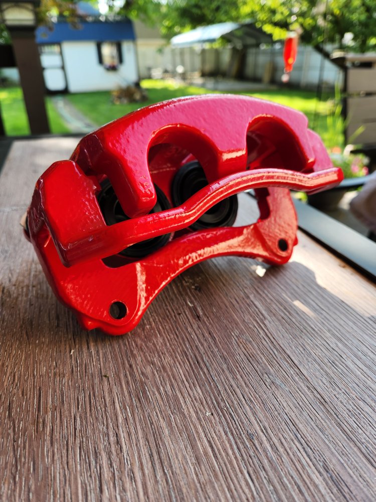

As much as you want me to day yes.... No.
Those are PowerStop powder coated calipers and brackets. I have new rotors and their ceramic dust free pads also.
Pretty! You're gonna get those dirty....aren't you?

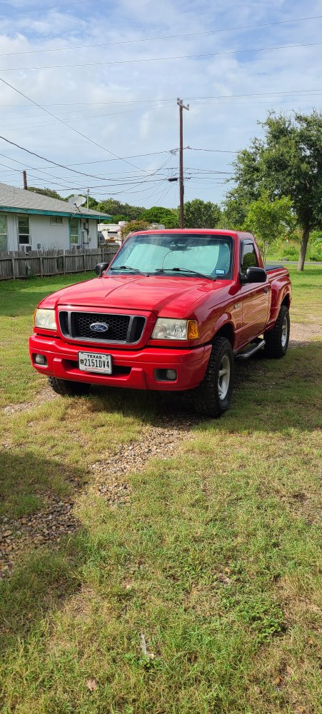

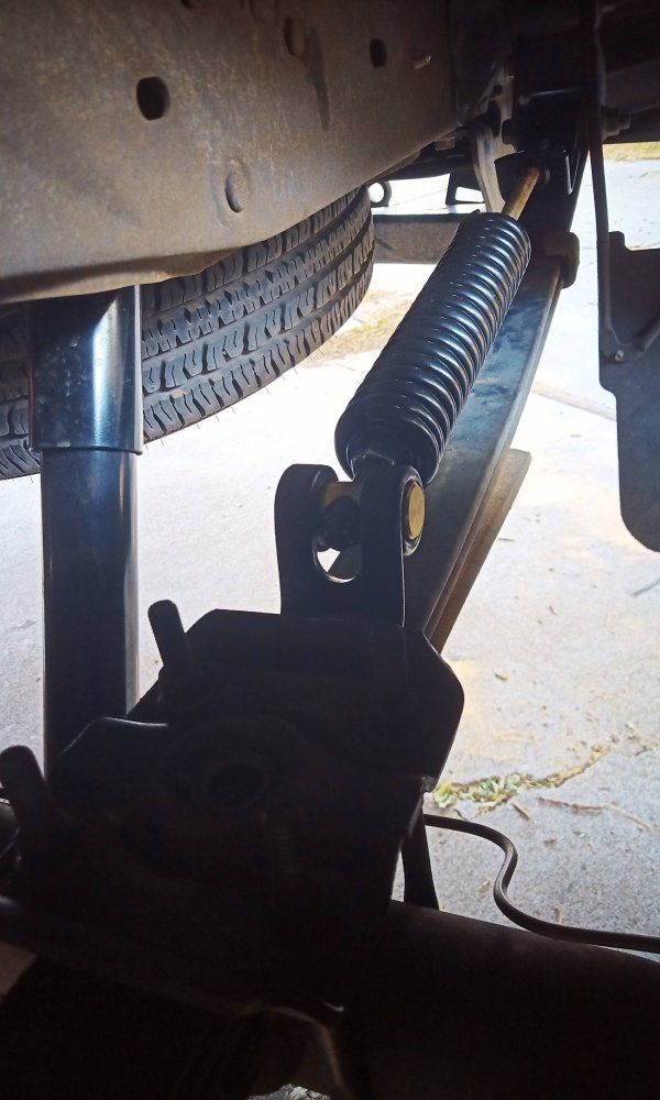

Installed the Road Active Suspension. Not as difficult aa I anticipated. Raised the rear from 29" to 34" at the top of the fenderwell. Ride is a little stiffer, not bad, but definitely.

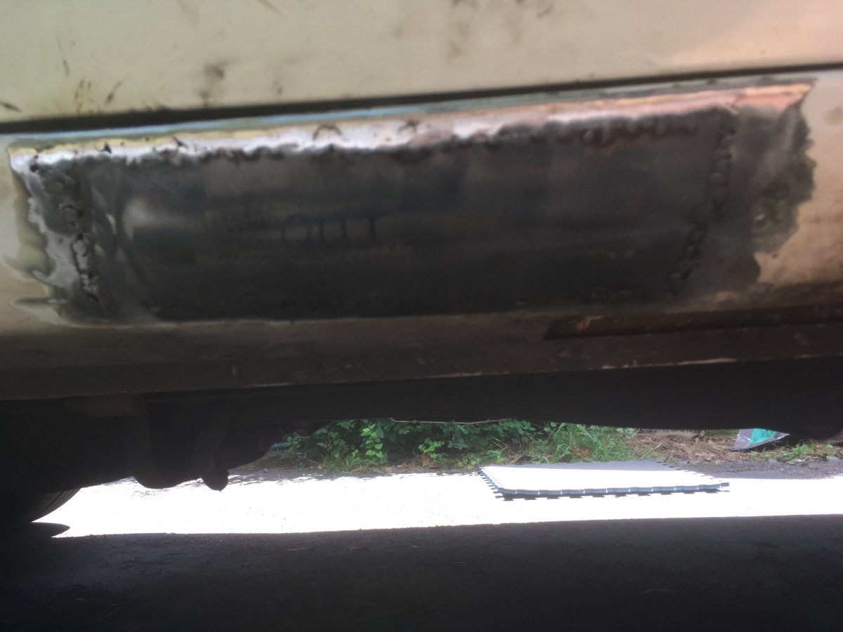

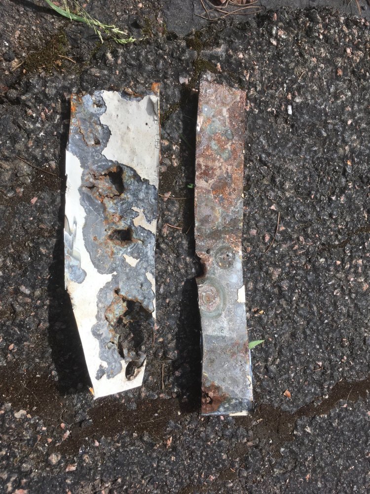

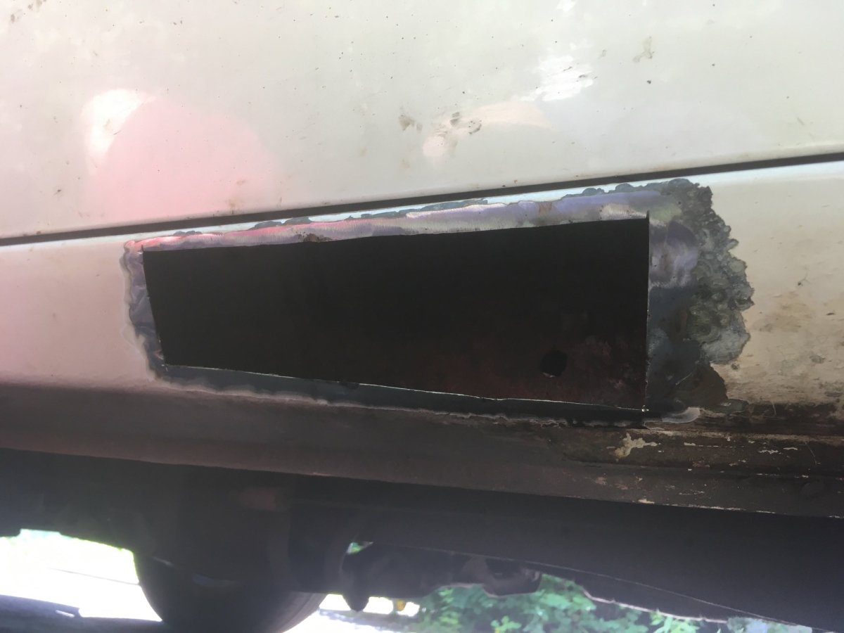

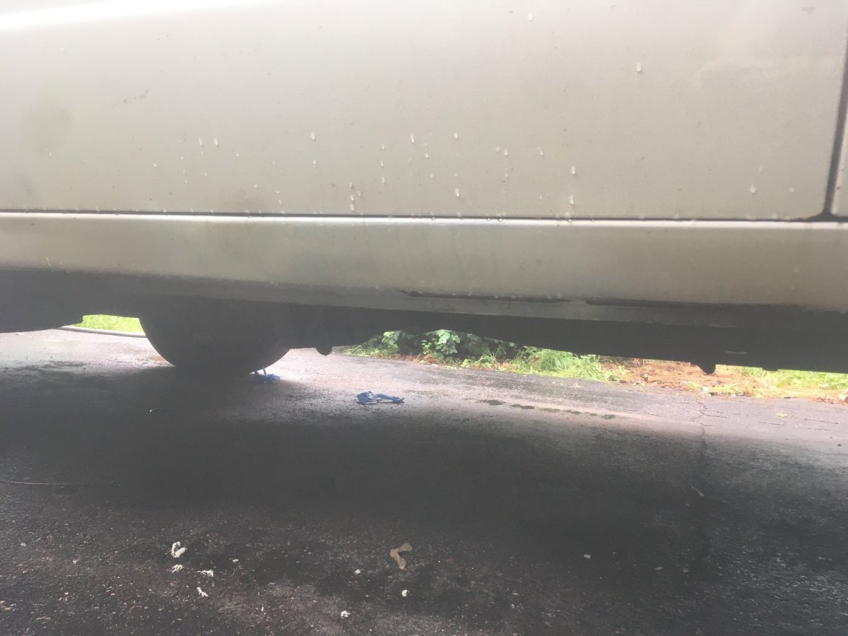

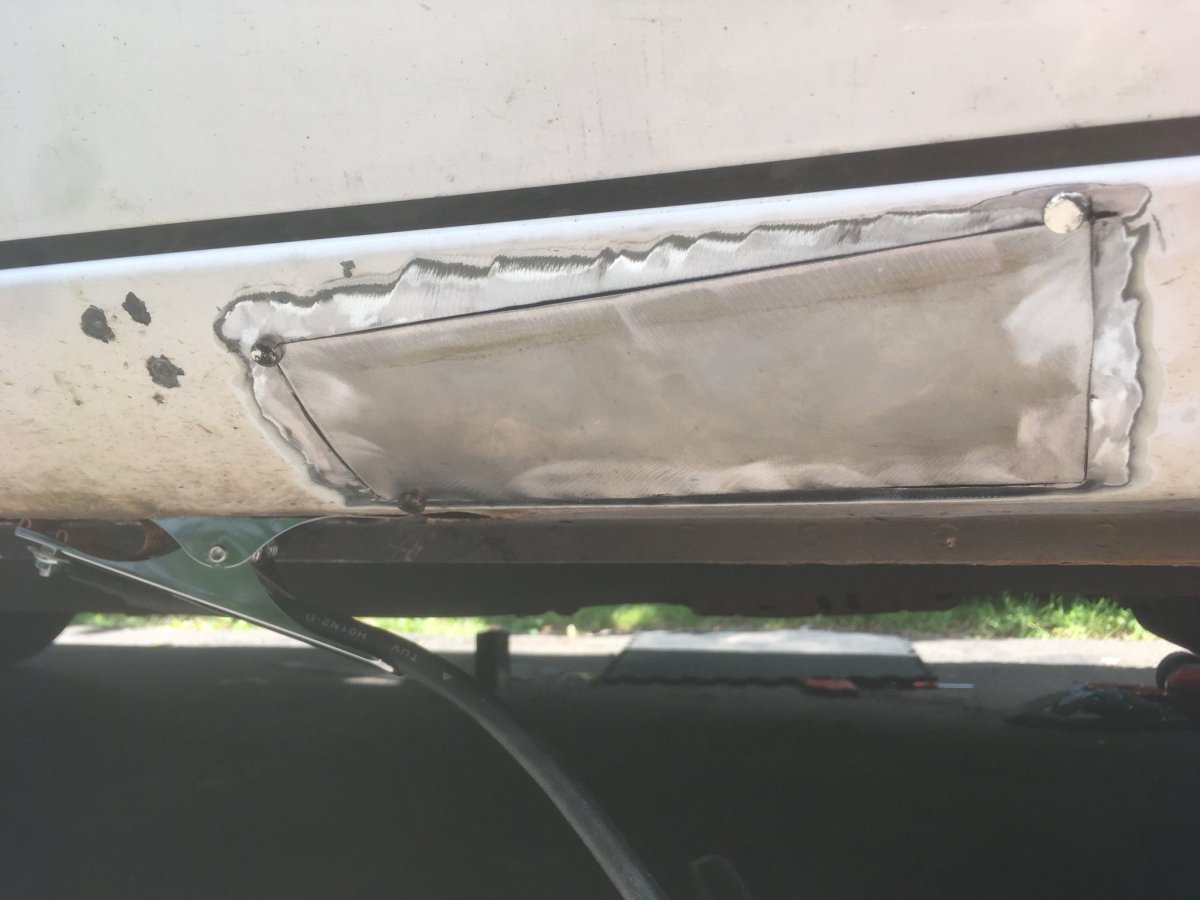

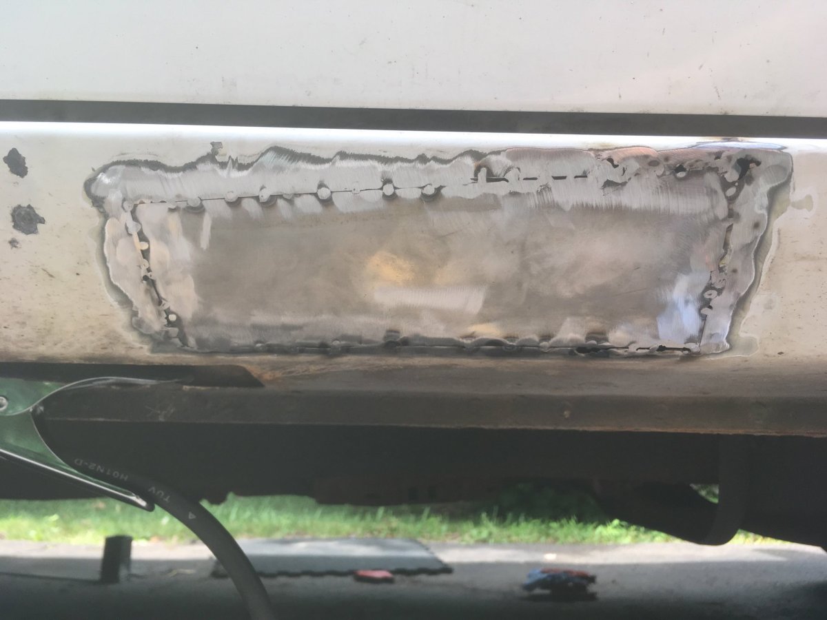

Now that I finally got a proper welding setup to do thin sheet metal, I finally got around to fixing my rocker panels that have been getting worse over the last few years. My camera is terrible and I'm way too impatient to document everything properly but I did snap a few bad pics along the way. Those pics of the welds weren't the final product - I took them during a gear-off break in the 95 degree heat. (There are more pics but suffice to say they were very similar on both sides.)
I did work on them a little bit more before I got to the bondo stage but I did get sick of chasing burn-throughs on paper thin rusty metal so feel free to mock them mercilessly. 😄
In case you're wondering, yes, I could have cut back a lot more to get to better metal, but I halfway wanted an excuse to test what I could do with this welder setup and I figured once these rust through again, I'll probably get actual rocker replacement panels and do it properly. You'd never notice it until you look very closely but there are actually a lot of complex bends and curves on that panel. The little patches I made were kind of fun to get right but anything beyond that would be beyond my bending skills...and tools.

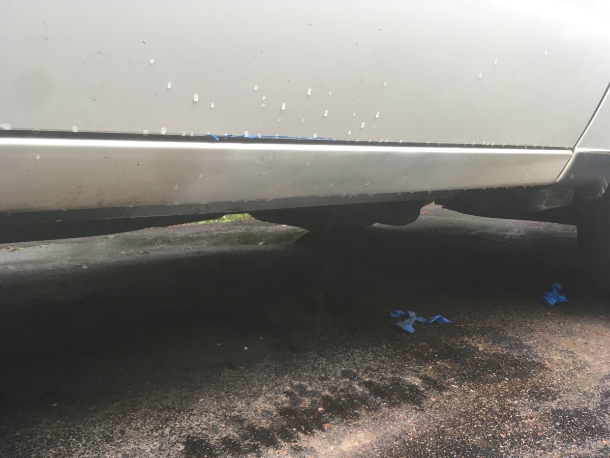

Thank God there was a storm coming in which forced me to abandon perfecting the bondo and just get it primed and painted. I'll go back and make it perfect someday. :rolleyes:
