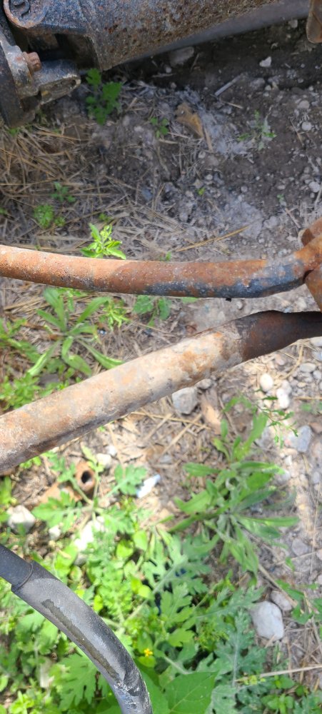

Finally hit the junkyard for that b2 rear bar. Its 1/8th larger than my stock edge rear bar (which looks the same as the stock normal ranger rear bar)

That'll probably be an improvement, but keep checking them. Some came with a 1" bar. I think I've ended up with two of those. One I bought years ago for my 84 and will be going onto my 99 with the Explorer front bar. The other I think came on the 85 Ranger. That truck isn't rear as stock or good of shape as I thought when I dropped the money, so seeing that big bar under there was a definitely surprise.
I will check everytime a b2 shows up. And i look at all the rangers, too, but they are always stock

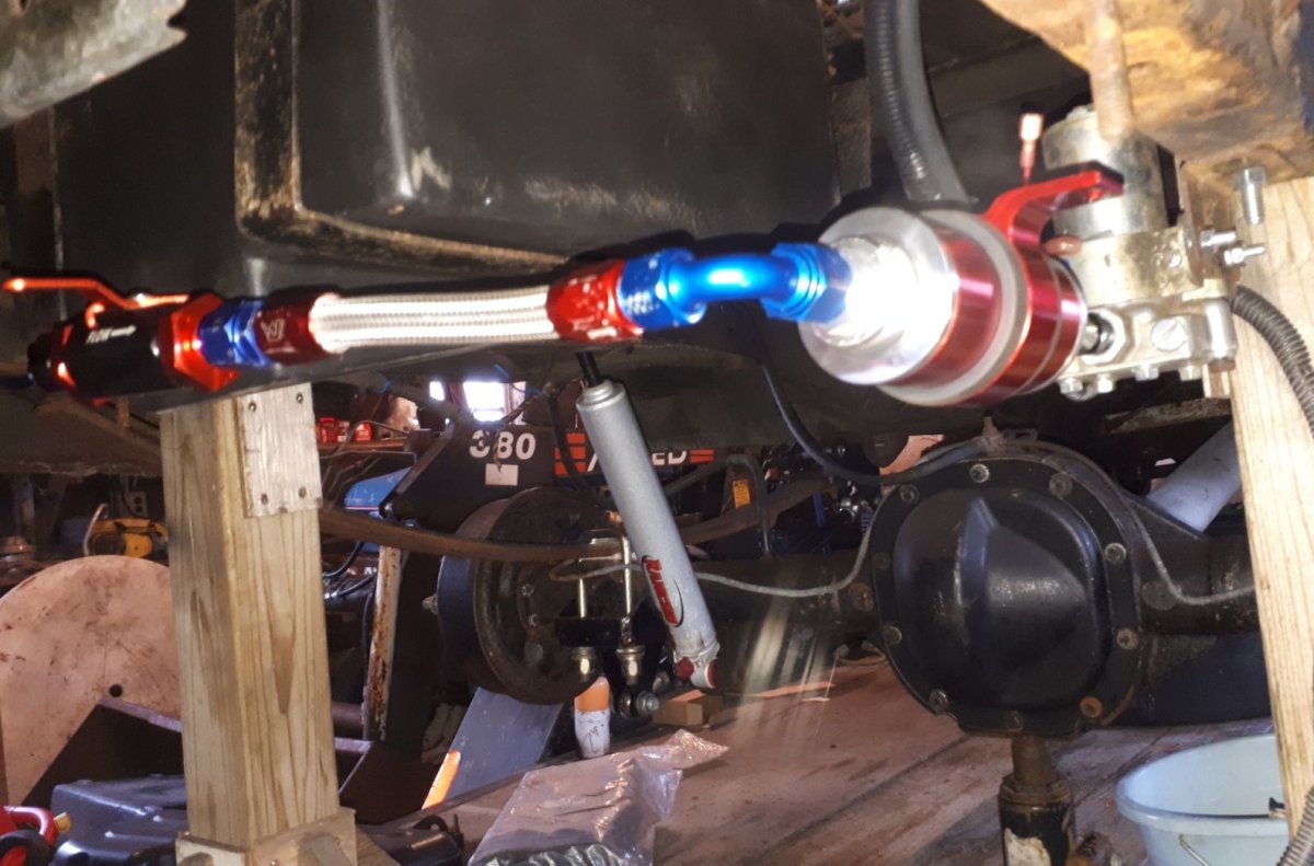

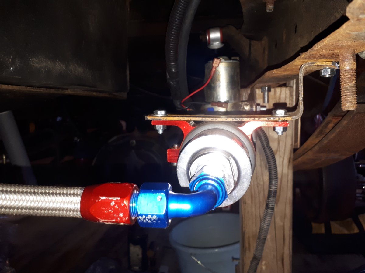

Got a start on the fuel plumbing job on the Ranger. EVERYTHING between the new fuel cell and the carburetor is getting replaced with AN fittings and braided hose so it's like starting from scratch at the fuel cell. Made a new mounting bracket for the filter and moved the fuel pump bracket ahead a little further on the frame. Just mocked up for now - got to take it all apart to put Teflon tape on the NPT to AN adapters before reassembly. Next session we run the new braided hose to the engine bay and get a start on all the hose sections we're going to have to put together between regulator, carburetor and fuel pressure gauge.
