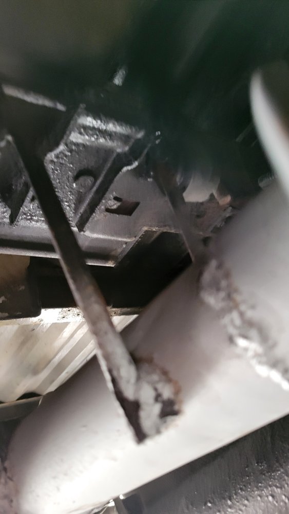

The man who installed mine didn't even use hangars. He used a pair of welding rods at regular intervals instead and welded them to the pipes and to the frame. I was a little skeptical at first but it's proved to work out well with no rattles down under.
Actually I take that back. There is a proper hanger at the very end of the line, but otherwise he welded rods directly the the pipes. Maybe this
is close to what the manufacturer intended. BTW Rustoleum makes a very good paint for exhausts. This is 2 years old.

View attachment 107923View attachment 107923
You might want to look again.... those look to be the factory hangers welded to the new pipe and placed through the factory rubber insulators.
Those look like the factory mounting locations. They make pre-bent hangers that are intended to be welded to the exhaust. Those appear to be them and the rubber isolators appear to be OEM equipment, new replacements but factory.
What they said, basically looks like the rubber insulators that were on my 99's factory exhaust. On what they did for me they weelded a new mount to the crossmember at the front of the tank. Not what I wanted, didn't want any thing welded to the frame, but forgot to mention that when dropped it off. Still rubber insulated and should be easy enough to remove with the next round.
