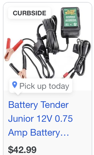

Battery tender Junior is probably the best, but they’re about $50 walking out of the store.

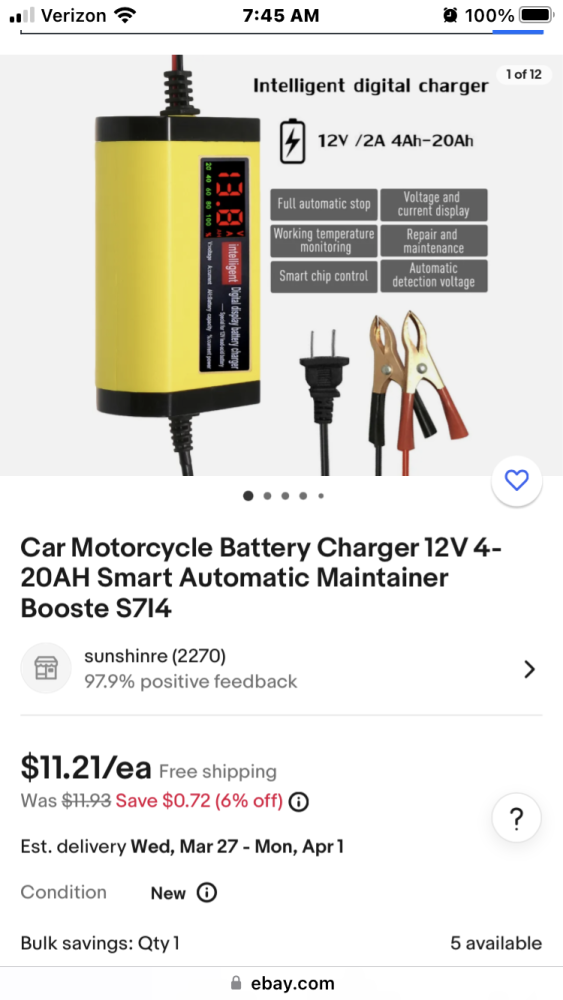

Online (EBay), I found this 2A charger from China. Let me say there are a bunch of Chinese trickle chargers, I’ve probably tried half of them, and I am recommending this specific one. There are a few that look similar, but this has a voltage read out on it, and also tells you the amp hours. And then it has five lights underneath that tells you if the battery is 20%, 40%, 50%, etc.. These are about $10, and if you buy two or three or four at a time you could get 10 or 15 or 20% off that.
Like the battery tender Junior, if your battery is around 90%, it will charge it all the way up and then maintain it without overcharging. I think you can get an identical looking charger that does something like 6 A or 10 A. Don’t do it! I’m specifically recommending the 2A. Theoretically they can charge a battery that is dead, but after a few tries, this little yellow charger dies. I only use them for maintenance or when the battery is pretty much close to fully charged.

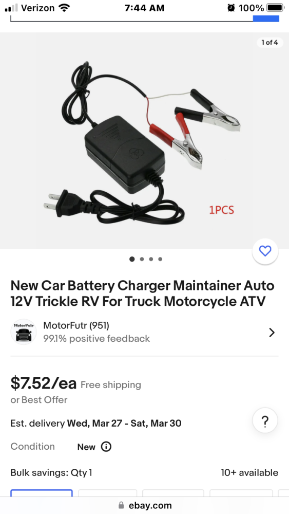

Even cheaper, is this one
And you can buy these in a four pack or a 10 pack and get them for under seven dollars. I only clip them on when the battery is fully charged from a charger, but it will keep it 100% charged indefinitely without overcharging it. It has a little red/green indicator light.

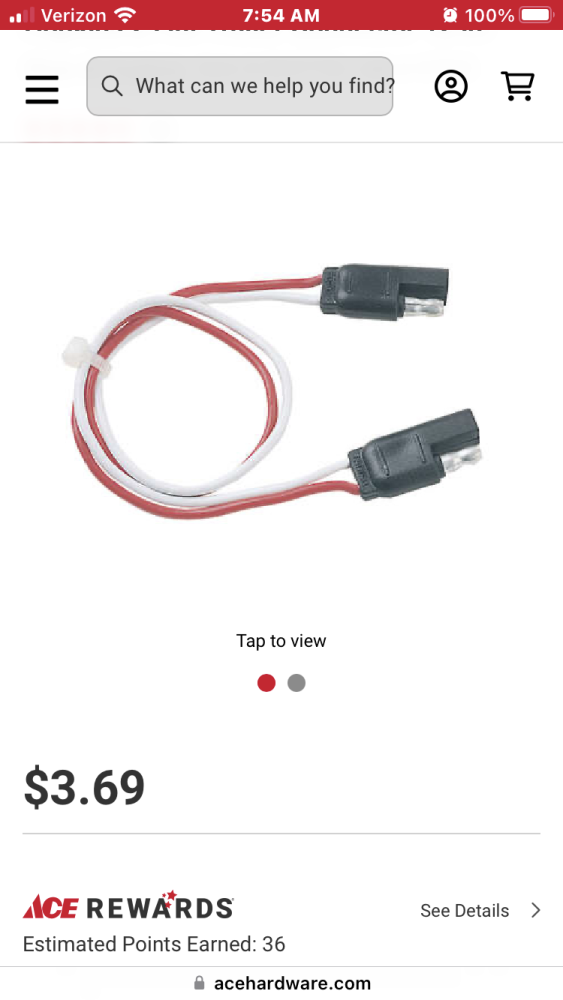

The other thing I’ve done on everything is I’ve wired a little pigtail to the battery that hangs under the grill, and then I have spliced in the same male female connector on the 12v feed out lines of the trickle charger.
I can use the trickle charger with its clips, or I can quickly pull the clips off and simply plug it into the pigtail on the vehicle (without even opening the hood). Two things to watch here. 1, make sure the pigtail you buy is at least about 18 or 16 gauge wire. Some of the cheap ones have pretty thin wire 2. When you wire the pigtail on the vehicle, do it so the exposed pin is the ground side, so, in case the coupler flops around it doesn’t short out. I also have one of these with about 20 feet of lamp cord spliced in on the 110 side. They all work fine. I guess my point here is the easier you make it to use, the more likely you will actually use it.
Last thought, these have had a little rain sprinkled on them from time to time, but I don’t think you can get them wet. I have mine set up with a little piece of permanent baling wire close to the device, so when I plug it in under the car, I can hang it under the car off the ground.

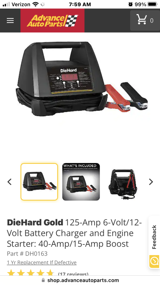

When I got hit by the lightning, my insurance provided for a replacement. Even though the Sears charger was from the time of Christ, it was top-of-the-line at the time of Christ, and I was able to buy a top-of-the-line replacement. I got this diehard smart charger. I think it was about $200.
This thing not only charges batteries, it will analyze them. It analyzes every time you connect it up. If you connect it up and let it charge, and when it’s complete, you disconnect it and repeat the process, and record the data, you can go to the literature on this thing, and it will tell you more stuff than you ever wanted to know about your battery.
It also has the 40 amp quick charge feature, and the start up boost feature. I’ve had a lot of battery chargers that claimed to do those two things, but they didn’t work worth a crap. This one really works.
