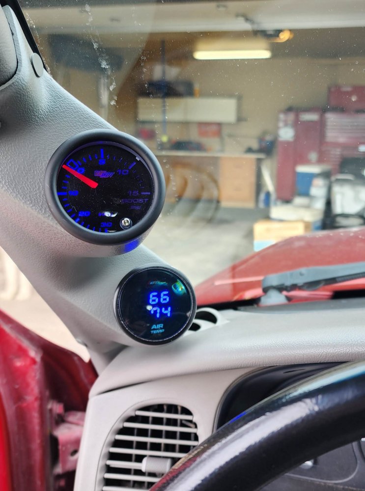

- Finished up my pillar pod holder. I'm using a Glowshift Vac/boost gauge on top for the supercharger and testing a dual temp digital on the bottom. I am not loving the temp gauge. Sometimes it bounces wildly +/- 5deg. The top is to a sensor near the grill, and the bottom is the interior temp near the footwell. The night mode is still ridiculously bright too. The Glowshift is perfect.

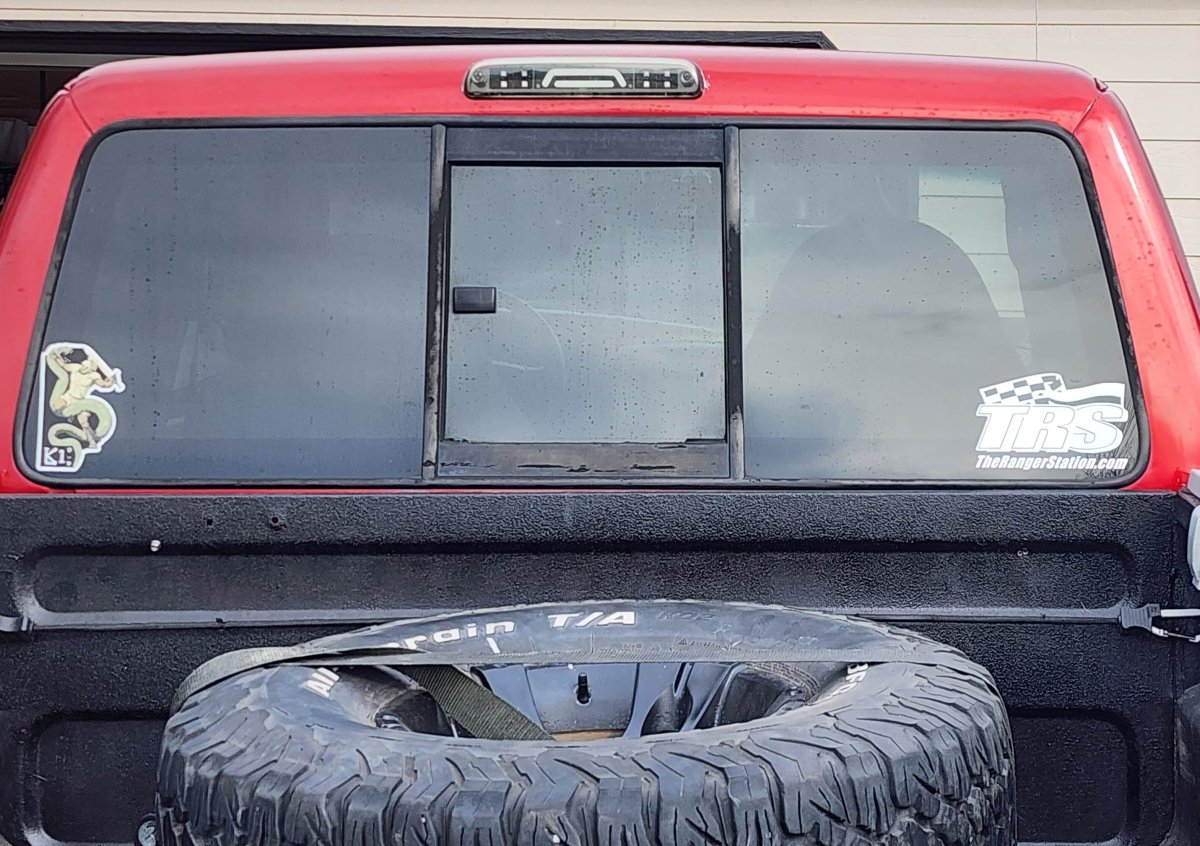

- I got my TRS decal on the window! Looks good! Thanks Jim!
