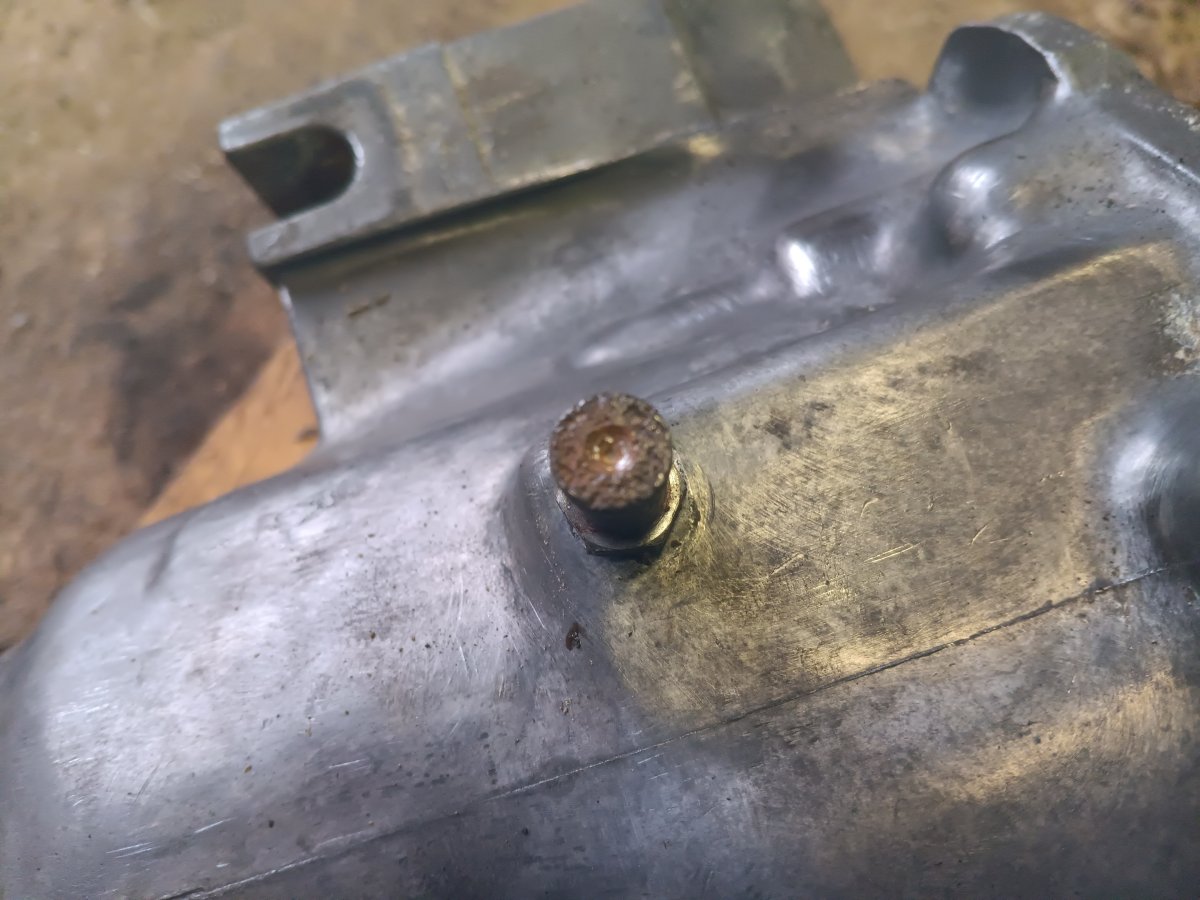

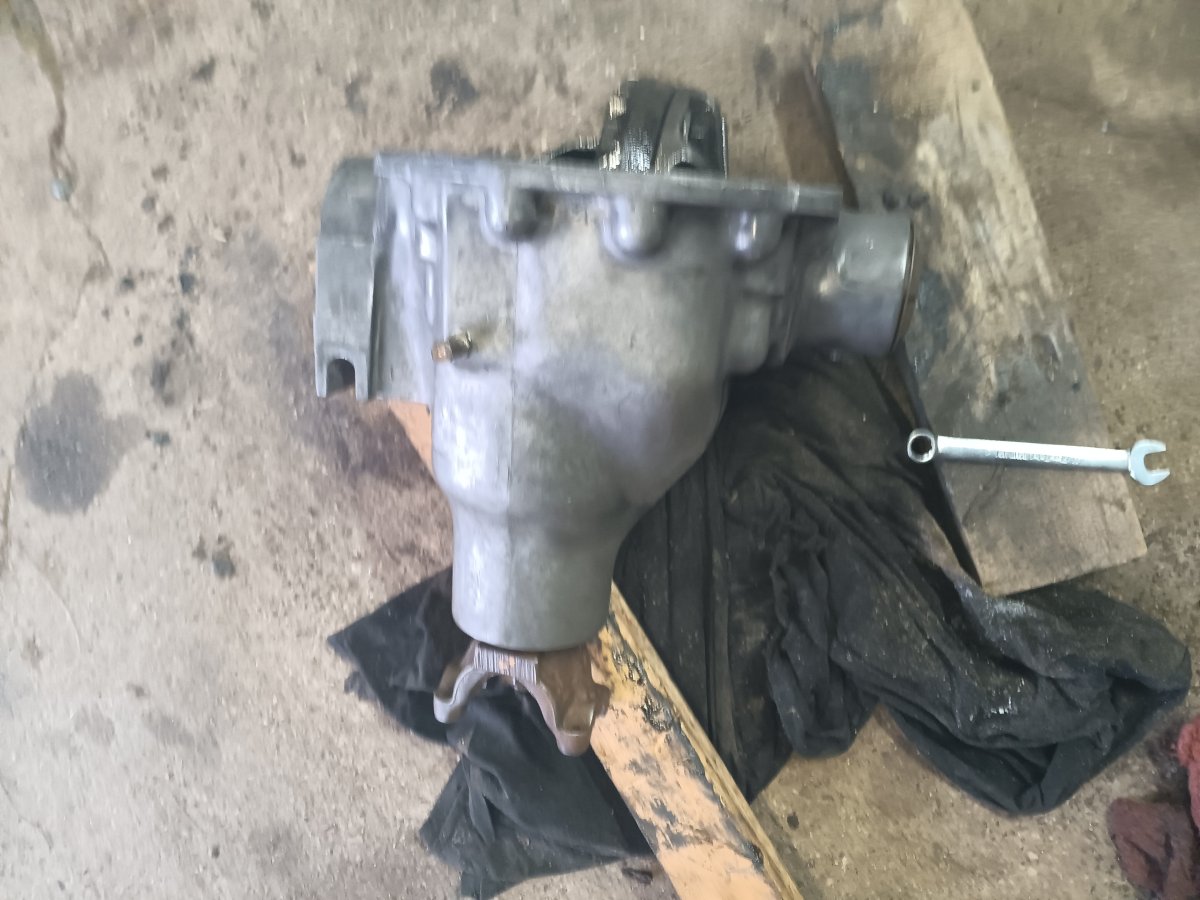

Pulled the retired 89 BII in the barn and pulled the 4.10 pig out of the front axle. Took some time cleaning it up. The vent tube looked like the mud daubers packed it full so I took it off. Found the vent fitting was plugged with what I don't know. Had to use a drill bit to get it opened up.
These 28s are so tiny. This one originally came out of my blue 85 (Alice). Factory unit. Gotta move a few trucks around then I'll take the matching rear 7.5 LS 4.10 out. Fun day in the Bronco barn.

Pulled the retired 89 BII in the barn and pulled the 4.10 pig out of the front axle. Took some time cleaning it up. The vent tube looked like the mud daubers packed it full so I took it off. Found the vent fitting was plugged with what I don't know. Had to use a drill bit to get it opened up. View attachment 106020View attachment 106021 These 28s are so tiny. This one originally came out of my blue 85 (Alice). Factory unit. Gotta move a few trucks around then I'll take the matching rear 7.5 LS 4.10 out. Fun day in the Bronco barn.
I have seen brass looking filters in the vent nipple on rear axles, yours looks similar.
Yeah, that type of vent usually has a sintered brass insert...
I could see how you may think it has that,but it was a bad angle in the picture. It's a simple nipple with a hooked rubber hose attached. I have a few pigs sitting around and checked them as well. All of them were plugged up. It's just dirt and dust from 40 years of service. Think I will put a filtered cap on the hose to help keep crud and mud daubers out. 😁
Good call, and that pic did make it look like it was a vent fitting :) , maybe the vent cap from a rear diff vent? My question mark hose was bad or missing so I took a few feet of clear nylon hose and ran it down to the pivot bracket and ran it by the headlight...
