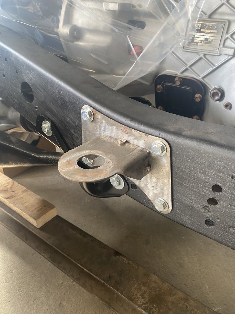

Finally got around to mocking up front cab mounts I had waterjetted
That looks real nice.
Thanks - Still have my 3D models if anybody needs some. Will probably make a slight revision and lengthen the gusset and add a collar around the radius if so. Can fab them or send the unbent pieces of watterjetted sheet metal
View attachment 105936finally got around to mocking up front cab mounts I had waterjetted
Question, never a criticism, how is the eye attached to the flange? Are those rivets? They look a little light, and the bolts look like they might be a little light. But that assumes somebody with my fat ass would be driving a thing…
Just mocked up w magnets. Still have to weld them together. Metric class 10.9 bolts - 1/2 diameter

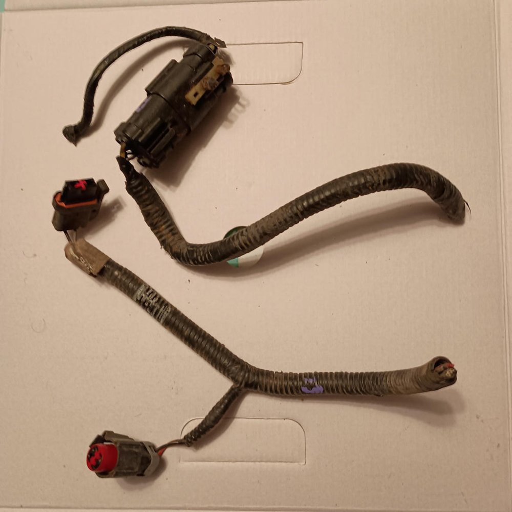

The main thing I was after was the C184 connector in the engine bay to modify a start/charge harness. Explorer has a same style connector for that location, unfortunately the genders are reversed and the harness is shorter. Female connector on Explorer start/charge harness, and Female connector on Ranger body harness, and about 8" between where they are located in the engine bay. (Ok maybe 6, but we all exaggerate a little right?) Same sex relationships may be accepted and common now, but that doesn't mean that the same flies in electrical. Either the Explorer harness needs to transition and add a few wires, or I need to make a therapist adapter harness to help the two work together. I'm going for the latter, but more on that will come in a potential build thread or seek out lil_Blue_Ford's build thread and youtube videos. @lil
Fortunately all potential donor candidates for the connector had unmolested harness in the engine bay. Unfortunately the way that they had them sitting I needed a stool to reach the connector and there weren't any available. After striking out on a connector I could reach I finally found one thatr had been in a front end colission, the fender was peeled back and the connector I was after had dropped down into the wheel wheel. Got the compressor and pressure switch ends too just in case.
