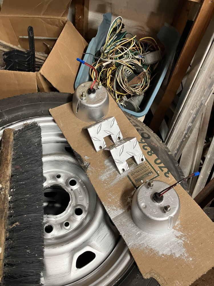

My F250, Big Red, has brake lights up high on the back of the cab as part of the ladder rack, and I wanted high brake lights for the 87 too. I wire them without making the running lights hot, so when you step on the brakes or turn on the signal, it’s the first time they appear. I’ve been hit from the rear really hard twice, and I’m paranoid about it
I don’t know why I didn’t do it when I made the light rack out of the same scrap toolbox (one side’s cover). I have all kinds of LEDs and such, but they just didn’t blend in right with The Missing Linc. So when I was fooling around, figuring out the turn signals, I went into the shed of miracles and found a few of the really old fashioned 3 inch trailer tail lights. I made a couple of mounts out of the same scrap toolbox. They came out great, but I’ll mount and wire them in another day.
Edit: I forgot the picture. Yes, that’s a Rustoleum.

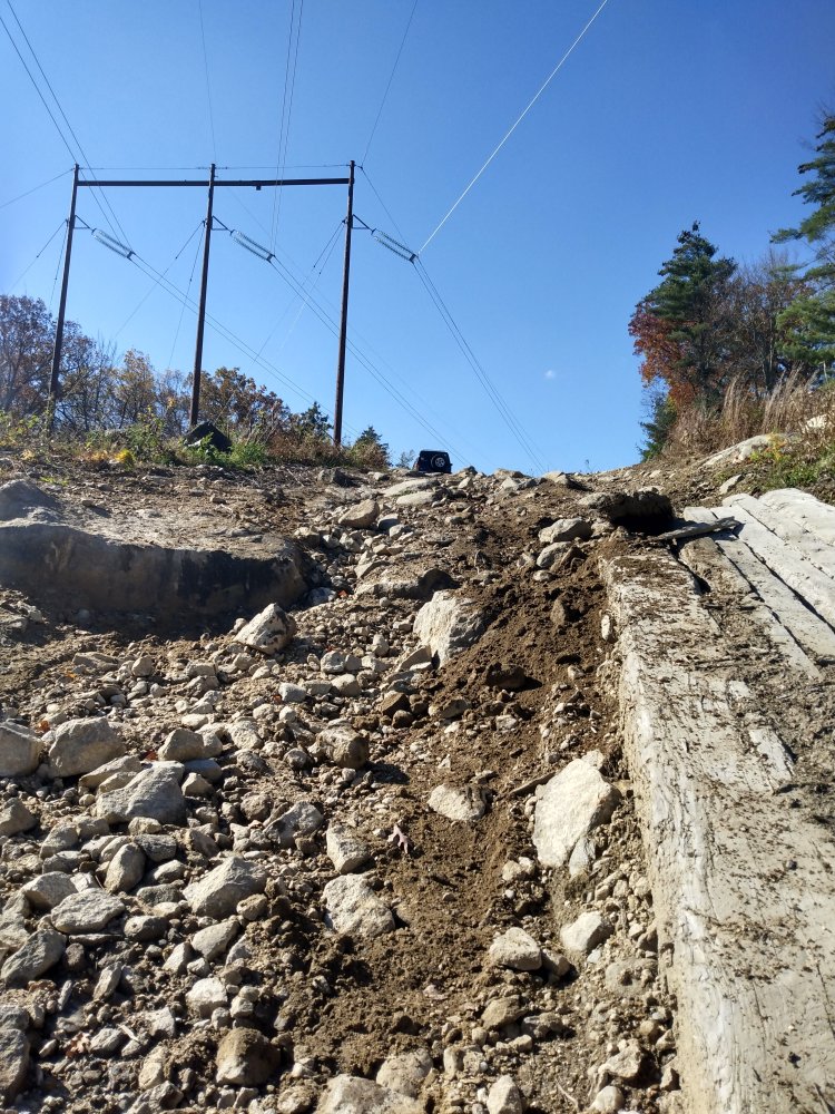

Had a great Saturday! Years of work paid off and landed me with a very capable vehicle.
The locker makes great traction. It will be a bit of learning to drive smoothly on asphalt with manual.
The 4.10s add a lot of low speed control too and let me get into some real situations.
Nothing broke and I was not being gentle. I have some small fiddly things left but this was a total win!

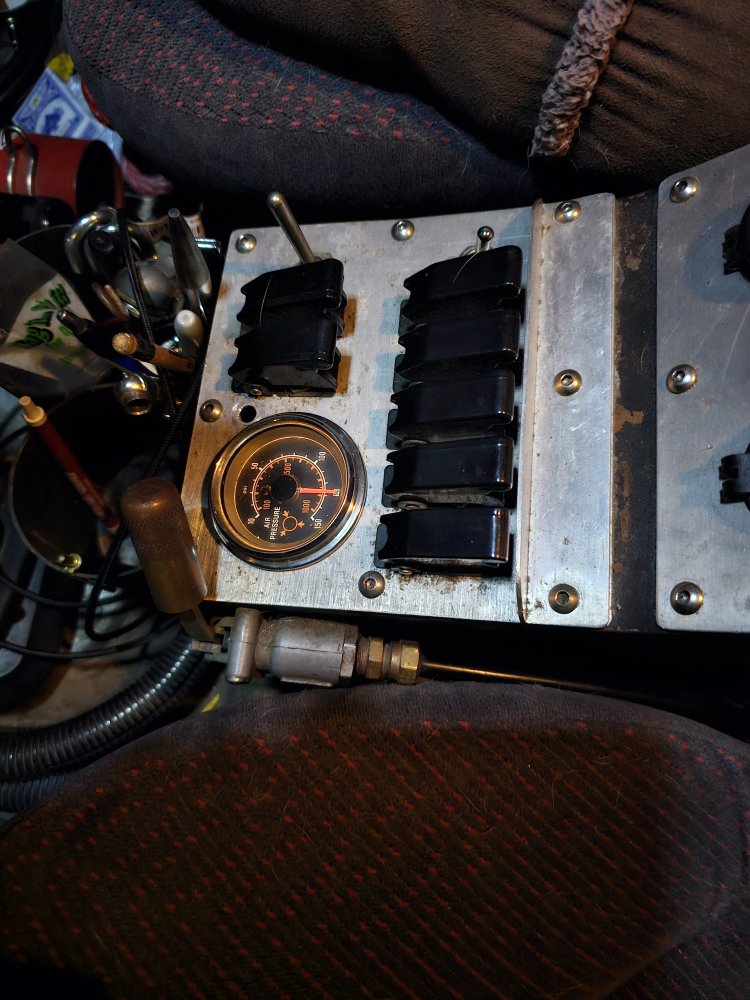

Swapped my air gauge to a larger illuminated gauge this afternoon, now I can see the air pressure at night and I was able to find a new old stock stewart warner gauge for less than a new imported one so that's a plus also.

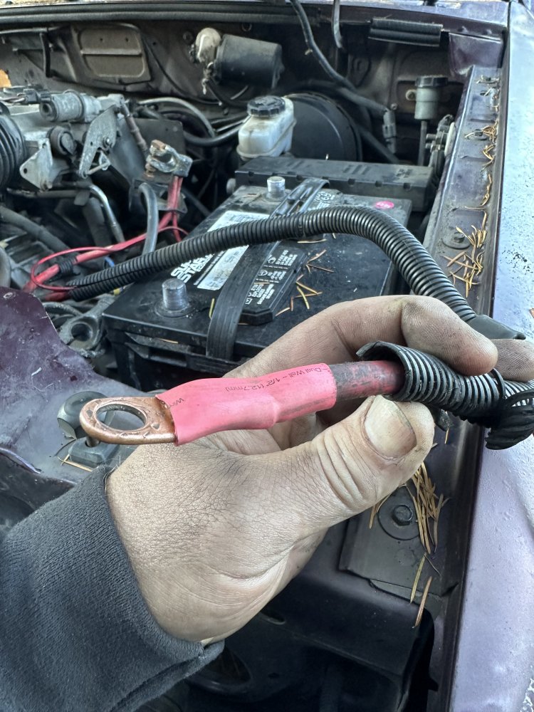

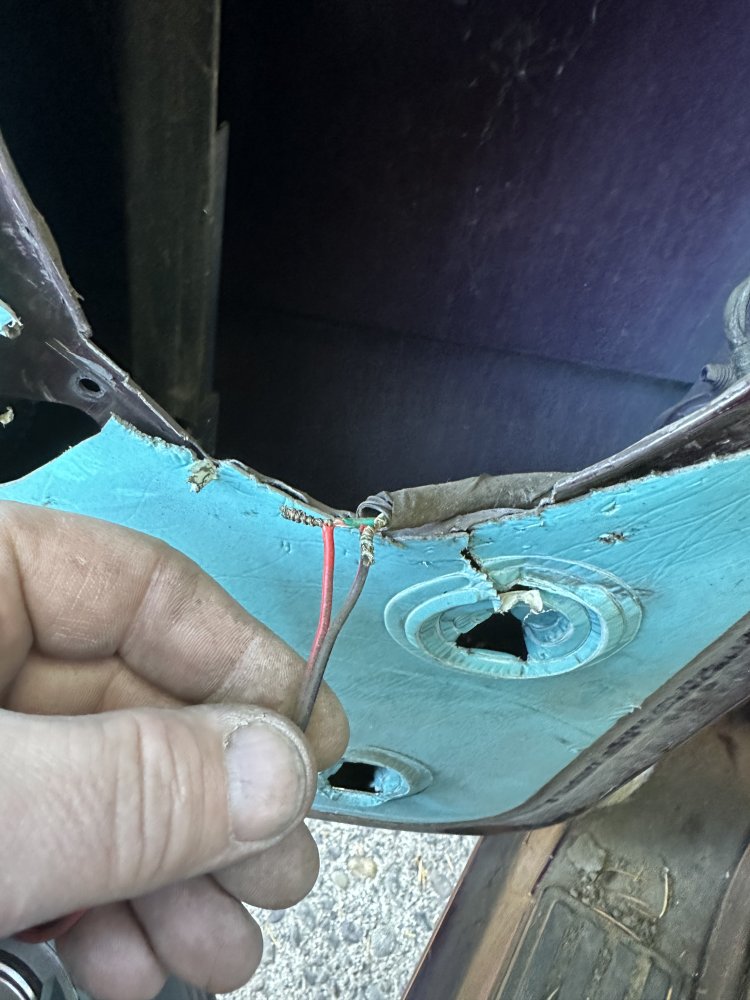

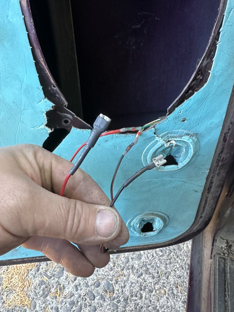

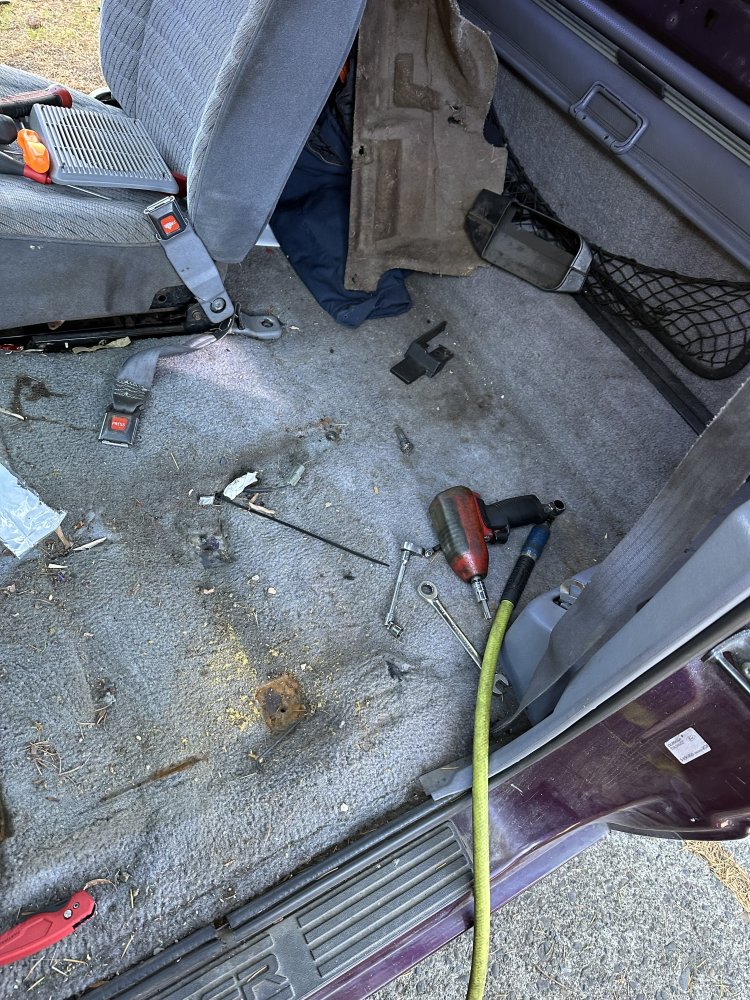

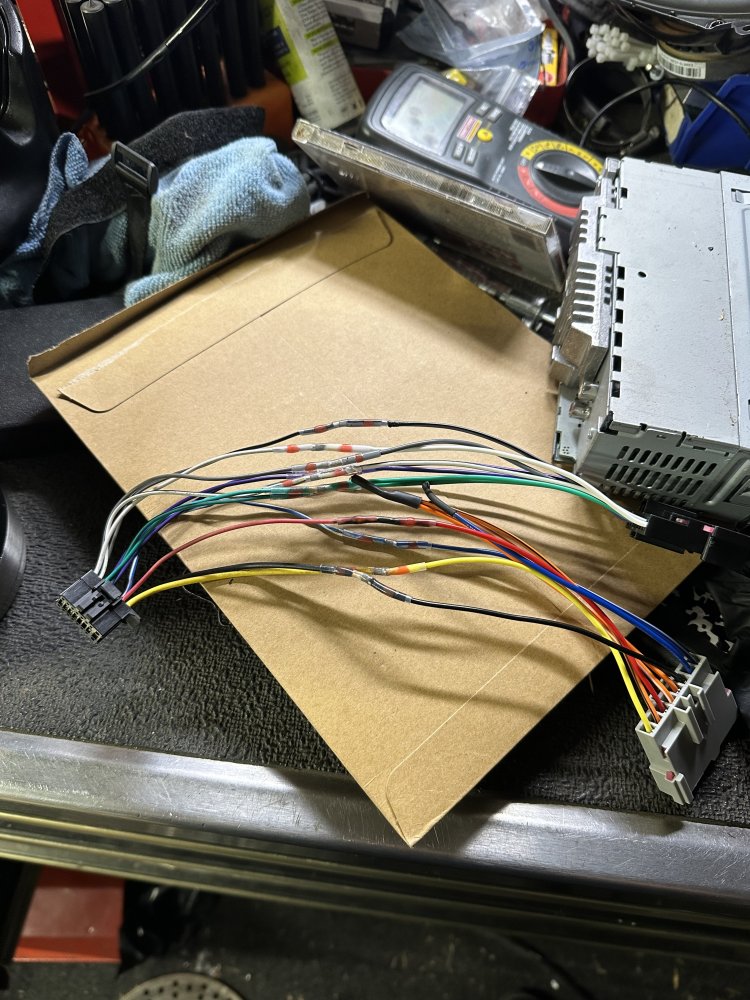

Wired in a stereo and removed a bunch of really crappy wiring.

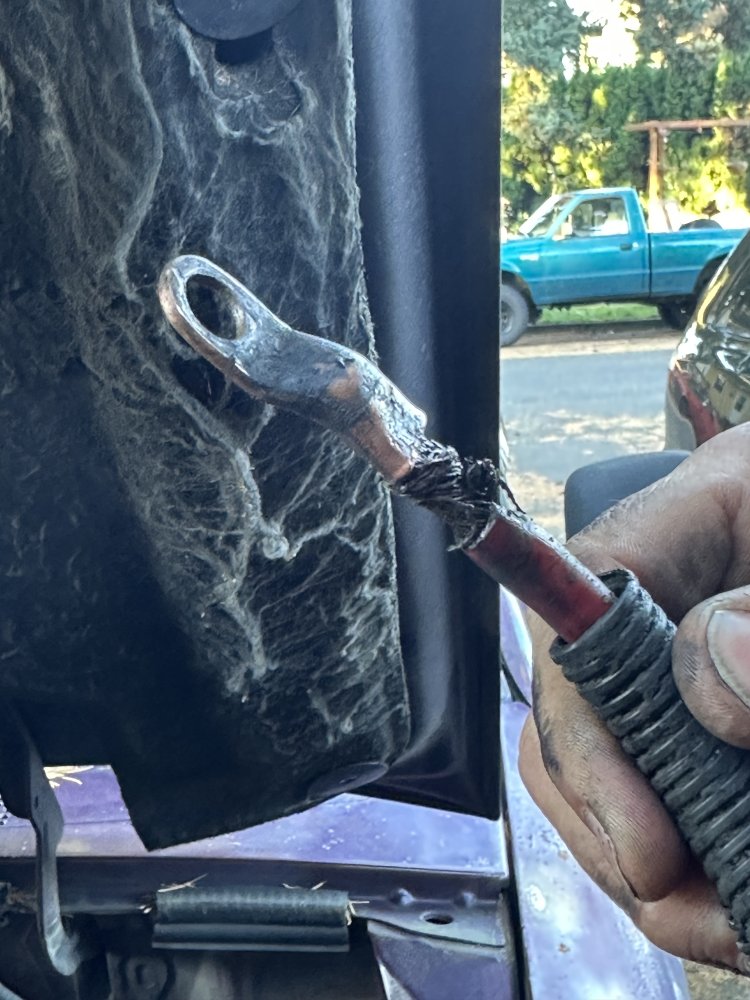

The starter wire was literally hanging on by a thread. I keep finding bare wires just twisted together without even any electrical tape. I’ve been soldering and heat shrinking everything I come across.

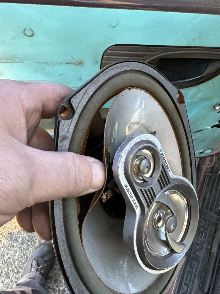

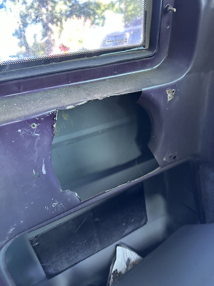

Somebody decided thatthey really wanted 6x9’s and hacked the $h!t out of the doors and rear inner quarters.
Oh well, it’s just gonna be a camping/fishing rig anyway.

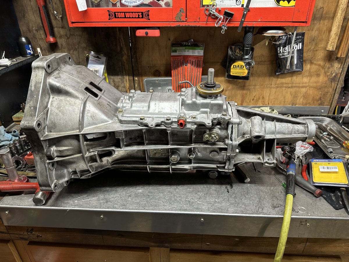

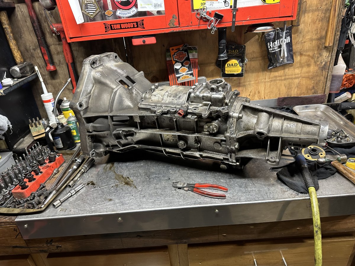

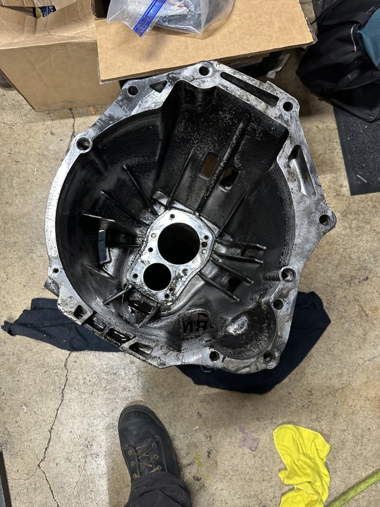

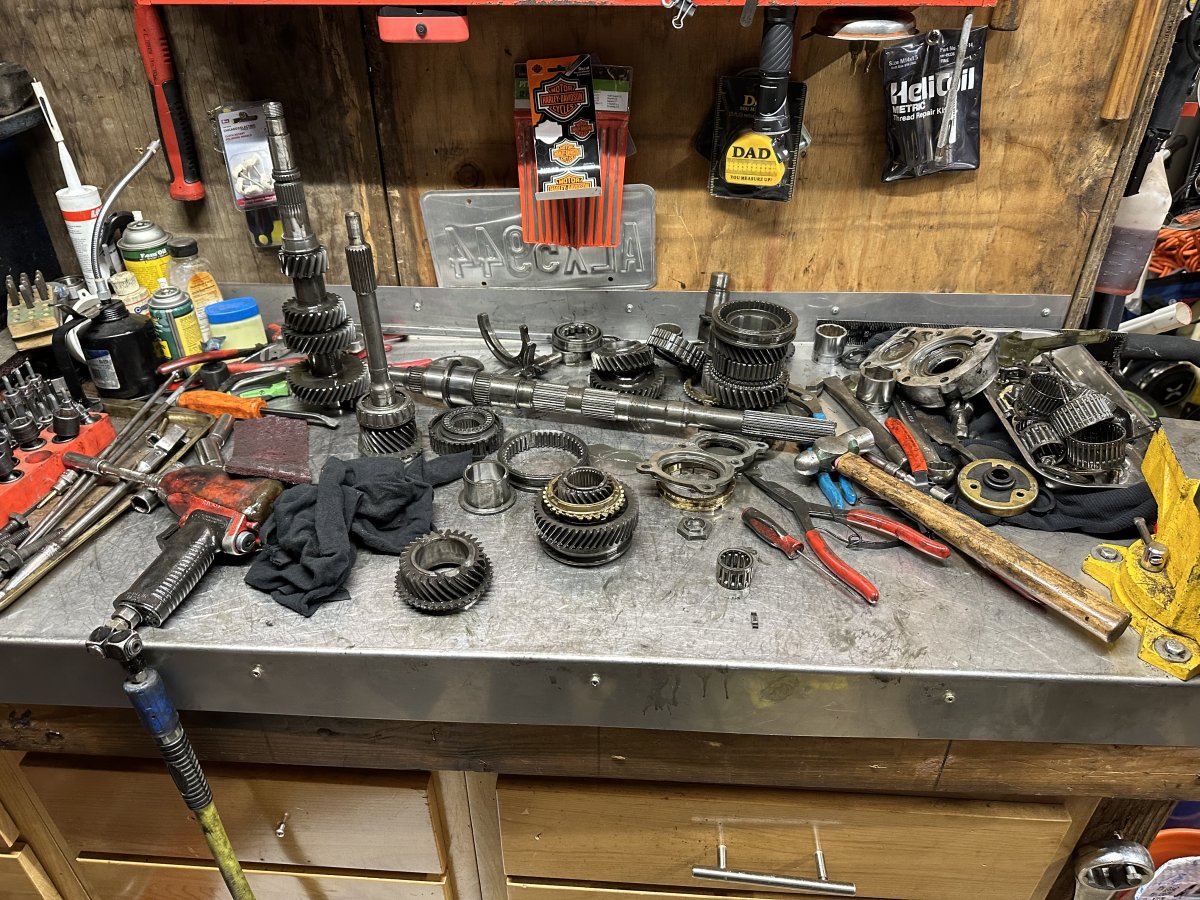

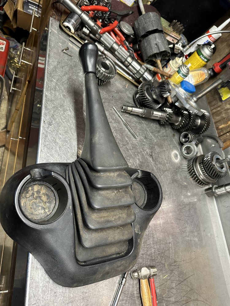

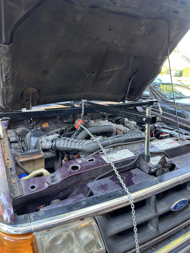

I finished the oil pan gasket and rear main seal on Friday and the clutch and transmission rebuild on Saturday.
I was able to use a chain hoist and transverse engine bar to sneak the oil pan out. Drove it today for @100 miles and no more leaks. Shifts like a dream.
