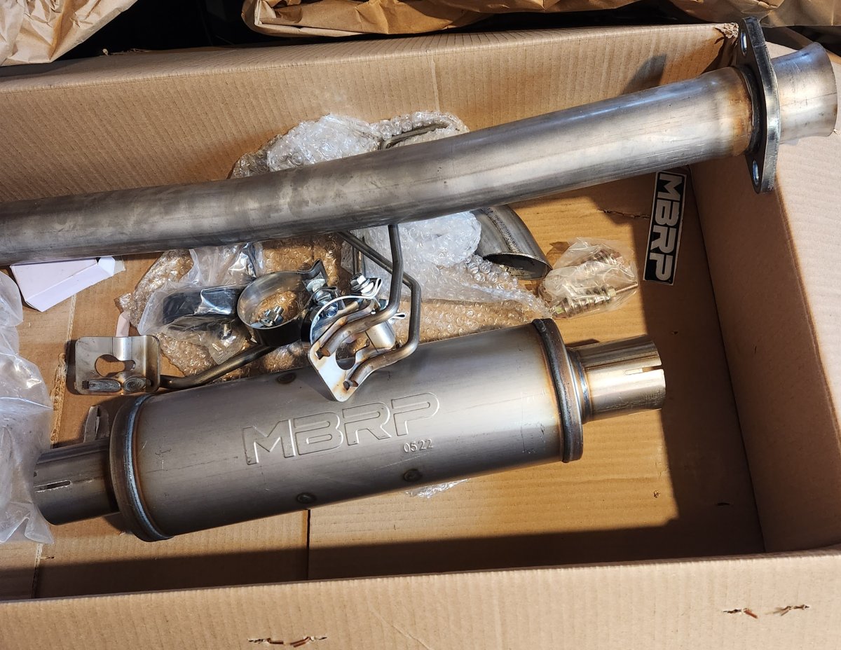

This came yesterday... just opened the box and it started to rain. Maybe later today or tomorrow.

Straight through muffler? How long is the body? That's pretty much what I bought for my truck, I think the body on mine might be a couple inches shorter though.. Definitely shorter than I thought it would be when I opened the box šŸ˜‘ hoping it's not too loud coupled with the little high flow cat.

Yeah... straight through. Fifteen inches long. The reviews said it had a good note and no drone. I also went with a turn down dump opposed to a full exhaust. However... the full exhaust parts will fit if I decide to add that sometime in the future. I really wanted a Gibson SS system... but this 409 SS system was $500 less. It's also made in Canada. I'm gonna take the chance... I also hope it isn't obnoxious.

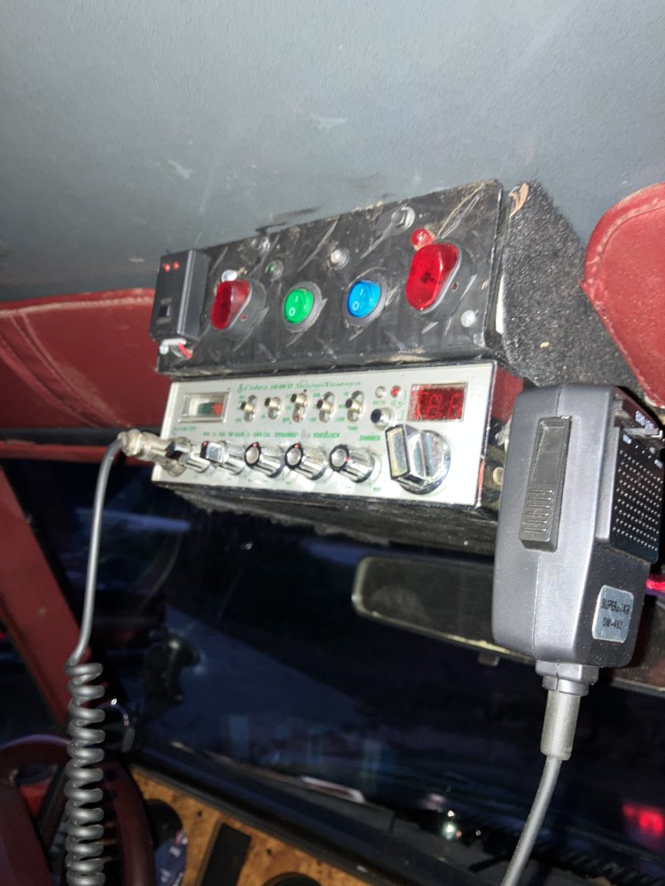

I am making a little console/CB mount, about the size of my CB radio, to mount between the visors. The face of the little console will have the switches for all my lights and beacon and whatever. I’ve done this before using aluminum diamond plate. The 1/8 inch diamond plate is very easy to work with, but when you drill it for the switches, the ā€œdiamondsā€ can make it hard for the switches to lay flat.
Short while ago I bought Sweet Pea a new gas grill, and I had to scrap the old one. It was one of the stainless steel ones with the cabinet underneath. Before I dumped it, I took off the stainless steel doors and the stainless lid for the shed of miracles.
My brainstorm is to use a piece of that stainless to fold up my little console.
i’m wondering if anybody has used that sheet metal from a gas grille before, and what the issues with it might be before I waste a lot of time.
Here’s the console in The Missing Linc. Purely functional, low on pretty. I’d like the one in The Road Ranger to look a little more professional.

The sheet metal from a side shelf should be easy enough to work with. Just standard grade steel. From the main body of a steel grill, your guess is as good as mine. It depends on the piece and what the heat did to the steel.
Stainless steel is rough to work with. I hate it. Use good cutting oil on drills and saw blades. Don’t run the speed up too high. You’ll burn up blades and drills quickly if you’re not careful.

Don't forget it'll poison you. You need a respirator to weld it. Lot more work to properly weld, and when your done you need to passivate it or it will loose it's stainless properties. Same thing can happen some times when bending it.
Can't cut it with a torch, need abrasives or plasma.
Not as strong as steel.
Trash.

I planned on cutting it with a cut off wheel, and there won’t be any welding. I have one of those little harbor freight metal benders, but I think my template may be too wide. In the past, I have clamped a piece of sheet metal to the edge of my work table, sandwiched between two pieces of steel, clamping it very tight. Then I slowly work it with a rubber mallet. It works like a charm with the aluminum diamond plate, and I’ve done it on some thin steel sheet before, but that was ages ago, and I can’t remember how they came out.
