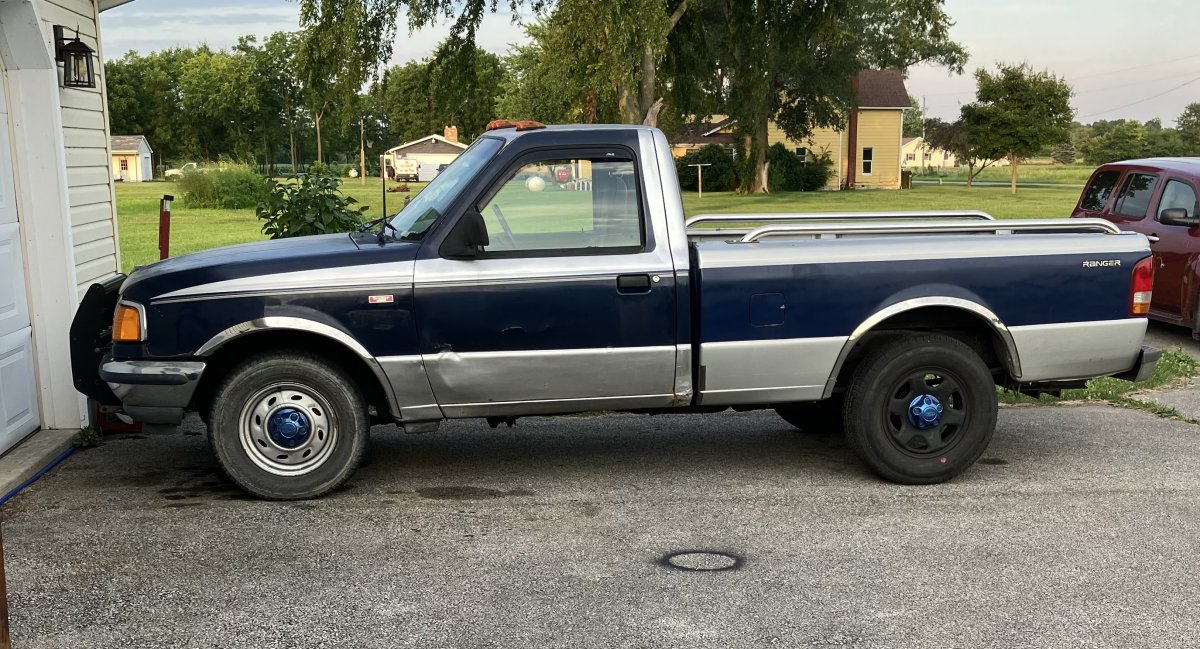

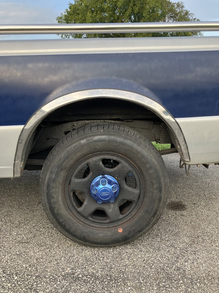

I put escape rims on the butt today, both spares for the escape dont want to hold air so I broke the beads, cleaned the rim & tire surface and then put some oil on the bead surface of the rim before reinflating. Figured Id drive it a couple of days on the ranger and see if they stay up. Doesnt look horrible, I used 2” spacers to correct for the positive offset of the escape rims. Put them about where they should be. Tire size is 235/70/16” so not much bigger than when I run the 235/75/15’s. Put my gps in so I can see how accurate (or not) the speedometer is. Wouldnt want to tow or haul with this setup but it should be ok to get to work and back.
Those 9” drums sure look tiny inside of a 16” rim!

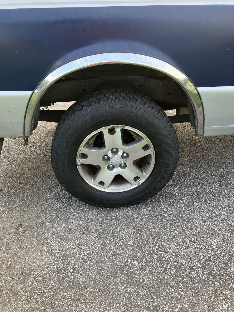

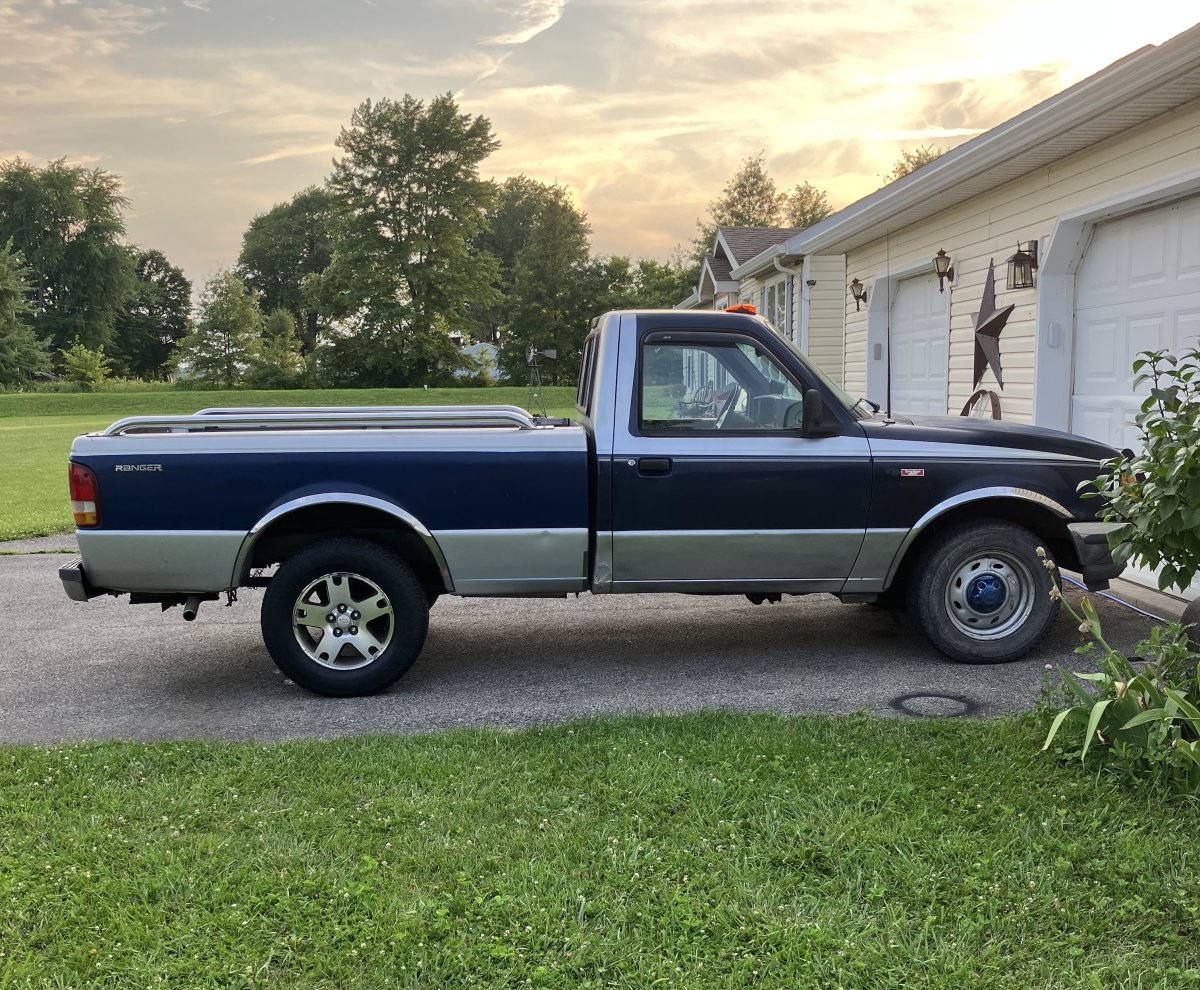

Early this week, my neighborhood tire shop got in two Hankook 225/70R14 tires to replace a pair that some mischievous kids had slashed with a knife. I had been driving on two mis-matched spares since that incident. The new tires cost me $270, including spin balancing and installation. Not a bad deal for a size tire that has a reputation for being hard to find.
The installation problem began when they tried to install the second tire on the right front. The mechanic said, NO WAY, and showed me the five lug nut holes had been stretched into an oval shape. I am not sure how this could have happened, but I bought a deer-hoof rim from a local junkyard later in the week, and the second new tire was installed today.
And this is where the fun began.
There were no holes to mount the center caps with the three screws like the other three rims! WHAT THE HECK?
After doing some research on the Forum, I found out that Ford changed the design in 1995 so that the three mounting screws wouldn't be required. Not a bad idea, as it would make changing the tire on a dark raining night much easier.
But now I have a shiny new-looking rim that requires a much different (and pricier) center cap!
Cosmetic issues aside, should I drill three holes in the newish wheel so that I can attach the older-styled center cap? Or buy a set of the newer styled caps (1996 and later) that would cost me about $120?
Not a serious dilemma, but just frustrating....

Drill the holes. The right size plastic wall anchor works. I’ve done it before. When you put the plastic anchors in, dip them in clear silicone, and Mount the cap the next day.
Do I have to say be precise so the center cap doesn’t wobble? When I did it, I made a paper template. I did a pencil rubbing of an original and then transferred the spots.
Hope it helps!

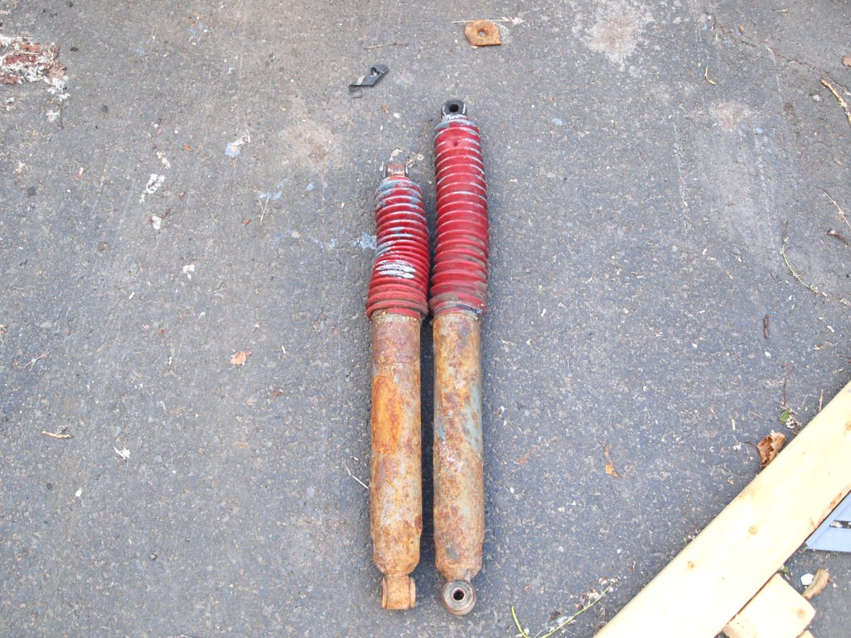

Well, passenger side of the front axle of the Choptop is apart, had to torch the lower BJ, the nut was a rust blob that I couldn’t get a socket to bite on. Can’t be tight if it’s a liquid. Melted the blob, knocked it free with a chisel and knocked the knuckle down while everything was hot. Also broke a punch and bent another trying to get the remains of a cotter pin out of the tie rod end. Gotta look for some better punches. Hopefully tomorrow I can get it back together.
View attachment 95129 These are 5 year old Rancho. Not impressed with the life span
The Rancho shocks I put on the front of the 09 were junk right out of the box. There is a bridge on the freeway I drive over on the way to work every morning, and the front end bounces 3 times before the shocks finally settle it down...
My Ranchos have been fine but it has only been a little over 3 years since I installed them.
