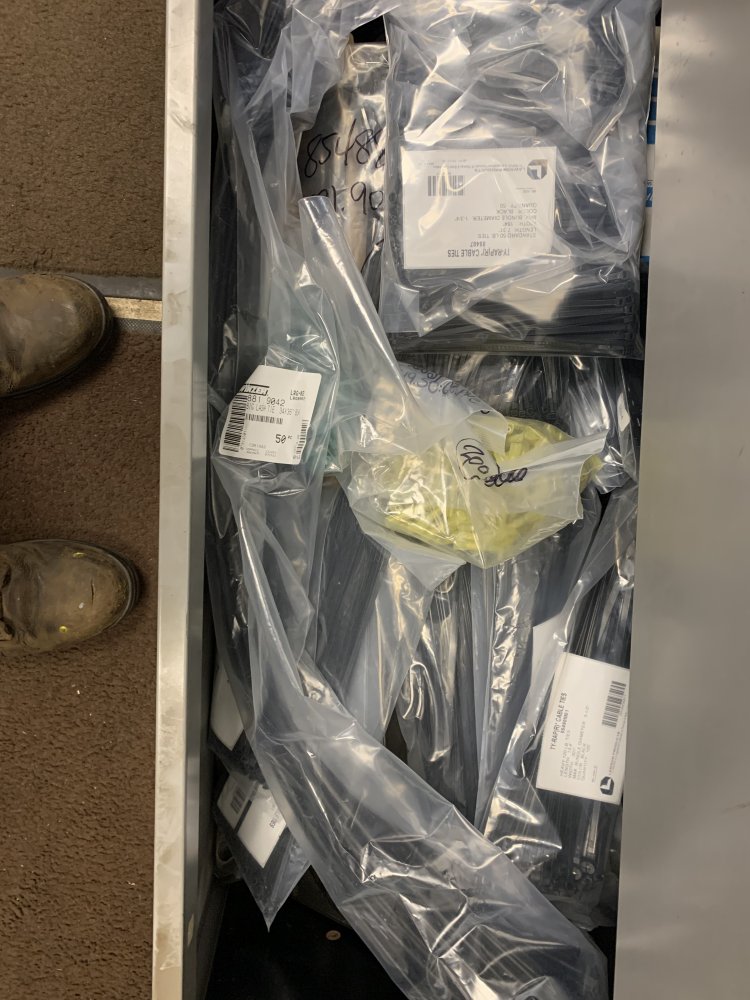

I’ve got a drawer full of spare zip ties and heat shrink but connectors… Ill bring you a few extra. You want the 36” ones?
Those might work. I think mine were about 18 inches. Trailer frame is 2“ x 3“ square stock, and the axle dolly is 2“ x 4“ square stock. I finally got the axel underneath it last night, and I lined it up with the truck. My vision was to have the trailer deck match the deck of the truck. I’d have to put a 7 1/2 inch tall spacer between the trailer axle dolly and the trailer frame. That would take a ton of work so the spacers wouldn’t fold over in a turn. I’ve been rethinking that, the deck just may have to be lower. Although I’ve thought out my visions, in great detail, a lot of the final details are decided when I slap the stuff together with watch laying around.

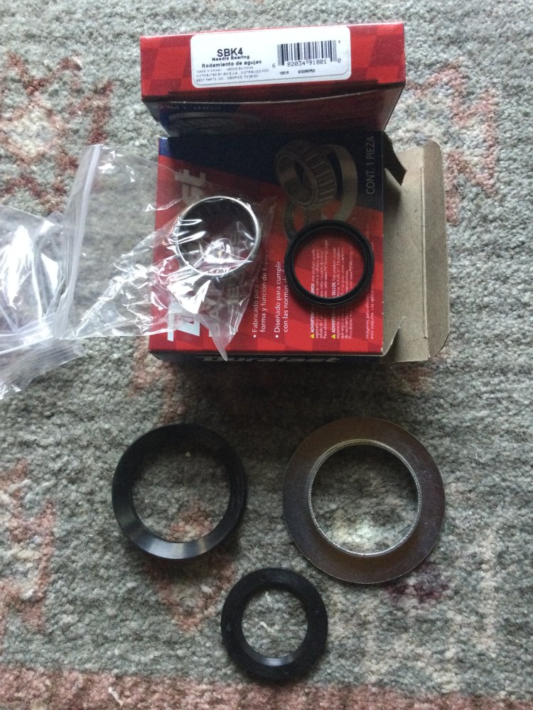

Yesterday I tinkered with the choptop a little. The seal on the axle shaft crumbled, so I tried getting new ones and what I ended up with was a set that I’m not exactly sure how all the parts go. It was pretty cheap and includes a new bearing and seal for the spindle. I’m just not entirely sure how the other parts go because they’re different from the old seal. Once I figure that out, I can put things together for the choptop today.
Well, the seals in my last post showed up this morning and a quick search online netted me no instructions and one person posted on another forum with no replies asking about it. So I went out and got to work anyway. First up was knocking apart the drivers side shaft since I figured I’d grease the bearings while I had it out. Knocked it apart, did some cleaning, knocked the old seal off and figured out how to put the new one together, did a few other things, got pulled away from my project a few times, and when I finally got around to giving the U-joint attention I didn’t like how it looked. It would make a decent spare. So I scraped the bottom of the barrel a bit and called for new joints. Just don’t need any more headaches from this any time soon.
So now the drivers side is finally ready to go back together. I’m not re-packing the wheel bearings, the grease really isn’t bad, I’ll just pull out what I can and put a little fresh stuff in. Hopefully tomorrow I can get the drivers side together and since I know what’s going on and have everything now, hopefully I can blast through the passenger side. I already got the inner shaft set for that side prepped in and among things today.
