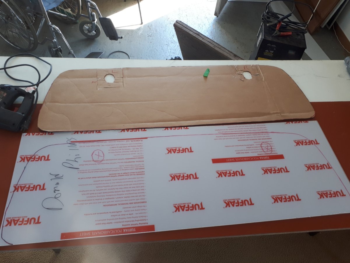

Refined my rear window pattern a little more and traced it on the Lexan. Next comes the scary part - not screwing it up while cutting.

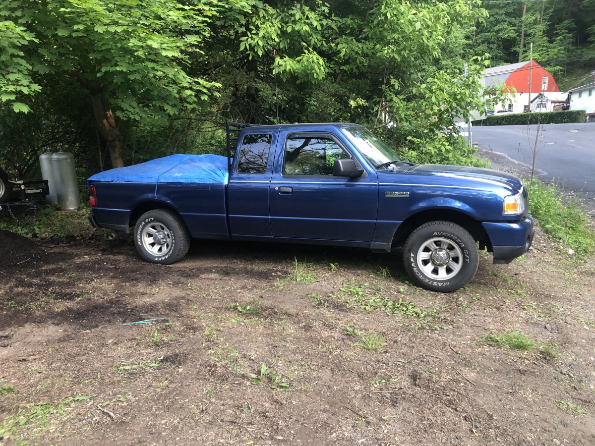

Fill up the bed with mushroom soil to take over the in-laws tomorrow. About one yard, so about 1000lbs.
If you're cutting g it with a handheld jigsaw, attach some felt, or at least a layer of masking tape to the bottom of the saw so it can't scratch.
I find a layer of duct tape works pretty well, as it sticks well to the saw but is slippery on the other side so it doesn't stick like masking tape can, and doesn't fill up with sawdust like the felt can, because the sawdust can still scratch stuff.
Cut it wide, then sand it back.
& use 24 metal blade, take your time…
I use my benchtop bandsaw for plexi, works GREAT, combine that with a benchtop belt/disc sander and you have a winning combo... neither works good on steel (disc sander does a number, too underpowered for shaping steel on the belt sander) but aluminum, wood and plexi they are magical...
I like to put the masking tape on the Lexan itself, that way, as you get crumbs built up under the bottom the jig saw or table of the band saw, the crumbs don't scratch the plexi.
