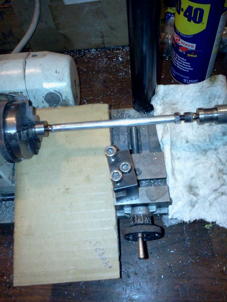

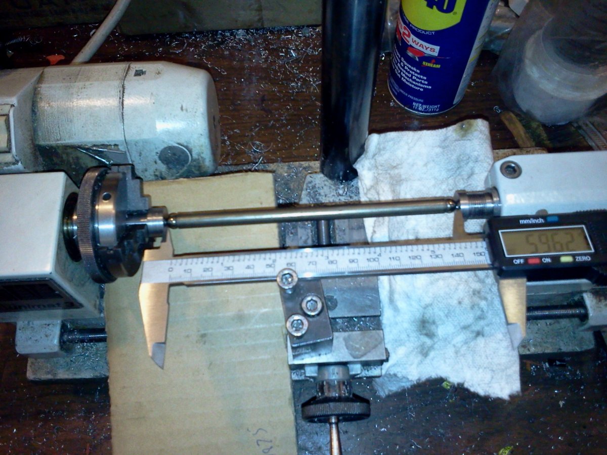

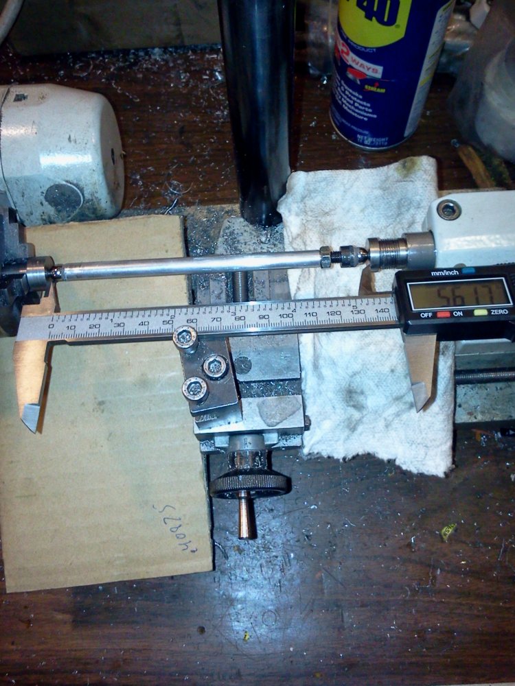

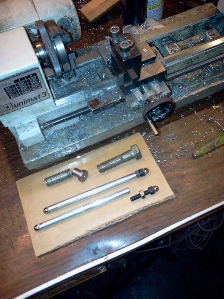

raining today so off to the basement for some tool making.
first was to take a perfectly good used bolt and turn it (joke ha ha) into something smaller, rinse and repeat because I needed 2 of those gizmos.
46019
did I mention last weeks project was custom fabricated push rod length testers?
I should have, made 12 of 'em.
the aluminum tubes are scrap left over from work years ago, cut down and threaded on one end.
the balls were extracted from some bearings from the same "old work scrap" stash.
had to break down and buy the nuts & socket screws, bummer.
why did I need those, those,,, things?
so I could accurately measure the pushrod length of course., I do need to drill .140" holes in the big ends to seat the balls.
need a 3.5mm drill bit, I'm afraid 9/64" will make too big of a hole.
46020
46021
for reference this is a '99 3.0 pushrod, they are quite short.
46022
Comp Cams website says use .140" holes in the test gauge. the ball's oil holes and chamfer fit in the .140" holes. then measure between the thingies I made.

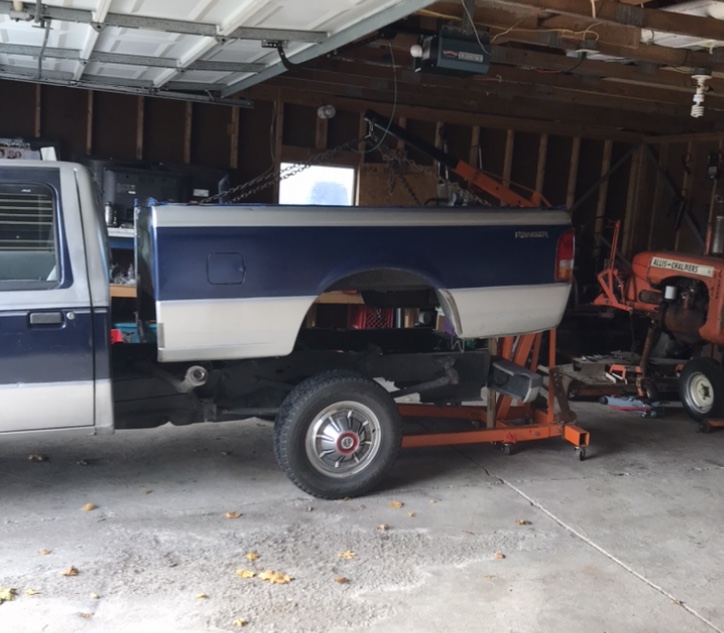

well this past weekend I removed all of the bed bolts, three screws for the filler neck, and unhooked the lights. I am now waiting the availability of a second person to lift the bed off, where I will replace the rear shocks and the fuel filler neck (for the second time) and do some rust abatement on the frame and cross members.
I even unhooked the bottom of the shocks. the top bolts are a bit of a pain to get to from underneath, so I will address them from above once the bed is off.
Also ordered a brand new set of bed bolts... took me forever to remove the middle bolts. needed a cheater bar (had a nice 4 ft section of black pipe) and they fought me every damn turn. could not even use a ratchet on them until they had been mostly turned out with the breaker bar/ cheater. the other four weren't too bad. But damn those things must be made out of unicorn horns or something... 54 bucks for a complete set...

No tree in my yard big enough, and the garage won't work, too much crap in it and only a 8.5 ft ceiling. I have thought of buying a harbor freight engine hoist tho....
AJ
I used a engine hoist to pull my bed last year, just raised it up enough to roll the truck out from under it. the factory tie down loops in each corner of the bed ( bed is a 97 ) were what I used to lift from, used 5/16 chain.
