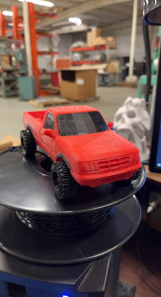

also 3D printed myself another ranger.

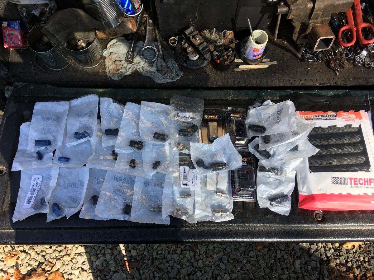

And my Summit Racing order, which should give me plenty of bits and pieces for the rest of the plumbing on the Ranger and some protective sleeves for the plug wires

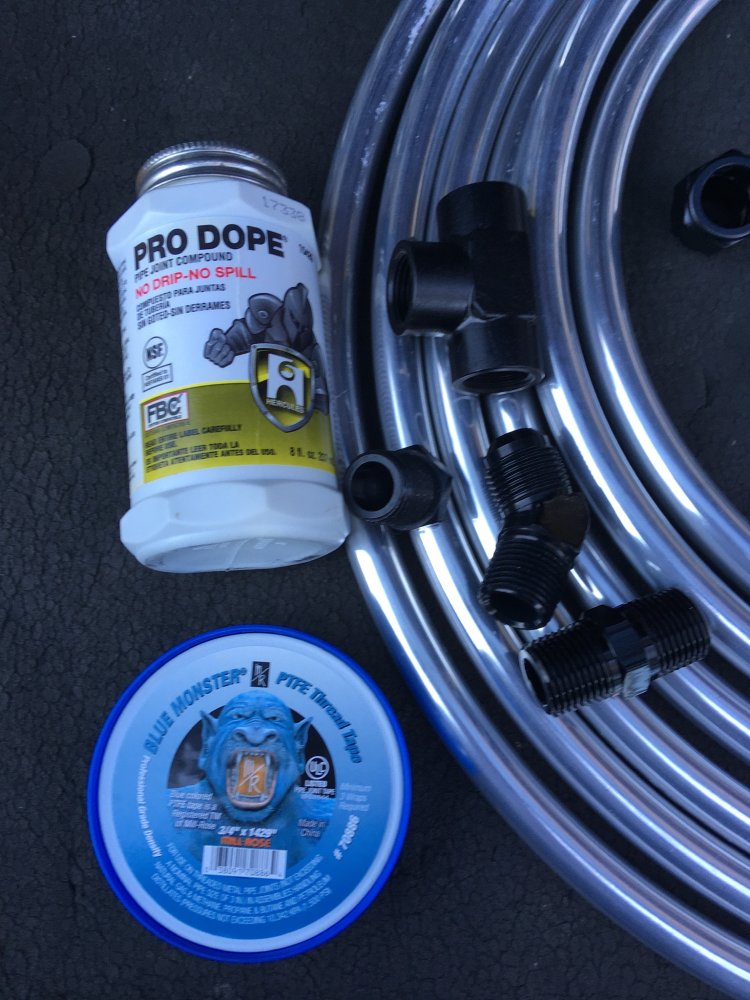

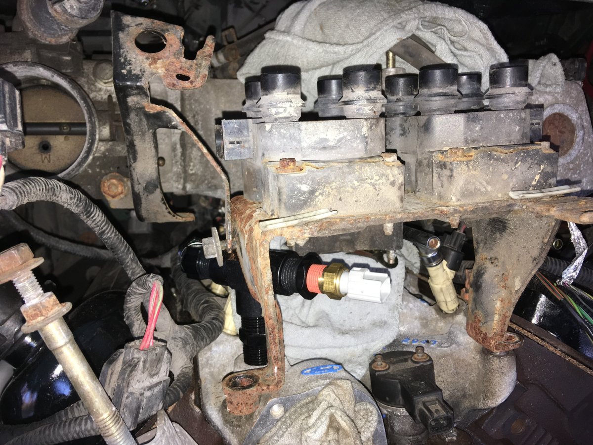

lightly finger tight mocked up my planned routing
Not sure if I should use Teflon tape, PTFE tape, or Pro Dope on the pipe fittings. Anyone have recommendations?
Teflon is just a brand name for PTFE.
The only difference better white and the blue pipe tape should be the thickness. Blue stuff should be ticket to help with the larger clearance on stainless threads.

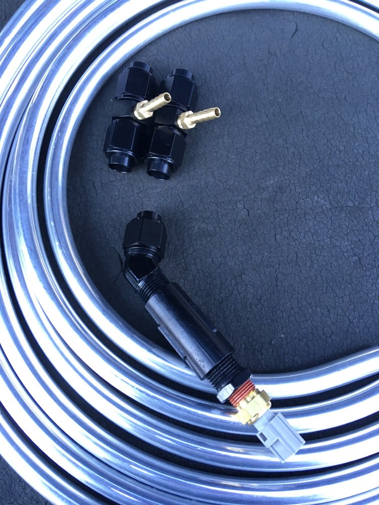

No stainless, everything is aluminum. The fittings are black anodized and the hard line I’m using is 5/8” aluminum. 5/8” rubber hose for the heater core and water pump connections. Got a fitting for each hard line with a brass hose barb to hook up the intake
AN fittings should not need tape or dope. They seal by matingbthat special bevel on the end. But any regular npt threads should probably have some dope applied.
Id go with the pipe dope, Ive had issues the past few times with tape, even the thick yellow stuff meant for a propane/nat gas line. Had quite a time getting my ventless heater line to be sealed. 1/2 psi is harder to be “sealed” than 80 psi air compressor fittings.
Yeah, not trying to tape or dope anything but the NPT threads, which is the nipple from the intake, the Tee, the 45* on the NPT side, the reducer bushing, and the hose barbs
I think tape vs dope is just preference. Technically you shouldn’t need anything to seal, it’s just there to help lubricate the threads and make it easy to tighten.
The tape does help to seal to some extent, especially on the harder metals.
