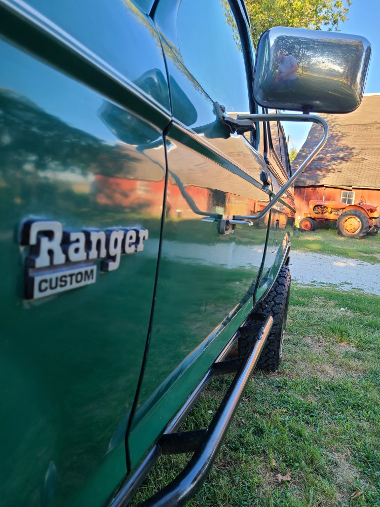

Getting to be that time of year again... getting spiffyed up for the car show.
