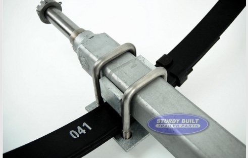

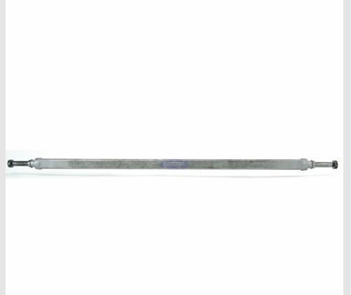

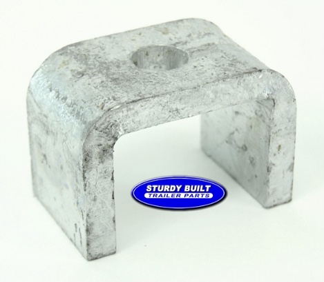

Got the idler axle for the ranger trailer, realized I didnt think about mounting hardware. Thought about trying to use the u-bolts & plates that held the original axle in but decided to order the right stuff instead, going to make it a “spring under” setup so it sits a little lower for loading. So far I have the 2x2 2200 rated 59” galvanized axle , two galvanized hubs , bearing buddies & the bearing kits. Didn’t really need for the axle to be galvanized but getting the size I needed (59” wheel flange to wheel flange) was only available in galvanized. The spring seats slide over the axle and are clamped with the mounting u-bolts. For what I use it for 2200# will be plenty. The most difficult thing was finding axle plates since a ranger rear spring is 3” wide and apparently most trailer springs are 2” wide.

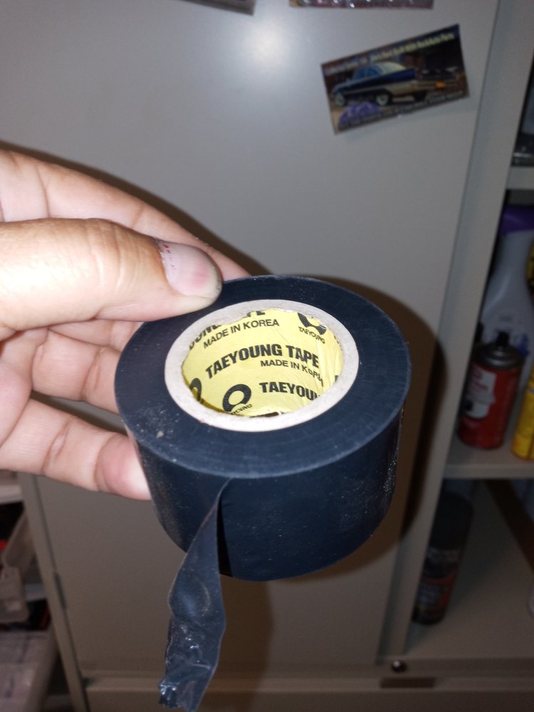

I tried to find my order from Amazon, but couldn't. A year or so ago I ordered some 1" black vinyl. I think it's 300' long, no sticky side. I use it to re-wrap harness' in my Nissan. the more you stretch it, the tighter it holds. Use a small piece of electrical tape at the end to hold it down. very simple and mess free.

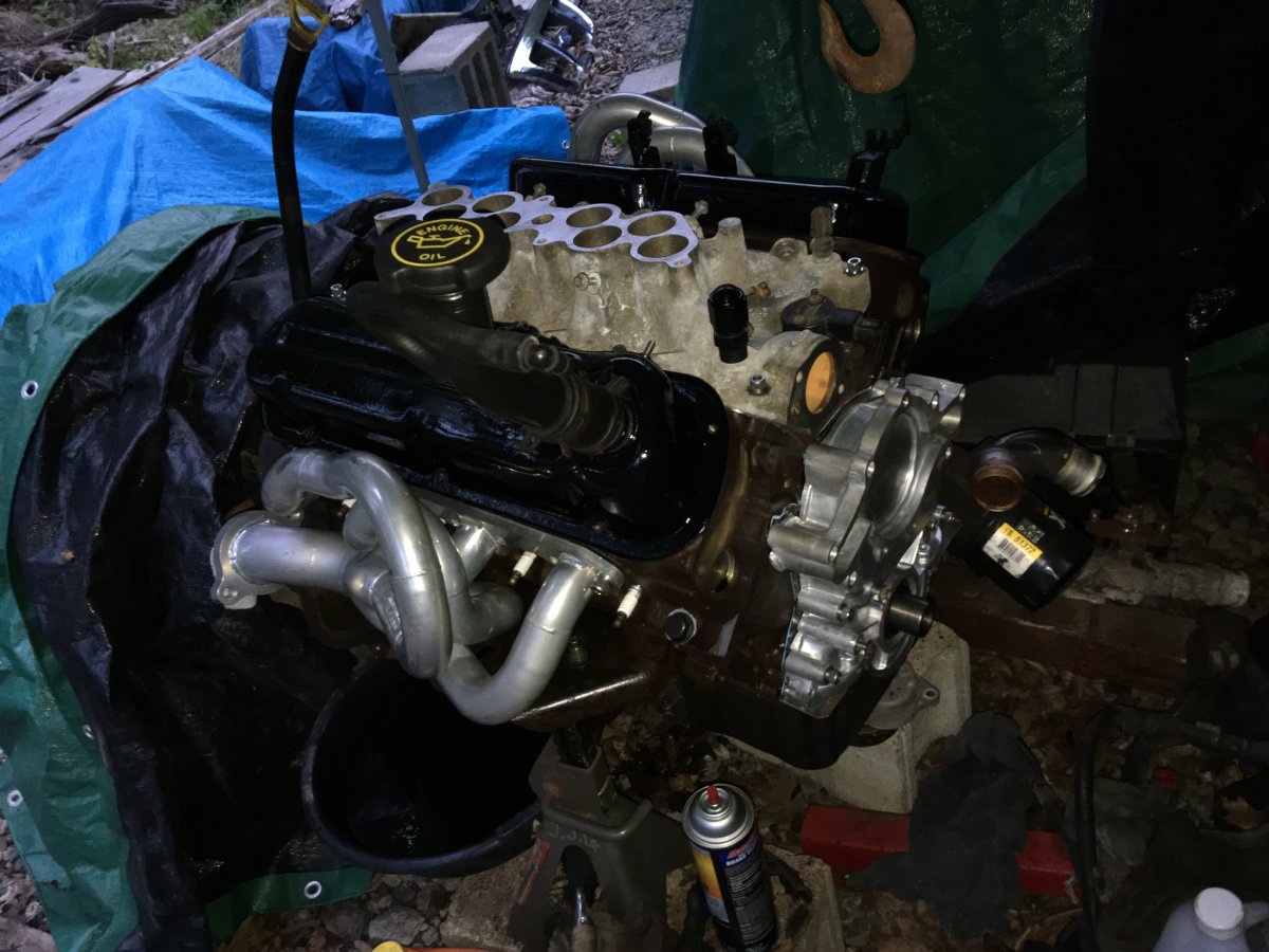

So yesterday I worked on the green Ranger some, got the lower intake on, got the rust knocked down on the valve covers and squirted some paint on them, got the timing chain on, got the rocker arms torqued down, and against my better judgement, put the timing chain cover on. I should have left that for another day. Lucky I haven’t broke it yet. Gasket between it and the block somehow got a little shifted and apparently I was a little heavy handed with the RTV so it didn’t want to fit quite right and I was hammering on it and forcing it to position. Not sure if I should call it ok or try to take it back off and get new gaskets. It’s not off by a lot, but I’m gonna have to probably trim the gasket where it’s in the water passages by a little. I used gasket shellac and was rushing it so it’s kinda glued on now, lol

Not friction tape, just vinyl. NO ADHESIVE. I have used friction tape, and I guess I did describe it, but without the sticky stuff. The stuff I'm talking about is just like electrical tape, without the adhesive, maybe a few mils thinner.

That's the stuff I'm looking for. I saw some "made in China" tape without adhesive, but with a max 143° temperature rating, which means it's junk. It will work, but with a short lifetime. I've seen it in the 3M brand, but I can't find it on their website because they have 10 million types of tape and no real good way to filter search results. It is How is the tape from Amazon holding up? Also, that cloth electrical tape with adhesive is better for holding down the ends, and it is what Ford uses in some applications. I've also used zip ties to prevent the ends from coming apart.

Snapped this at lunch. Hope it helps. You can see the name brand inside the roll, not sure of the temp rating. I just used it this week, so still waiting on results. It's pretty wide. so easy to double up as you go, overlapping about half width.
