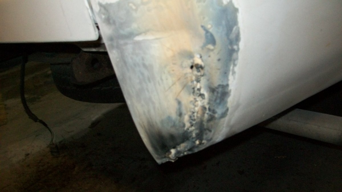

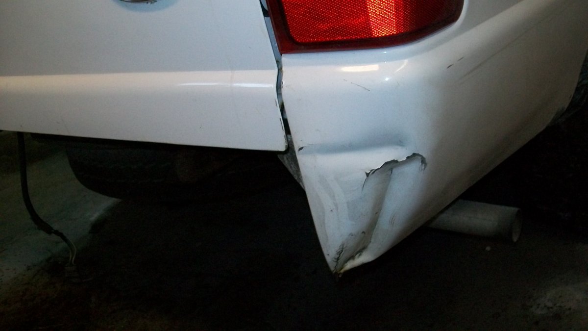

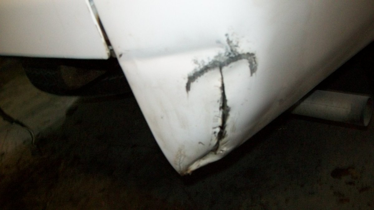

I removed the back bumper.... and found this... no way this was the original back bumper because with this much damage, the bumper would have shown some pretty good damage and there isn't any.... The crease on the dent was more than I wanted and Ranger's have sealed panels so you could not pound this out from the back side..... and since this area is hidden once the bumper is put back, it didn't have to be an exceptional fix..... I tried dent pulling on the crease for about two minutes... and then got out the 4.5 inch cut off wheel and made a slit down the crease.... used my mini pry bar to pull the two sides back out to where they were "close" to where they should be... got a piece of metal from the old fender that was removed, folded it in half lengthwise and tapped it in the seam... welded like crazy, and then got out the grinder... since these photos were taken, the grinding of the metal to "close" was done and some cosmetic bondo put in place to make it look decent.... have some finish work to do... but this technique really worked well... Getting close to paint in mid March but now comes the exciting part of restoring vehicles... sanding..... whooo hoo....
