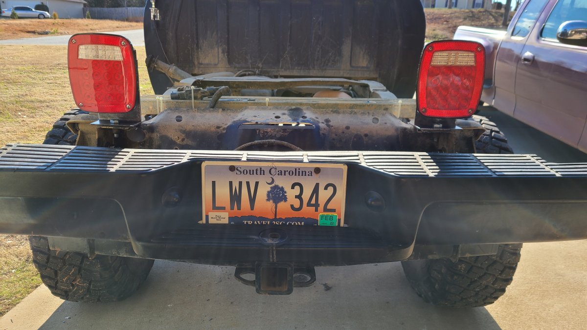

Put the old bumper back on and made brackets to temporarily mount the lights I boought for the new bed. Now I just need a turn signal relay compatible with LEDS and It's ready to be driven in winter weather this weekend.
Id be careful if your going to go out with no weight back there if the weather gets bad. Ive drove with no bed at all before. The small gravels the tires wil throw at the back of the cab can take you by suprize.
Plan on any ballast for the rear end so it is less squirrelly?
Great time to do donuts?
Seriously, thanks for the warning and I already had that in mind. Not only is the back really light, but I have a lunchbox locker back there, too. Almost thought about removing the rear drive shaft and just use front wheel drive for safety. That's too much trouble for just a day or two of bad weather driving. My route to work is all back roads.
You also run the risk of rocks breaking the back window.
It will be fine
I would board over the tires though

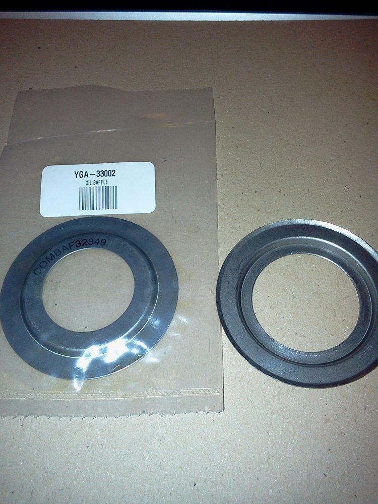

'twas tinkering with a 2004 front diff that's dismembered, oops, I mean disassembled. figured it's about time to put it back together.
while removing the inner pinion bearing race the oil baffle gets trashed and I haven't found the exact replacement for it yet.
so I modified a different baffle to fit.
had to enlarge the center and put a bent lip on the outside. the hole it goes into doesn't have a perfectly square edge, causes the baffle to stand off the bottom a bit.
I know the outer race will mostly smash it down, but that might effect the preload torque. plus the old baffle had a perfectly formed lip.
oh, the baffle gets dropped into a hole then the wide part of the inner race is pushed down on top of it.
used my mini lathe to cut the inner hole, then clamped the baffle between the race and a large socket which left the outer
edge exposed, then some intricate hammer bashing to form the lip over the race.
and that's what an 'ol retired guy does for fun.
how's it look? I made 2 of 'em.
70980
damn, just noticed I made it up-side-down :dntknw:

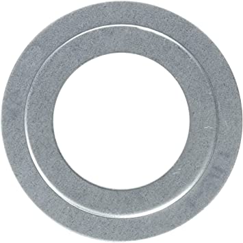

Looks a lot like a reducing washer for electrical conduit. They come in a bunch of different sizes.
