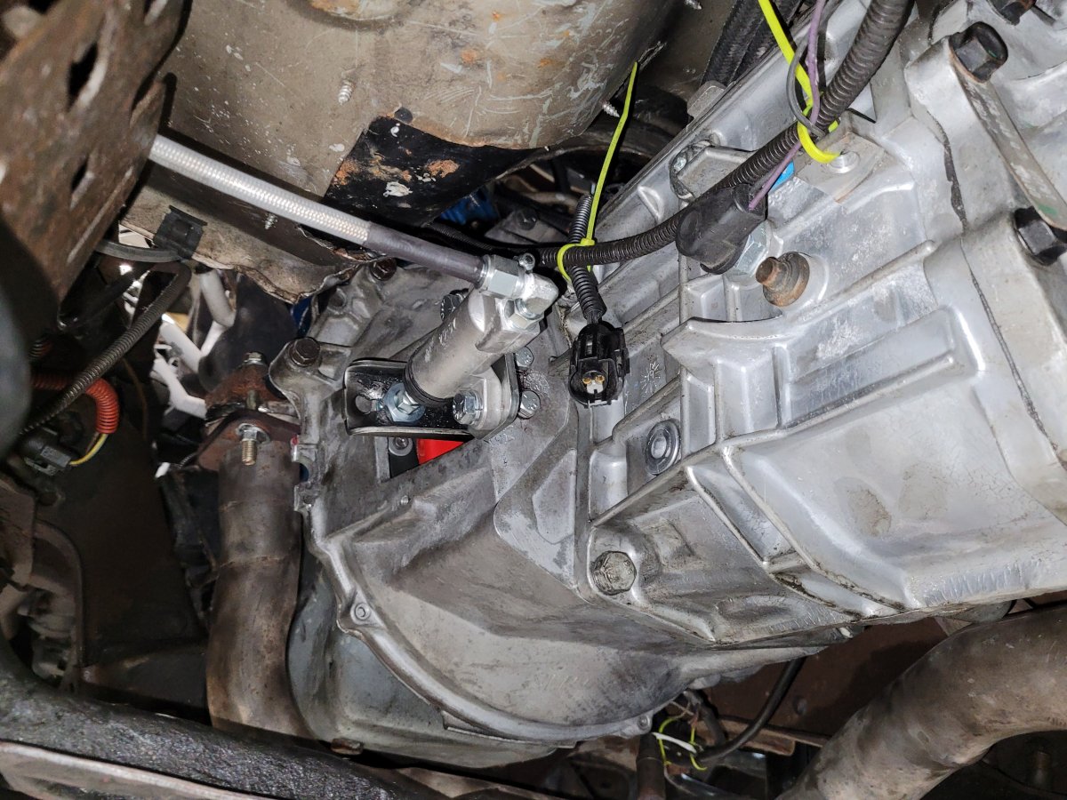

Got everything together the other night.
69831
Modern driveline has a very nice hydraulic slave setup, install with the drilling is a pain. The McLeod super street clutch is very aggressive in engagement. I would like a lil more petal travel above the floor then what I'm getting to engagement, it definitely lets me know my second gear sycro is wasted. It was never that bad with the one level lower clutch. Well only on high rpm down and up shifts really now its grinds all the time secondonly unless you time it just right...... that got messed up when one of the other slaves started leaking...... I guess I gotta pull the trans again and get second replaced. Also mabye try and use their master cylinder and make it fit.
