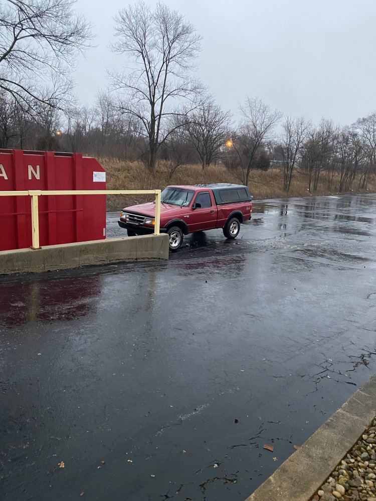

Started mine up....just to scare away the people looking at the house next door that is for sale.
