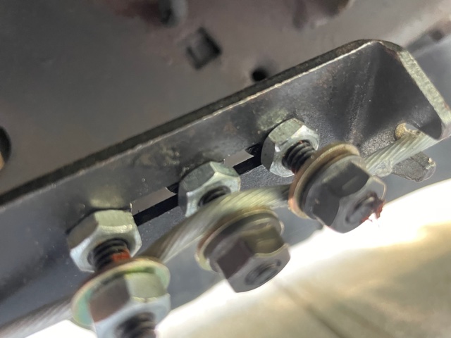

I had some front ebrake cable stretch, so I needed to shorten it. Dorman makes a cable shortener but it's fugly.
I rooted around in the junk bin and came up with this.. The nuts are locktited.
Not as ugly as the Dorman. I'll keep it Fluid Filmed.

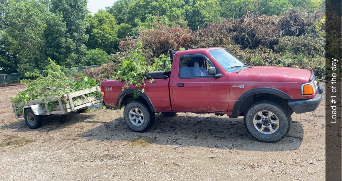

Not loaded up up like yesterday but worked it still.
Ended up hauling off 7 loads of brush from the bosses property. I think its time to invest in a bigger little trailer. Maybe a 6x10 or 6x12. This little 5x7 tilt is handy but sucks for this kind of work.
