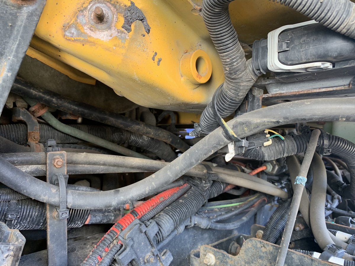

I looked at it and said “nope, not today”... now I’m at work trying to find the intermittent short in this area:
58169

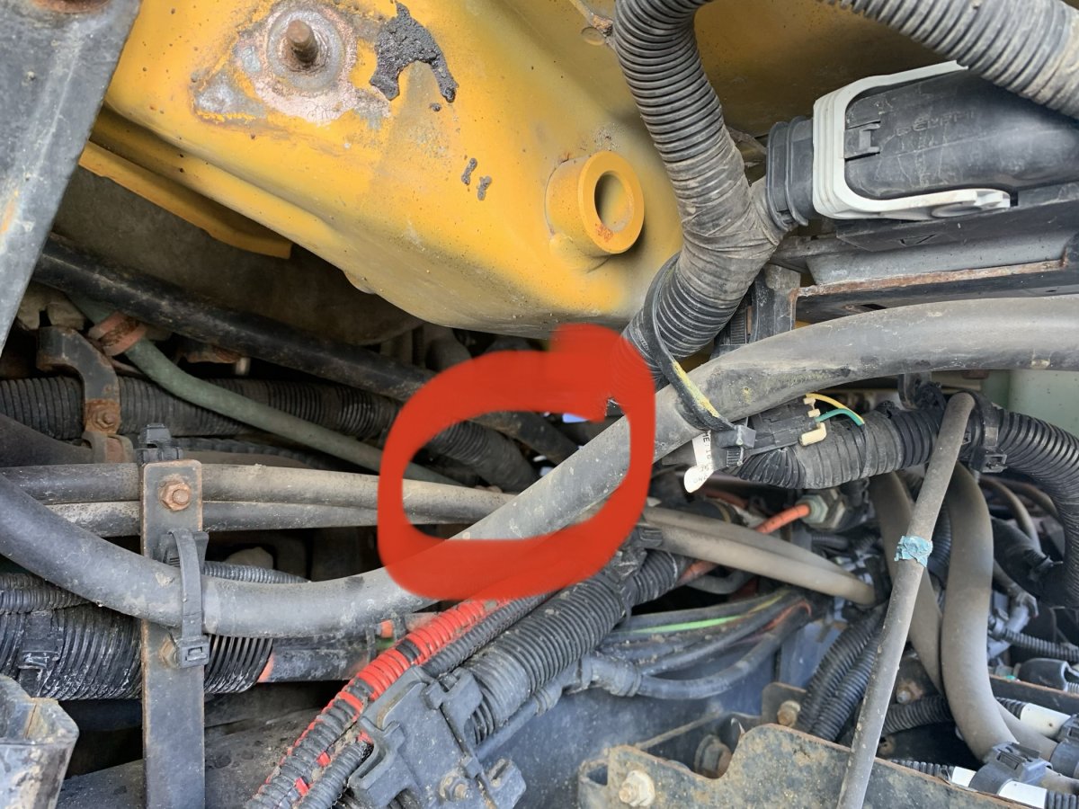

If you were to zoom in here:
58171
Then pull the harness away from the bracket, shine a flashlight at the right angle, and look with a mirror, you can see this little spec of green wire...
58172
I should have taken the day off and worked on my Ranger.
See my edit.

I work until midnight... and they need the truck for a paving job in the morning. (It’s an International 7600 tri-axle dump truck.) I’ve got about 6 hours to fix 1 wire.

The “green wire” term means the copper already started corroding. These trucks get used for paving in the summer and salting/plowing in the winter. The salt destroys everything in its path. If I don’t cut that section out and replace it, it won’t make it 6 months before I’m in here again...
