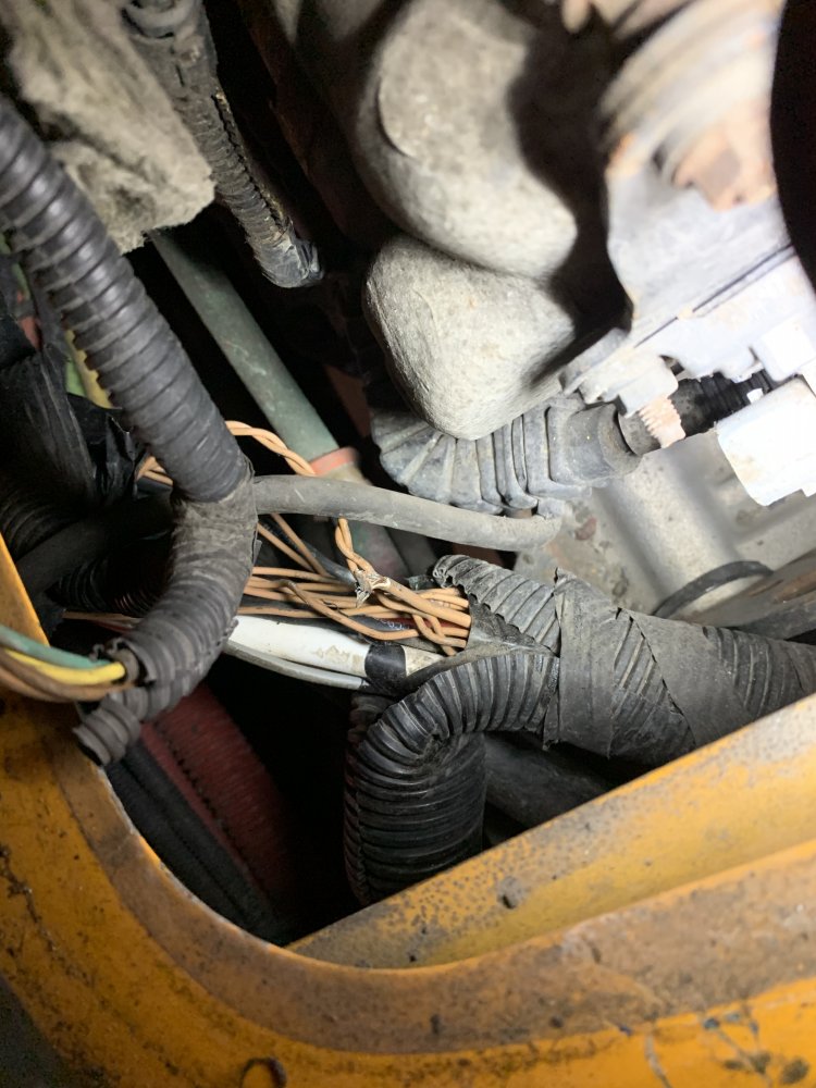

I work until midnight... and they need the truck for a paving job in the morning. (It’s an International 7600 tri-axle dump truck.) I’ve got about 6 hours to fix 1 wire.
In case anyone was wondering...
I unbolted and lifted the back of the cab 6”, removed the steps, climbed in between the cab and the frame, I cut about a dozen zip ties, removed the doghouse, pull the harness up to the bottom of the cab, secured with a bungee cord, and removed the wire loom. Now it’s easy to get to.
58193
There were two copper strands left intact before I pulled the harness up. I guess that’s why the short finder couldn’t pinpoint the exact spot.... Whatever, I got it fixed and back together for road dept to break it again tomorrow.

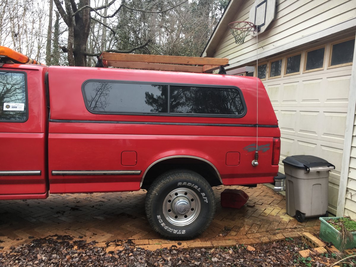

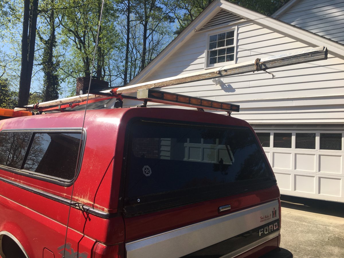

Installed the roof racks on the 2011. I need to stop by the Home Depot for some lumber.
