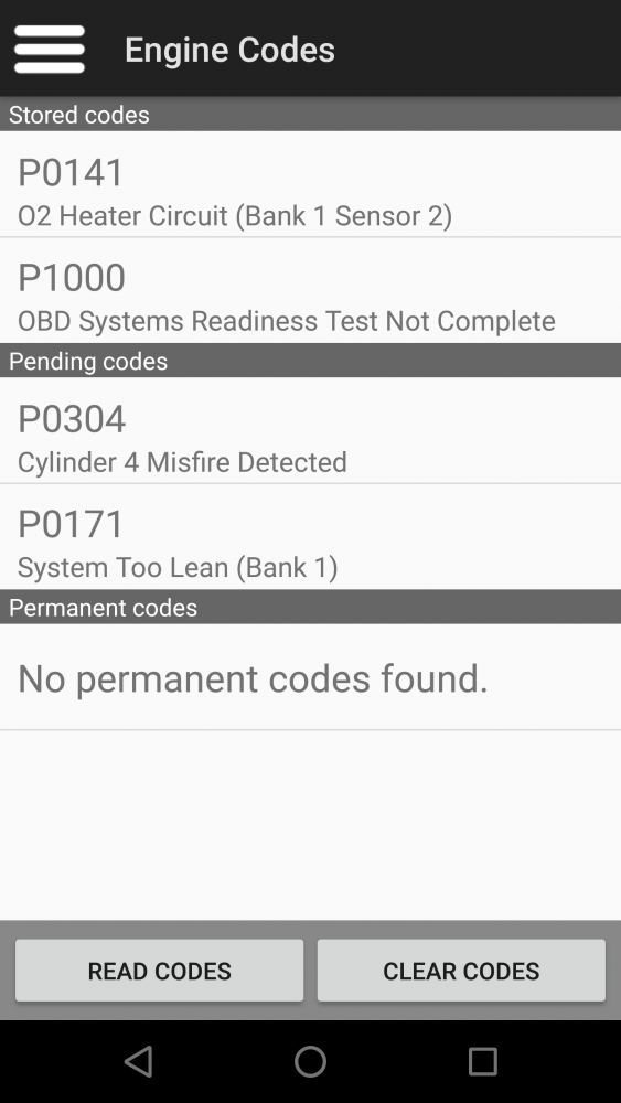

Replace spark plugs spark plug wires and left ignition coil an EGR valve. That's all I can think of at the moment that's been replaced. I've had it in the shop three times two different mechanics cannot fix the problem. The mass airflow sensor has been cleaned and a new air filter has been put in.
It acts like it wants to die at an intersection or while driving it shakes really bad. With the oxygen sensors have anything to do with this.

It would help to know what engine it is... but obviously cylinder #4 isnt firing and with a lean code on the same bank I'd check that the injector is firing.
It 4V 2.5 liter engine.
How do you check the fuel injector I am no mechanic by the strength of the imagination. I'm a computer technician.
1998 Ranger with ???
2.5l 4cyl engine?
Assuming that from replaced "left ignition coil" statement
If a 4 cyl engine then a misfire in #4 means 25% of the engine is not working
Lean code could be from the misfire
O2 sensor code for sensor 2(behind cat converter) wouldn't effect engine operation, but should be looked at, "heater" wire(s) may have come in contact with exhaust pipe and melted
P1000 just means computer has been reset recently, takes a few Drive cycles for computer to retest all the systems
One Drive cycle = full warm up and full cool down
So what do the #4 spark plug tips look like, the old ones?
They can tell you condition inside the cylinder

That's what my Bluetooth scanner says
What program should I use for Android that would give me a better clue on what's going on?
Another scan tool isnt going to help. You need to find out why there is a misfire on cylinder 4. You need spark, fuel, and compression. You can get a cheap spark tester at any parts store. For fuel you can simply disconnect the ignition wire on that cylinder, run it and then pull the plug and see if its wet with fuel. For compression you need a compression gauge. Any mechanic should have tested these things already though...
