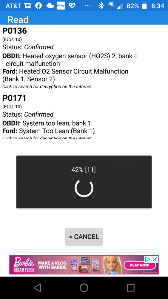

I got the lean code today again.
P171

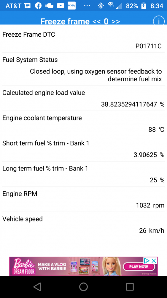

Freeze Frame Data.
P01711C

P0171 System too Lean (Bank 1)
Which one is it?
I posted the freeze frame in the latest codes the other day. It's going back to that same mechanic tomorrow hopefully. If you all could help me out by tell me what to tell him to look for that would be great.
