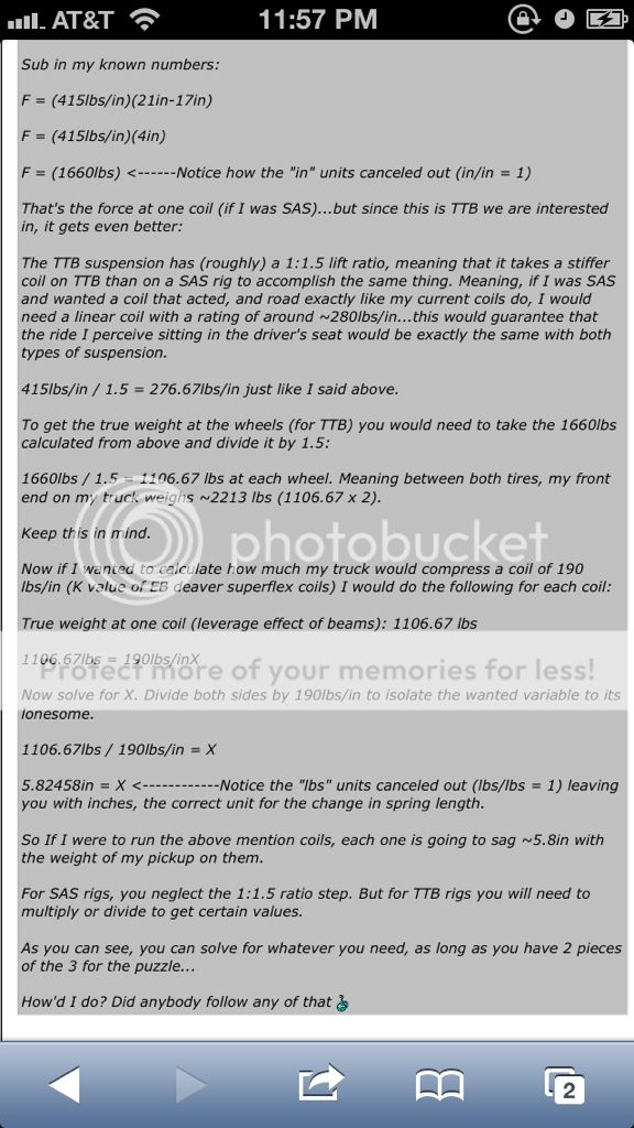

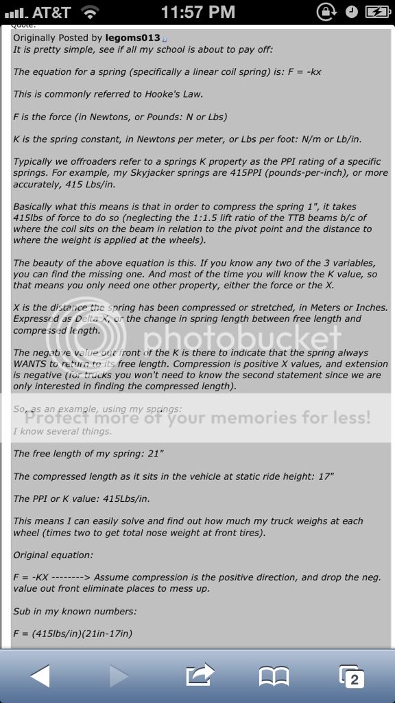

Get me the numbers and I'll help you out. When I get on my ipad or laptop tonight or tomorrow night I'll search for the post from Legoms with the explanation of how it works.
It's in my build thread somewhere

Thx 4.0!! Here's what I came up with:
F=(190 lbs/in)(22.5 in - 16.5 in)
F=(190 lbs/in)(6 in)
F=1140 lbs
My B2 has its orig 2.9/5 spd with a D30 SAS from an XJ. Custom winch bumper and winch w steel cable. Does that number jive? If so, what PPI rate should I be running for best offroad stability/ride?
