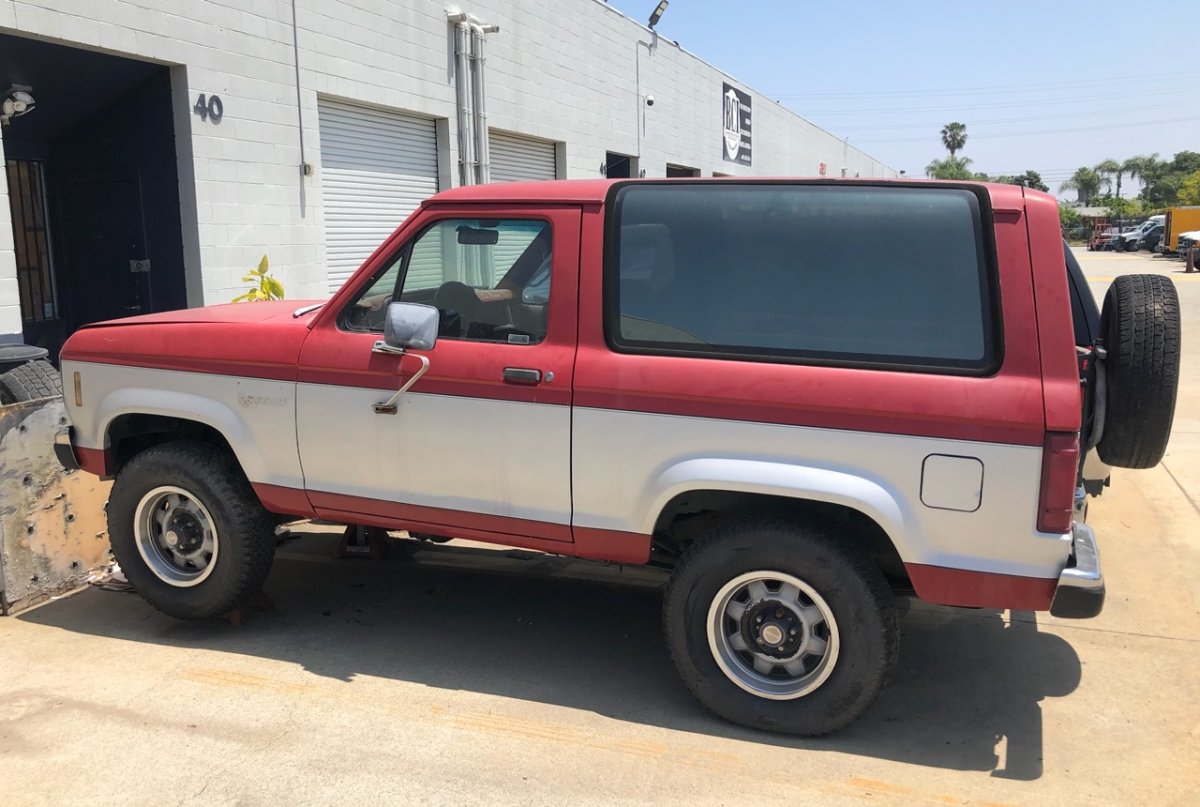

I’m working on an 88’ 2.9l 4x B2 that’s been sitting for about 9years.
Replaced Fuel Tank, fuel pumps, Filters, Plugs, cleaned and rebuilt injectors and I finally got it started.
Then I reach in to make sure the crank case breather is seated correctly and I put too much pressure on the factory Nylon Fuel line at the Regulator and it springs a leak. My concern is that all the fuel lines are most likely too brittle to be safe.
