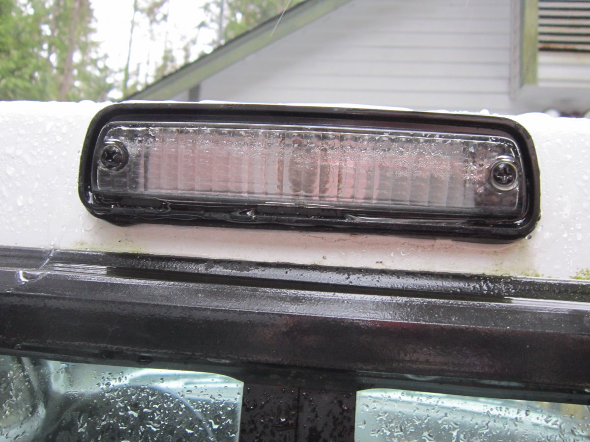

So after a night of rain, I went and checked the cab for water intrusion. It appears the rear is still leaking. So, I guess I'm taking the topper off to get access to the cargo light to see if its cracked or whatever. I will keep you guys updated.

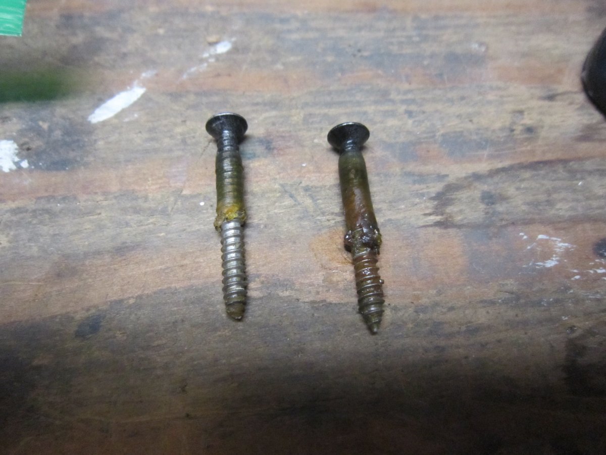

OK, so I found the culprit...
55951
Hole large enough so the screw would not grab. PO obviously tried to seal it with some kind of sealant and failed IMO. I cleaned up the little rust spot and treated it. Cleaned up the gasket and light assembly and resealed them together. Then used some clips I had so the screws would grab and tighten the light assembly to the cab of the truck.
PO attempt to seal the screws.
55953
I used 2 of these clips (one for each screw). The gasket is plenty thick to cover the whole clip.
55954
Before removal...
55955
Now we will see if there are any leaks tomorrow or later today as the rain has started up again.

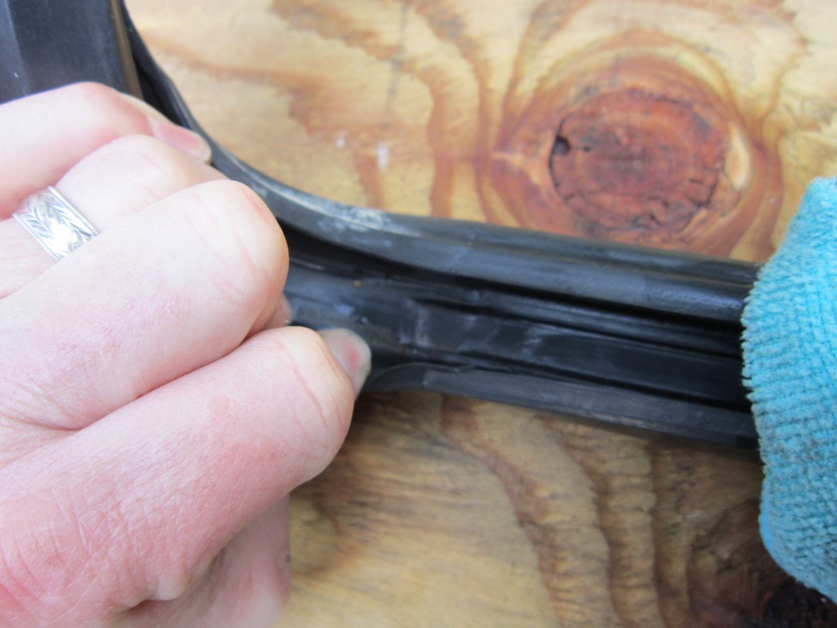

So I was able to pull the slider out today. Found most of the drains were clogged as well as the frame drains were clogged too.
56250
56251
56252

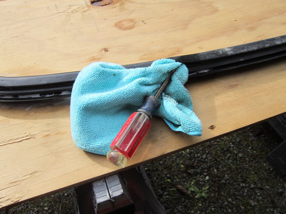

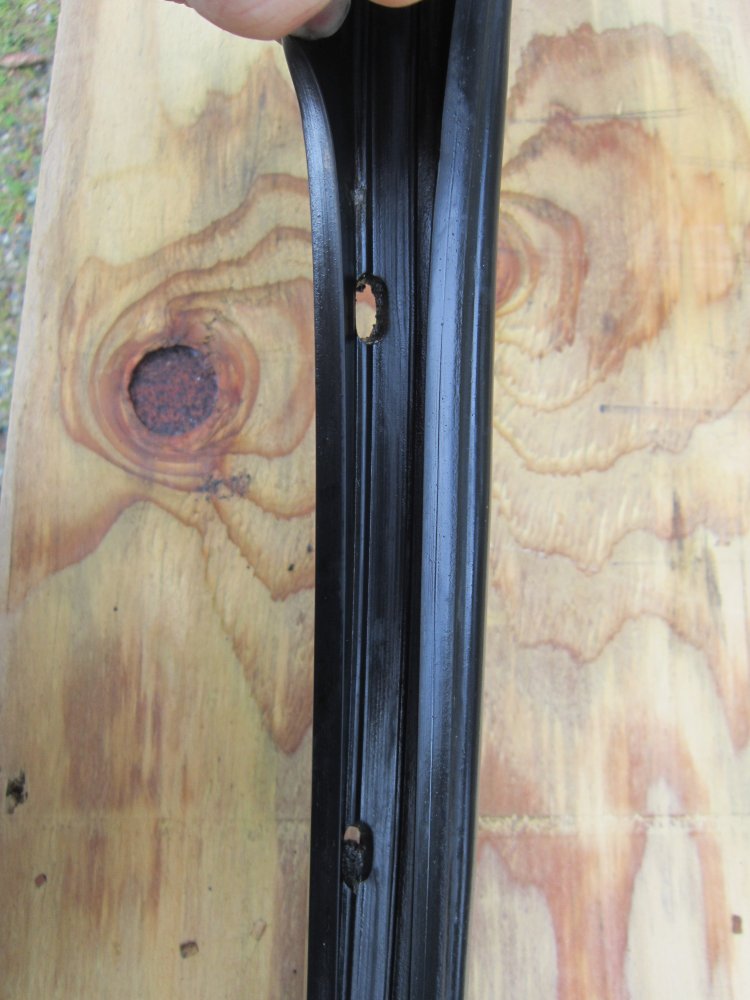

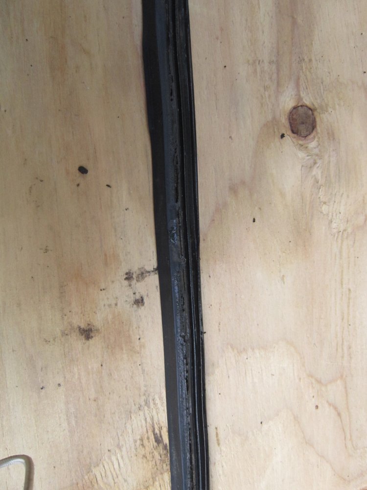

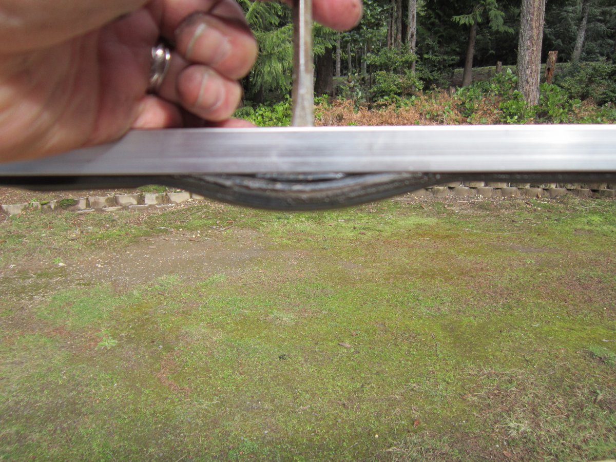

Ended up using window cleaner on the gasket, then cleaning out the channels with a rag and screwdriver.
56253
56254

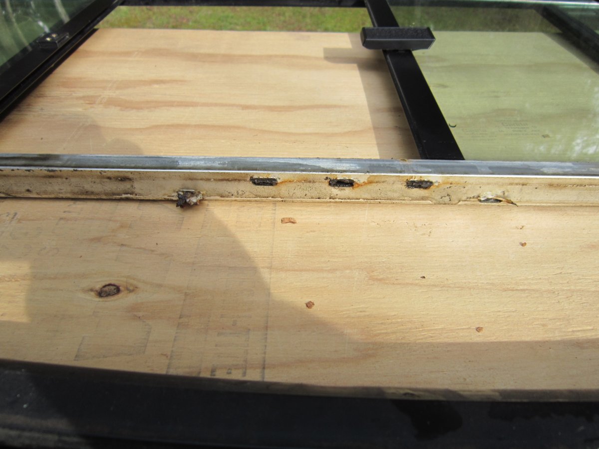

Cleaned out the frame channel as well. You can see the run off channel on the bottom that goes to the drains.
56255
56256

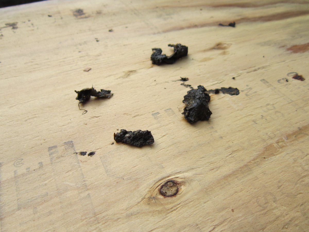

Cleaned all the drain holes and the channel and ended up with this crud... there is still a lot on the rag too.

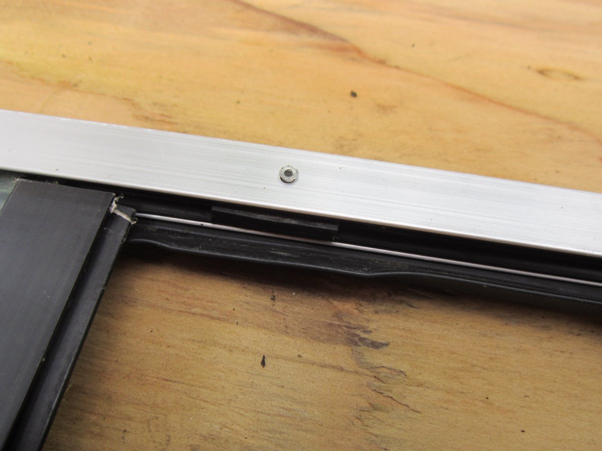

Next was the slider frame and cleaning out its drains...
56258
popped out the seal for the slider when its closed...

Cleaned out all the crud on both sides.. and reinstalled...

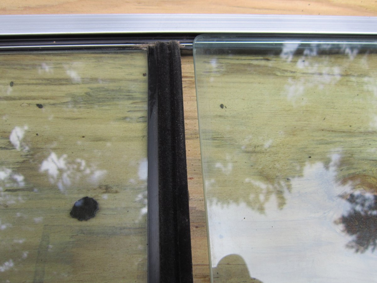

Pulled the pin for the window stopper in the center and cleaned the felt off...
56262
56263

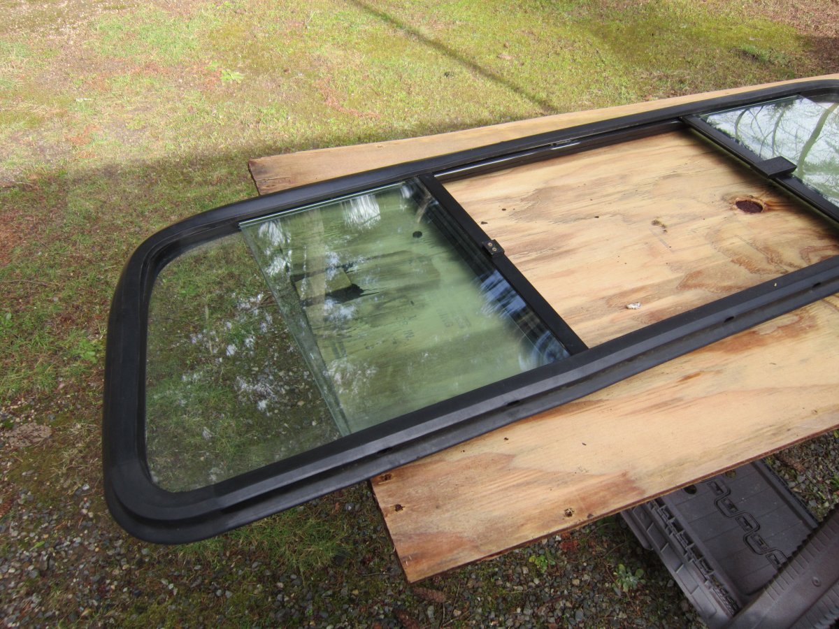

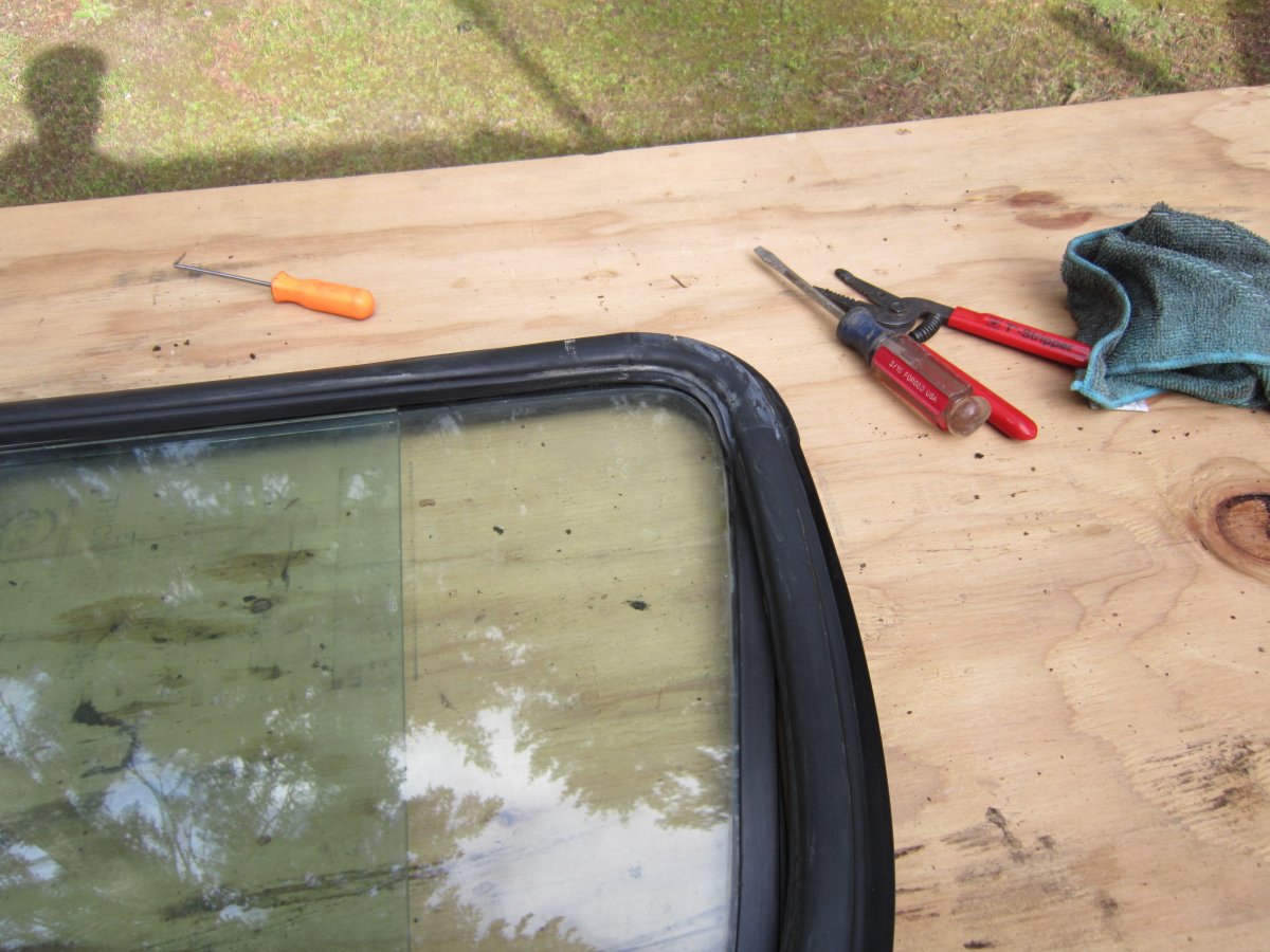

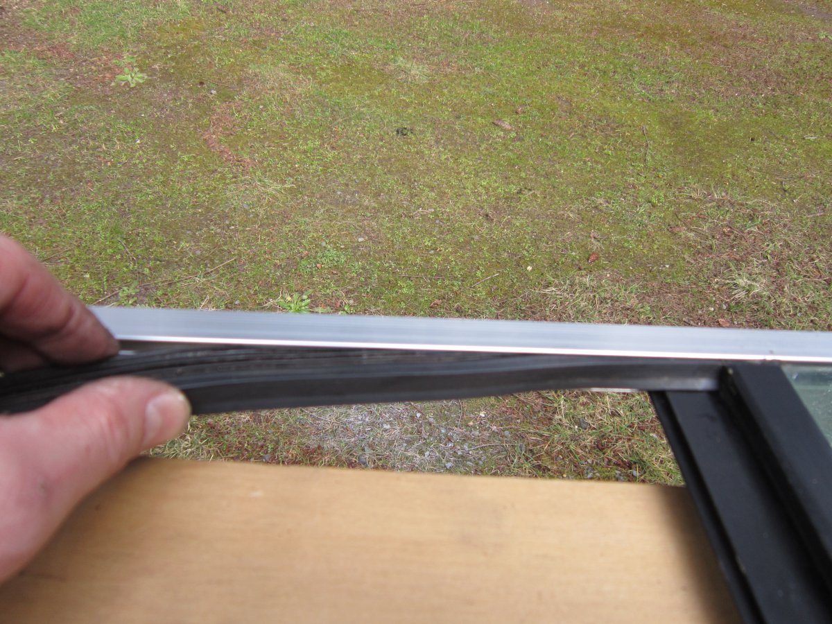

Reinstall the gasket...
56264
Just make sure you install the gasket the correct way. I ended up putting the inside facing out... and sadly didn't notice until I had it completely installed. Pulled it back out and reinstall the gasket the correct way and back in the truck.
56265

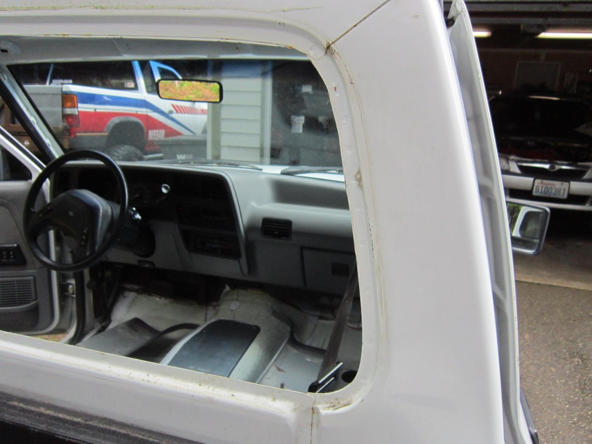

Before installing the window I check the body for any corrosion which there wasn't any. Cleaned the matting surface then installed the window.
56267
56268

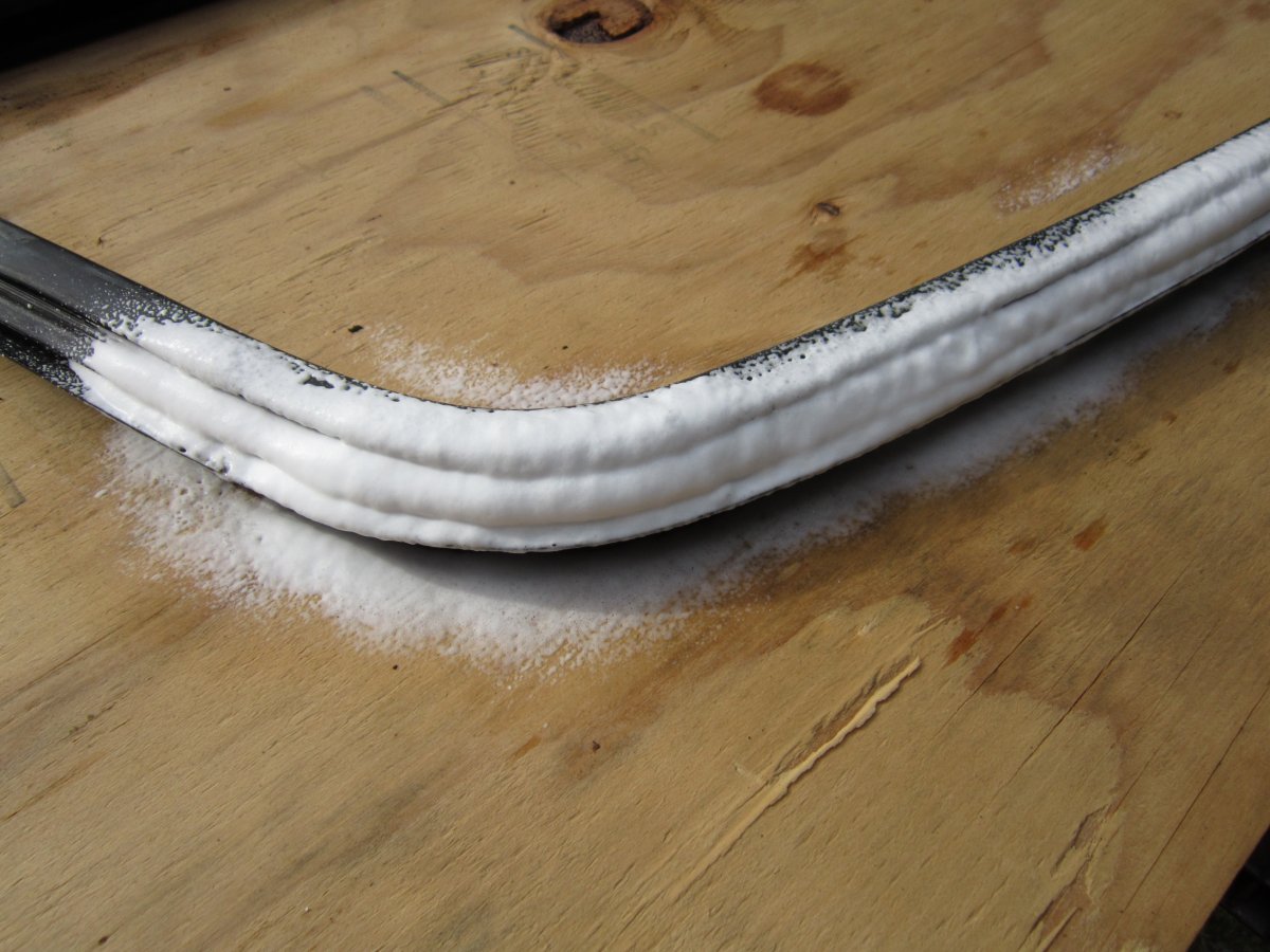

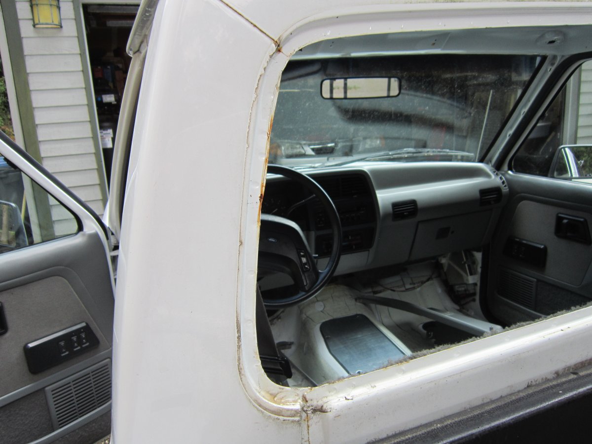

I did run some silicon on the seams at the top corners of the cab, then ran silicon on any seams that had gaps...
56269
While the best way to reinstall the slider is with 1/8"-3/16" cord, I could not find mine. So I had to pull the gasket back in with screwdriver. Not the ideal way but it can be done. You just need to be careful not the tear or puncture the gasket. You see here how the latch is on the outside. Oops!
56270
And proof that I did catch it and fix it. LOL
56271

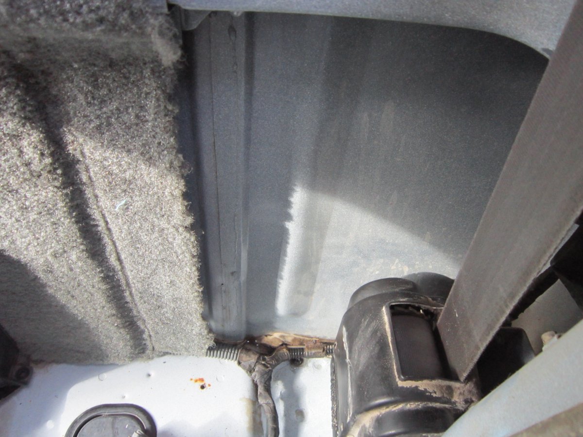

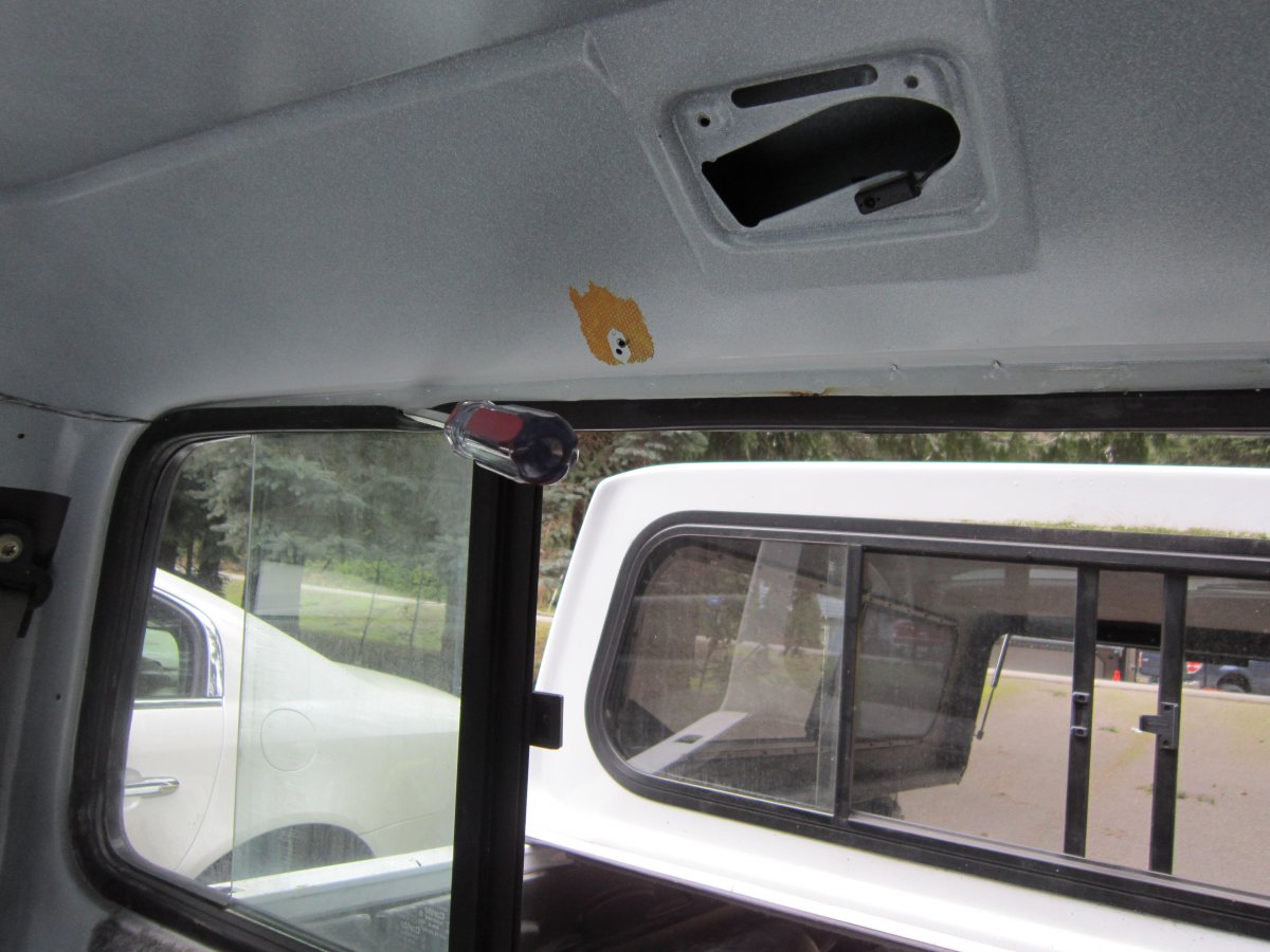

I did a water test. Good news - slider and seal not leaking any more. Bad news - found a new drip. Same area but coming from between the 2 panels below the rear window. Its not the window or seal, its not the cargo light. So tomorrow I start using tape to find it. You can see the drip on the rib next the carpet edge. Its just enough to call it a day and attack it tomorrow.
56272

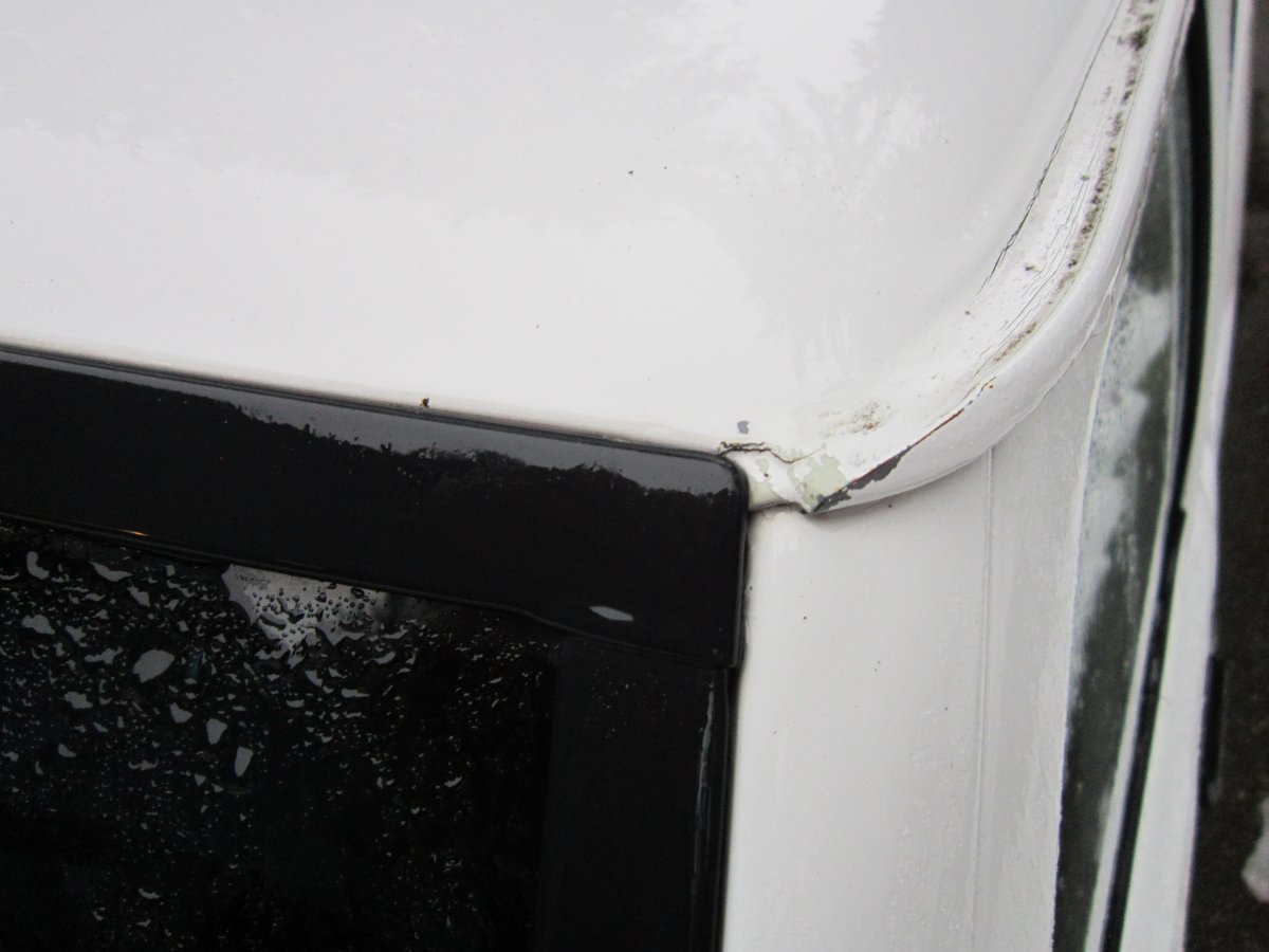

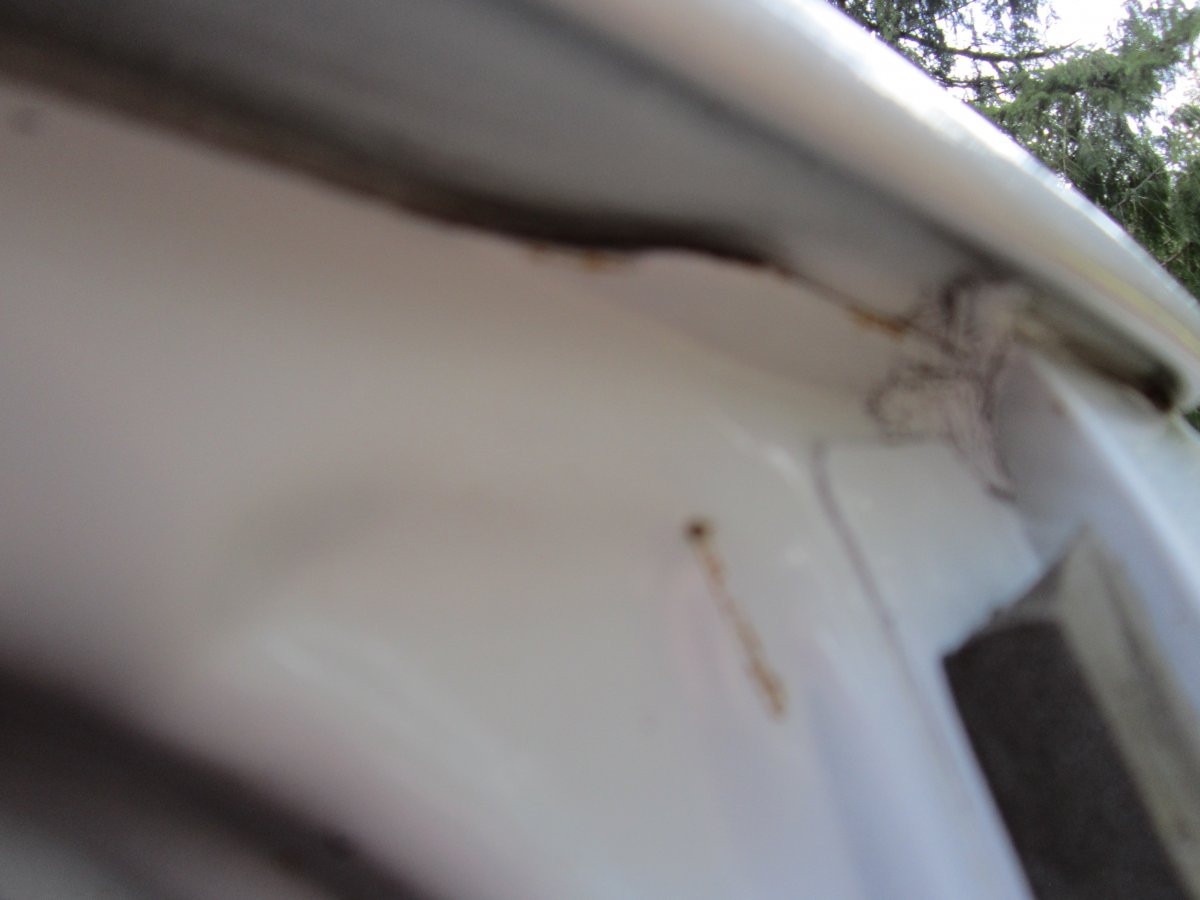

Just as @alwaysFlOoReD said... just the little cracks in the body caulking allows water in. You can see the cracks in the paint.
61722
61723
Yep, the factory just spot welded the top to the gutters, and then smeared sealer in there. That sealer getting hard and cracking is one of the main reasons the older large trucks had rusted out cab corners. Don't know about the Rangers, but they seem to be put together the same was as the full size trucks.
Yep - checked the gutter seals and there are thin cracks on both sides in the middle and right down into the windshield. Is it possible to seal the cracks without pulling the windshield, or do the cracks/seams run under the glass in a way that the liquid gasket holding in the window would not seal that portion of the seam?
You can remove the windshield trim to get to the seams. If the windshield has been replaced you might as well run a thin coat around the edge of the glass to windshield sealer too. I had leaks there as well.
