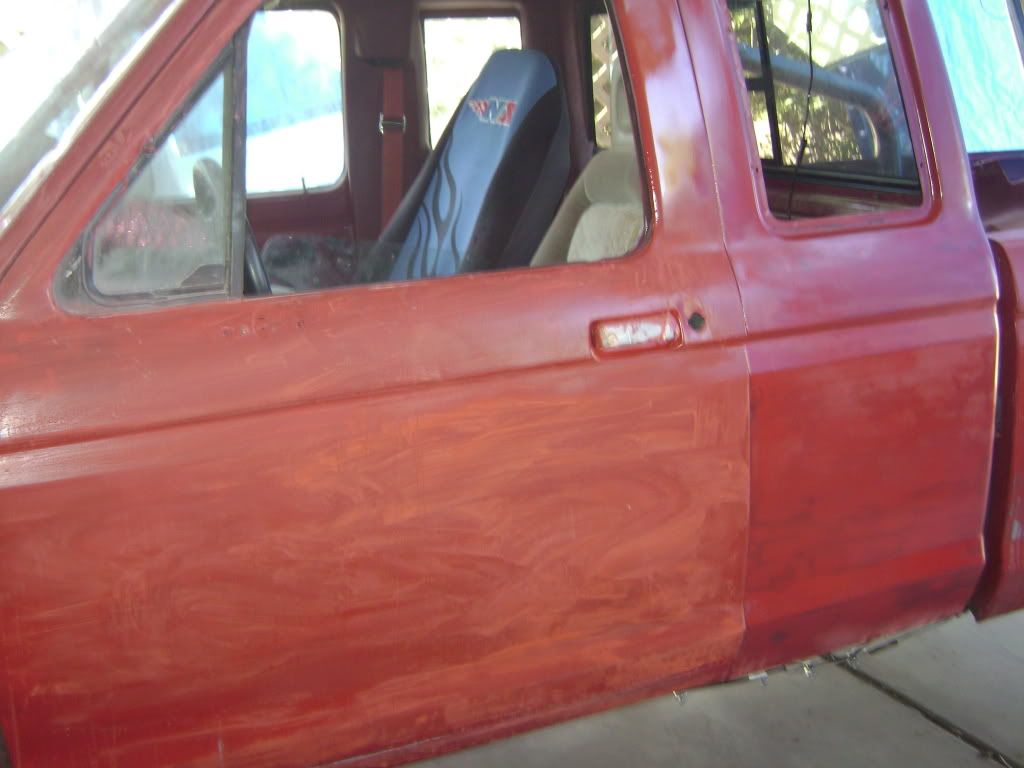

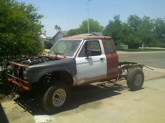

Well I started the rustoluem paint job.

Well as the title states I started the wonderful and cheap rustoleum roll on paint job. as I started I noticed alot running paint and bubbling in the paint from the foam roller. I felt that the 50/50 mix of paint/thinner was thin enough. but by my third coat I thought of thinning it even more to about 75/25 with it thinned out even more it seems to "self level" and keep the running and bubbling down. And Again sorry about the pics I keep forgetting my camera so shitty phone camera.
And now for the 3rd coat of paint. at this point I still need to wet sand and roll at least 2 more coats. also remeber that I have only done the hood fender door and just behind the door to kinda do a test area. and I'm only spent about $40. and still have about a quart of mixed paint still.
yes I know I need to lift my box 1 inch I just did the lift on the cab but not the box yet. will do when I paint the rest of the cab.

and here are some more pics of the truck in the process of the painting with a better camera. I have also started painting the rest of the cab. As you can see there are some places that the paint that have run. but it seems to be sanding smooth.
and after another coat of paint before calling it a day.
So ya I know this a taking me for ever. but I have been pretty lazy and slow. but now that I have the techniqe down I should be going a little quicker.
