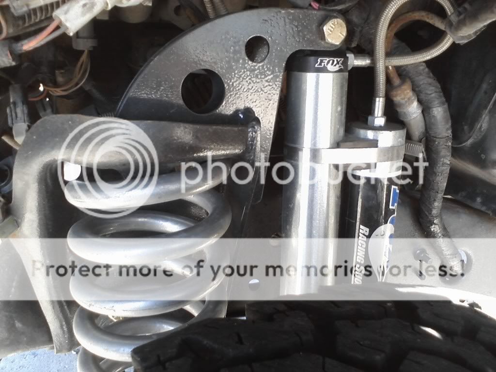

made these for my friend the other day. involves removing coil bucket(rivets), cutting stock bucket down vertical rib. Fast fit up. clean way to fit a 10" stroke shock with 4-6 in lift.
Yes. They consist of 4 pcs. per side. Top disk cap, triangular gusset, and 2 ea. shock mnt arches. All CNC cut with key-ways to fit every time. Can fit 2'' or 2.5" shock

I labeled the coil buckets as such, because it keeps the bucket from folding upward by having the vertical gusset. This happened on my old truck. Any feed back would be appreciated 200+ views ?

8" or 10" stroke shock if the lower mount is in the stock location. Also the suspension is bumped in the stock location..
Thanks!
10" stroke shock. stock height bump stops. just shipped a set of these last Friday. should have a write up from customer soon.
