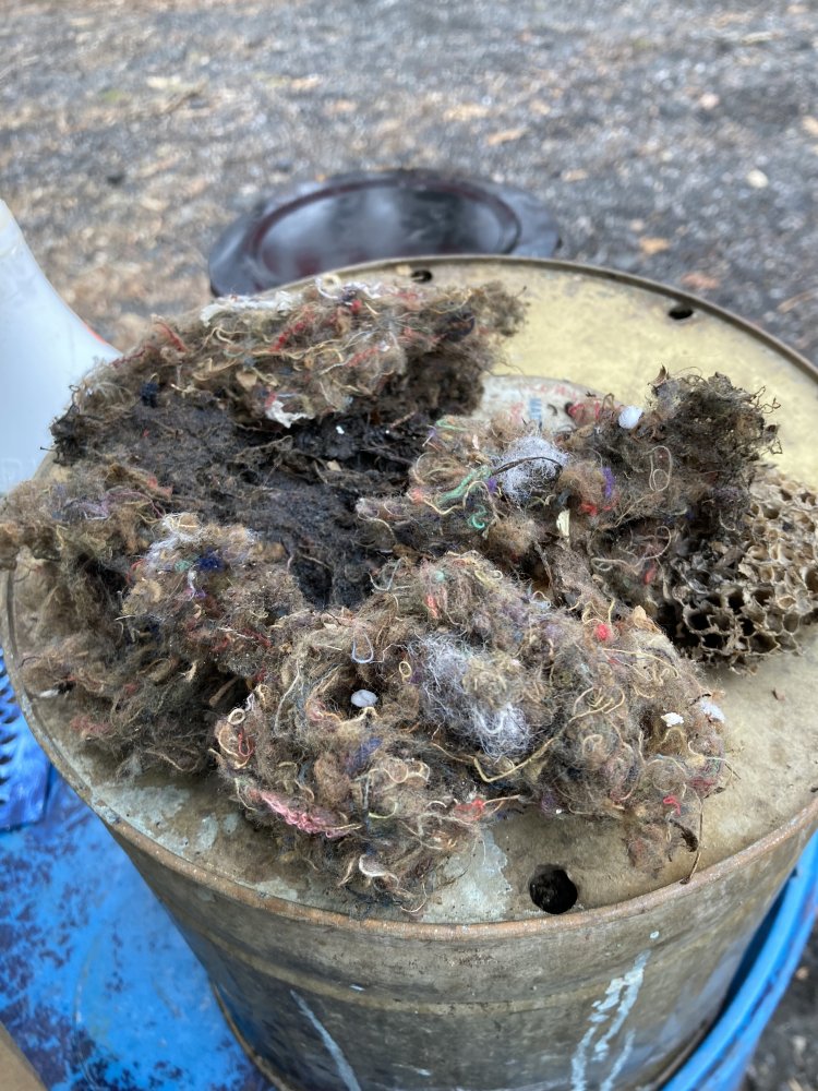

Do you think perhaps this might have caused water to come into the cab from cowl?
Used small vac hose with a .22 cleaning rod taped to it: pulled all this out of the cowl!!!
Judgejohnmd
If that was plugging up a drain then yes. Common problem on square chevys causing a bunch of fun rot repair.
Looks like a rat condo
