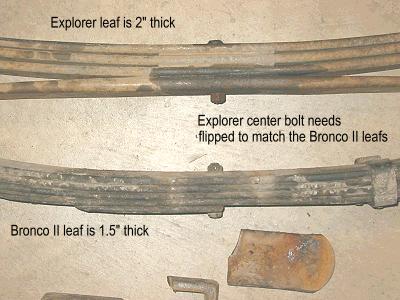

You can see the bolt I was talking about in the below pic:
If using Ranger leaf springs you will need to flip that bolt over to match the Explorer axle. If you were to use Explorer leaf springs you wouldn't need to flip anything, but you wouldn't get as much drop either (only 2-3"). In my experience with Explorer leaf springs (on a 4wd Ranger) you probably want to stick with the Ranger springs, the Explorer springs are softer and tend to have more spring wrap.
