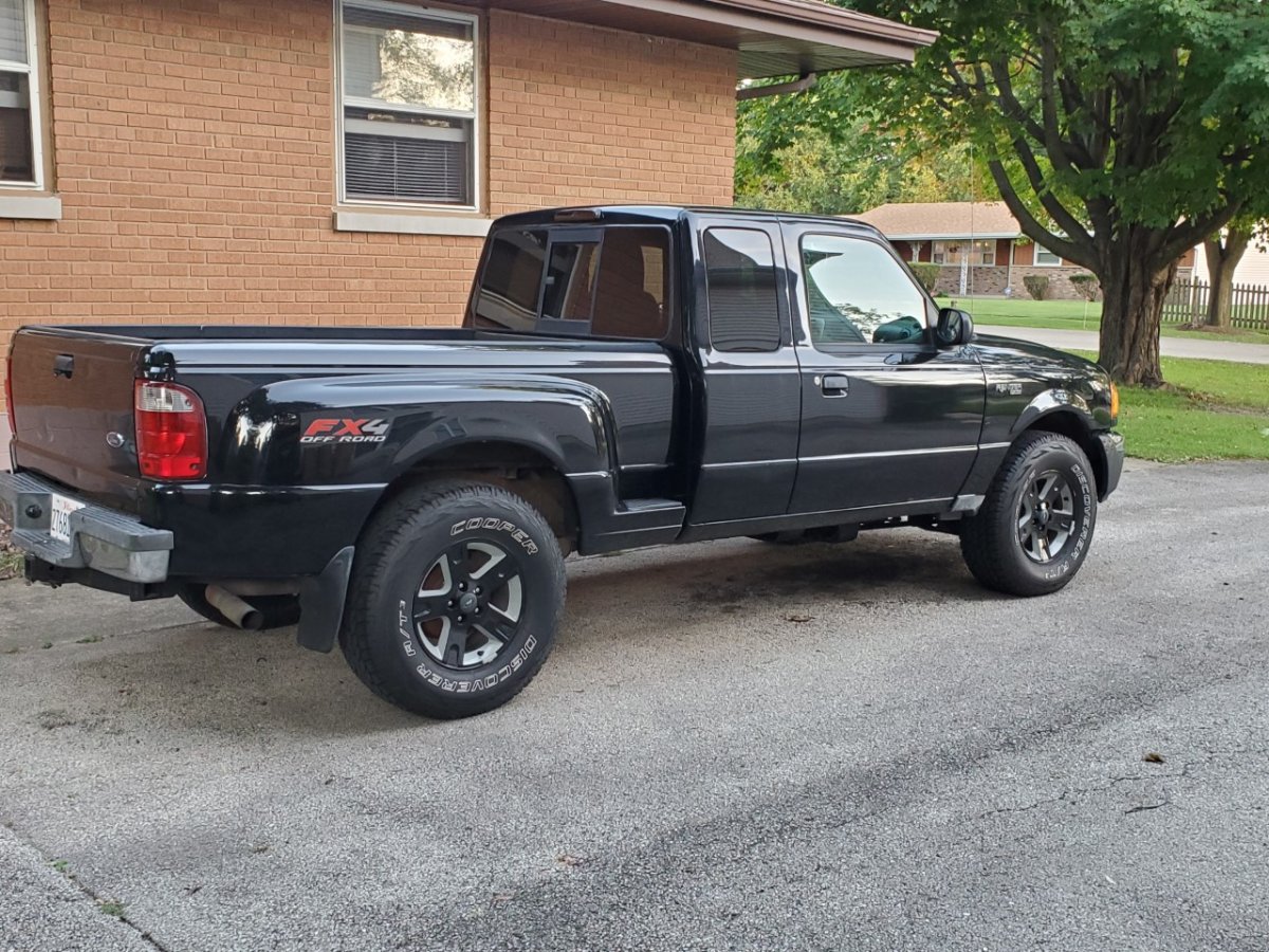

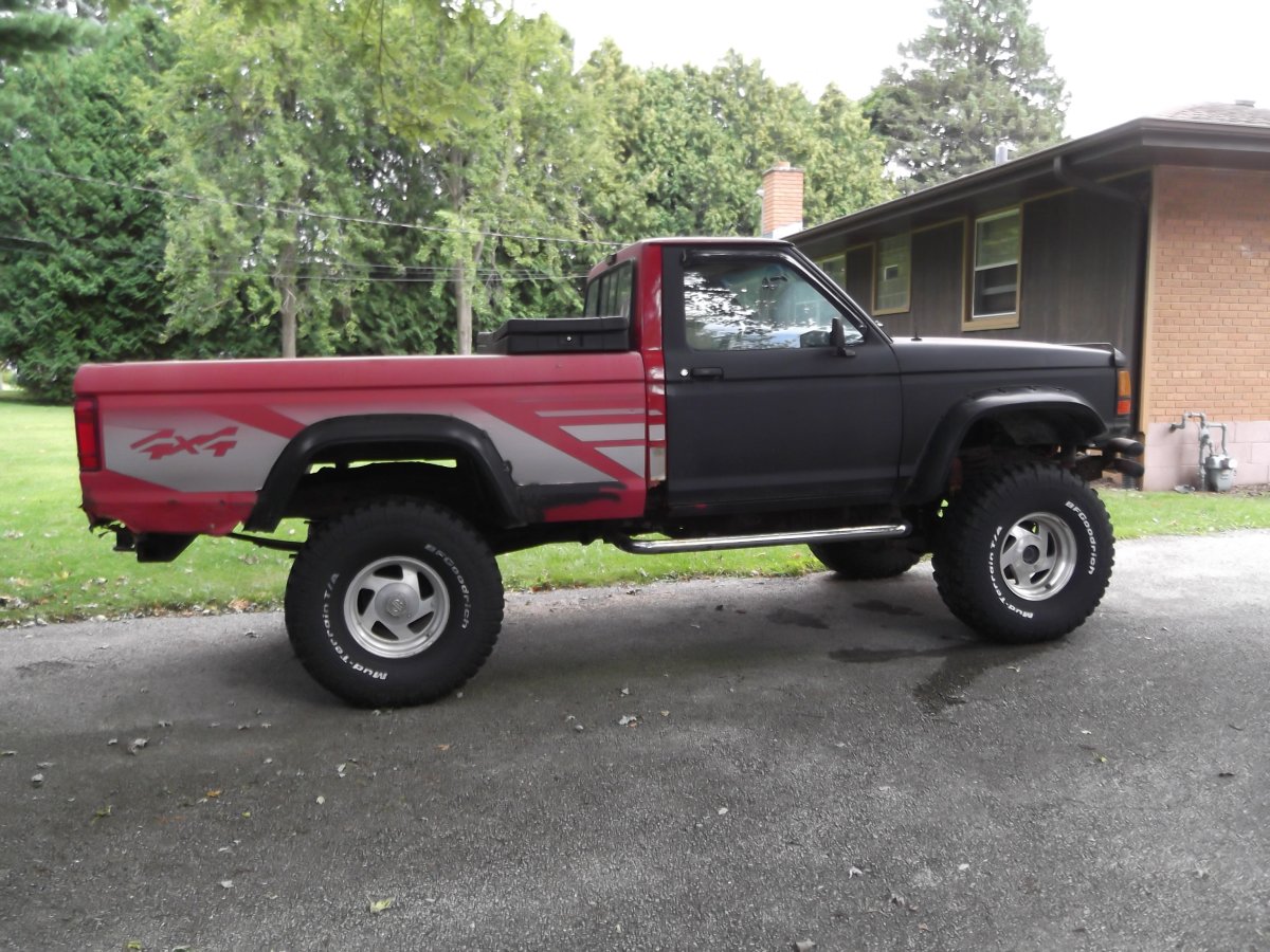

When I did my first inspection checked the u-joints by spinning the drive shaft and trying to move the u-joints and didn't notice any unusual movement. Yesterday I changed the fluid in the rear end, I turned the whole drive train using the ring gear to inspect the gears in the rear end, didn't see any unusual wear on the gears and it looked like the washers and c-clips were still in place. While cleaning the cover I noticed some unusual brown lines on the inside of the cover and the outside was damp in one spot after spraying the whole thing with brake cleaner, took the air hose and blew air on the wet spot and there were spots on the inside where it was oozing right where the brown lines were. I had to take an extra hour to get a new cover and the silicon sealer, because mine had dried out. I took it for a 5 mile test this morning and there wasn't and vibration. I guess I need to update my account, I sold the 92 STX with the lift and 35s and show that I have a 2004 FX4.
