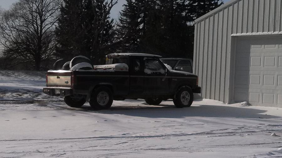

Its stock, its a super cab so it has the two shafts in back and the stock size tires, I had 31s on it for a while and it vibrated less and I haven't crawled under it to see if my rear flange has play in it. Should I start by checking that?
