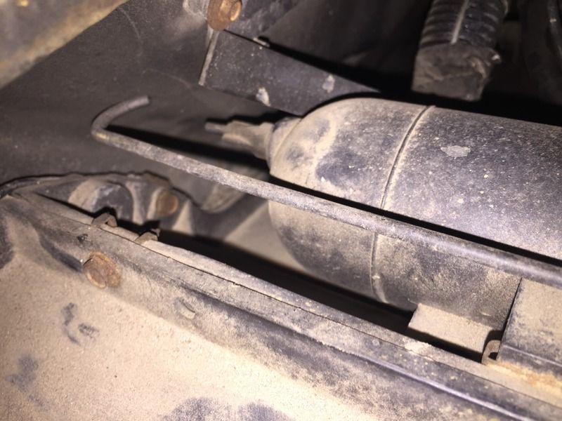

I noticed a broken vacuum line at the vacuum resevoir, not sure what symptoms I would be experiencing.. can anyone help? I also pulled 2 codes because my check engine light has been intermittent mainly in the morning after a cold start. The 2 codes are EGR valve opening not detected, and ECT out of self test range. For some reason or another I have been smelling fuel. I haven't dug too far into the smell yet. I have got under the truck and eliminated any hard line leaks or fuel filter. I haven't put eyes on areas around the injectors, but the smell seems to be coming from between the cab and bed. Fuel pump was replaced a year ago.

I haven't fixed the vacuum line yet. Truck seems to run fine, other than when I pull my trailer I'm running between gears every 2 minutes. I took the bed off when I replaced the fuel pump, everything looked decent. The 2 codes I have are newer. The last code I had was for 02 sensor and that has already been replaced.

Are you sure it is a vacuum line that is broken and did you trace it to both ends to find out what it is used for?
"Broken" is a pretty general term...it could still function to some degree but will still allow too much oxygen in past the MAF sensor resulting in an O2 sensor error...so it should be fixed properly before actually moving beyond that as a possible source of the problems.
If I saw what I think I saw, I'd get a length of vacuum line and connect the hard-plastic lines together using the rubber line as a 'union'. Get some line that will squeeze onto the hard plastic, and it will stay and do the job fine.
Leaking vacuum from the reservoir, depending on where the check valve is located, can cause the EGR to fail as it uses vacuum to open the valve. On most. Leaking reservoir may reduce the vacuum to the diaphragm is too weak to pull the valve open.
I'd think about pulling the bed bolts, and tilting the bed up on some 2X4's or boxes, and checking the filler neck for damage. Once the bed was removed, the filler neck may have flexed too much, or gotten damaged and is not venting fumes. They can get pretty brittle with age, and not like being disturbed.

I will couple the hard plastic vacuum line and see what happens. When I replaced my sending unit/fuel pump assembly last year I inspected the filler neck. It had a bigger outer rubber protective tube. I also wrapped the entire outer tube from top to bottom in electrical tape.
