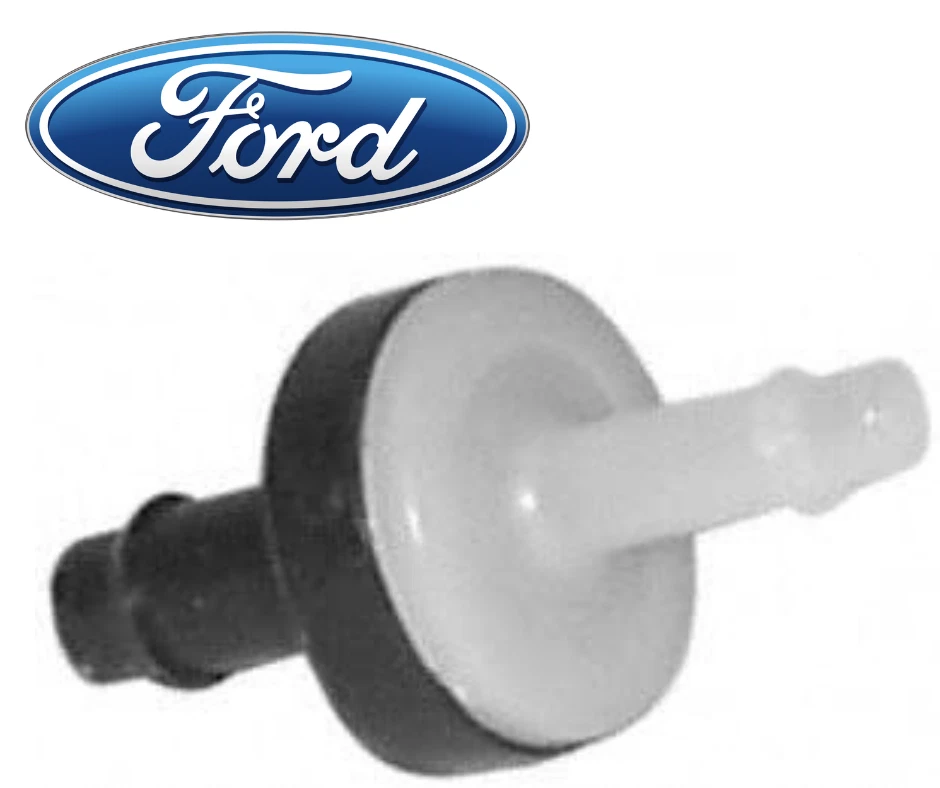

Built in check valve can happen but far more common to find one of these: https://i.ebayimg.com/images/g/66UAAOSwRepi6fEq/s-l1200.webp
On the vacuum line running from intake to reservoir

Or one easy thing I could do is just take the connector that is inside the connection in last pic, and get a check valve that fits it. That would be be easy assuming it's a common part. I'd think any check valve would work that fits, doesn't necessarily have to be Ford, though that would be nice.
