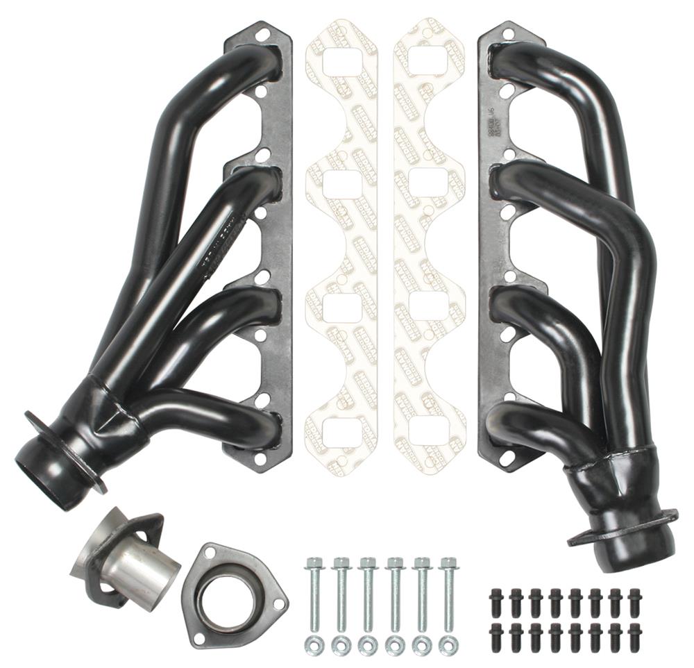

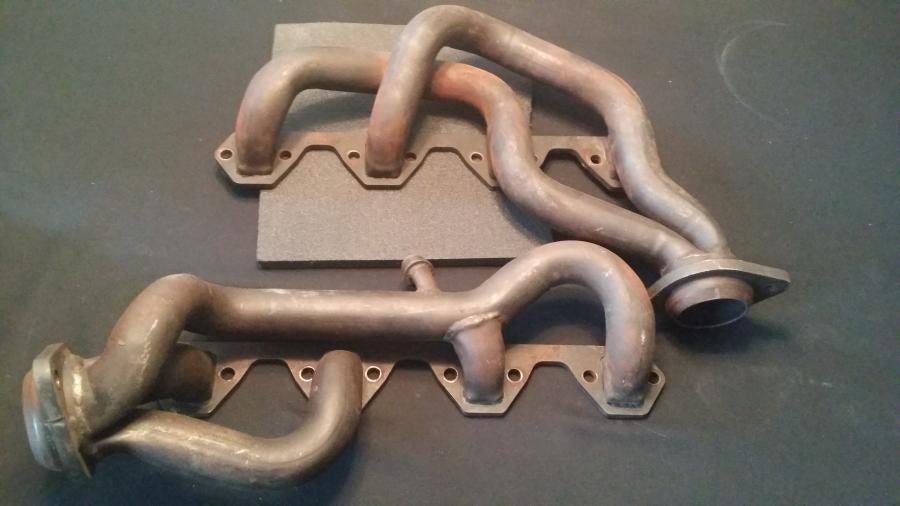

Until a $300 header set gives you 15hp and you can actually almost feel the difference.
Compared to the multi-year lead time for the one guy that makes them for a grand a set for the GT40P's.
vs
However, factory manifolds or the like will allow the use of factory downpipes and cats which isn't nothing to scoff at either if you remember my front driveshaft debacle for a couple years.
vs
The factory manifolds I've been seeing look a lot more like headers. Curvy tubular pieces making funny loops. Maybe not as good as welded up tubing, if done right, but they are more like headers than cast log style manifolds. Maybe some kind of hybrid compromise.
