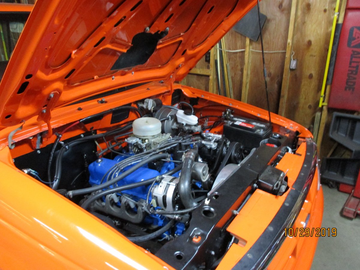

I would like to see pictures of this B2 5.0 swap.... I don't see many of them on the forum!
Here ya go, I kept a complete photo history of every task completed for the swap.

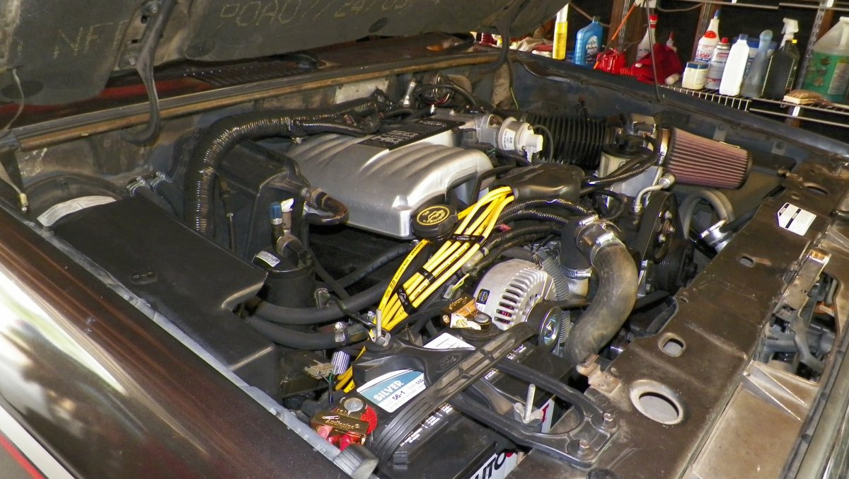

If you're talking about a 2 1/2" single system, I agree, a dual 2 1/2 will lower exhaust velocity and may hurt bottom end. It will likely be louder, too, and I'm not sure where you'd put a dual 2 1/2 system under a Bronco II, please don't run it out in front of the rear wheels.
My Ranger didn't have a heater box when I got it so I used a Vintage Air system, you're evap case really crowds things.

Very nice!
The AOD fit fine, although a bit snug in there. I used the stock transfer case with an Advance Adapters AOD to BW1350 adapter. I never created a thread while I was doing this.
It is never too late. Would love to see a thread!
I used a C4 because I had one that I had driven and knew it would be an easy rebuild. I've never built anything with an automatic transmission and didn't know if I'd be able to stand it, if I decide to swap in a T5 I should be able to sell the C4 for a small profit.
