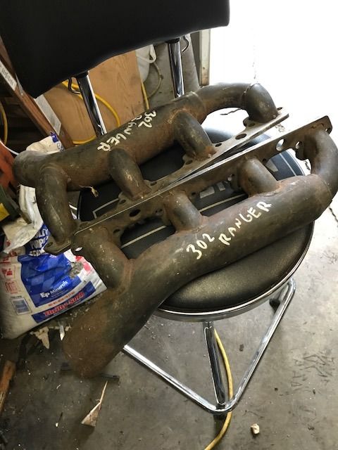

Just scored these for my Bronco2!
V8 Conversion Headers
How big are those runners? They look huge!
Got em for $75
The primary runners are 1 5/8 and the log is 2.5". I got some V-bands to weld to the collectors then blast and header paint
