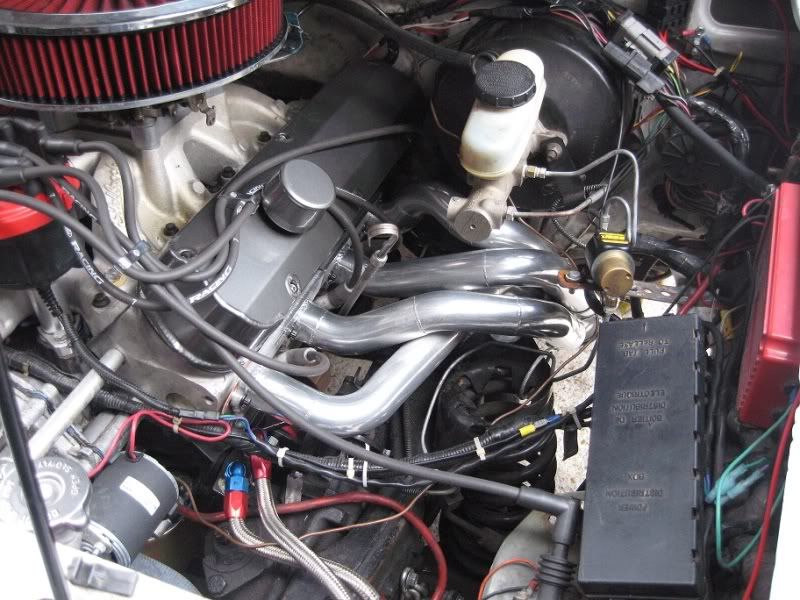

my custom headers
i had a set of 1 3/4 x 3 headers done that goes out over the frame rails. this is just a race truck with a 347.
