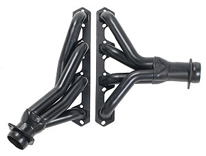

So I'm about to buy a set of tri-y's for my 94 with aode . Anyone got pics of them with a big bellhousing. I'll get them in regardless. What kinda hp gains am I looking at swapping out the stock expo exhaust manifolds . What were the average gains with the tm's and will the longs give a lil more ?
Anyone use the Hedman 89500?

I have heard the one that points straight down hits the axle beam... I don't remember if it is on the 4wd or 2wd for sure... I think 4wd. Search around and it should come up.
Whichever one doesn't get hit is supposed to work pretty good I guess.
I Used the 88400's (which is why I think it was the 4wds that has the problem) and for my 4wd they work pretty good. Kinda snug around the dipstick tube (they were intended for Falcons/Comets with the dipstick in the timing cover but with a plain OEM style steel dipstick tube it works good. The fancy Lokar one would wipe itself off.

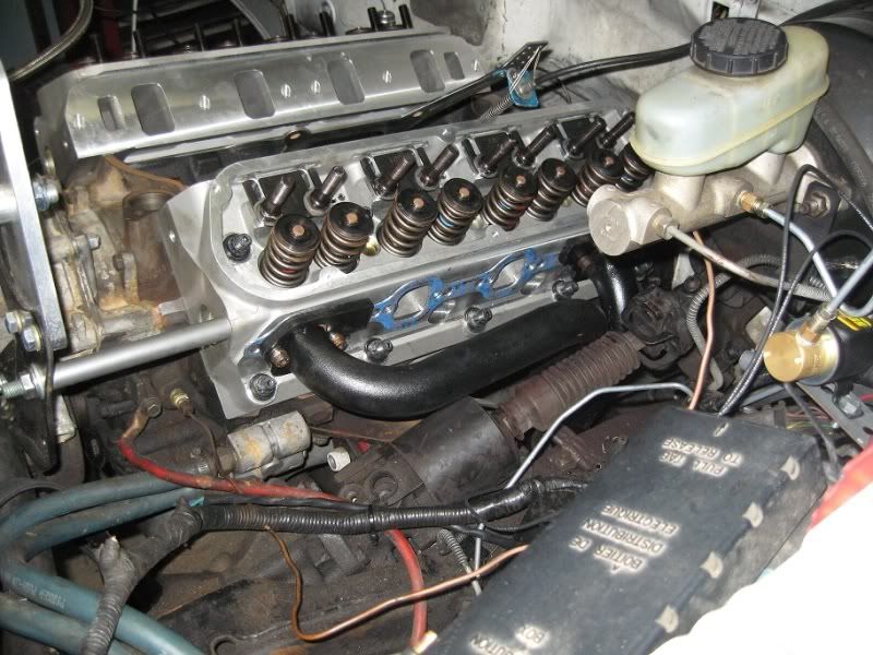

When I built my first 3 V8 Rangers you could buy full length headers from Kaufman. They were awesome!!! I just started building another Ranger and found out Kaufman went out of business. Damn. Gonna try to find some different full length headers and see which ones work. I don't think there are that many out there now but gonna start doing research. Anybody find anything keep us posted. Been out of the loop for a few years and just now getting back in. Will try to post some pics in profile album later about my 93 Splash that was in the July 96 Sport Truck Magazine. It was tricked out with some good stuff including a 150hp shot of nitrous.

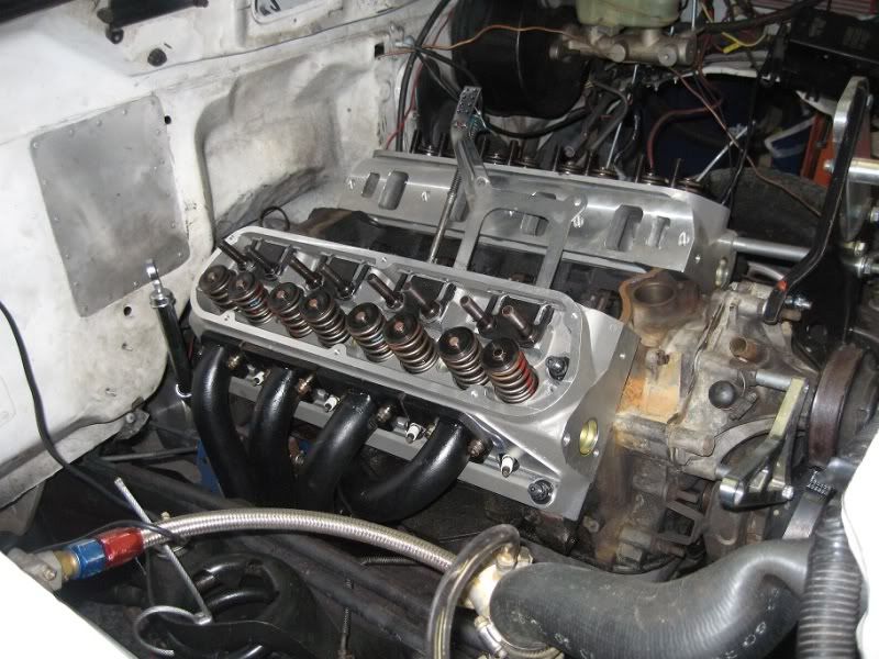

I have a 351W in a 85 Ranger for drag racing only. Currently use Total Performance headers that (barely fit) inside the frame rail. Previously I had custom headers that went over the frame rail and then down just inside fender.

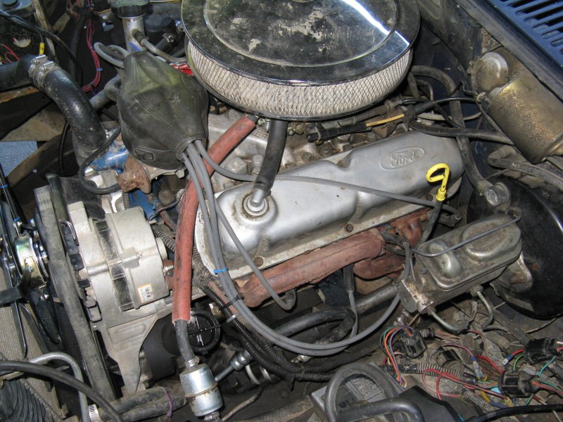

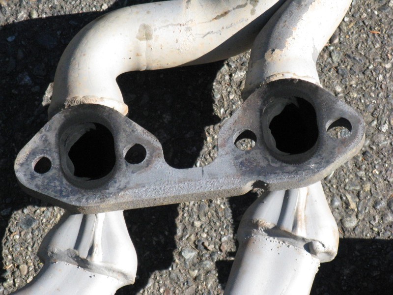

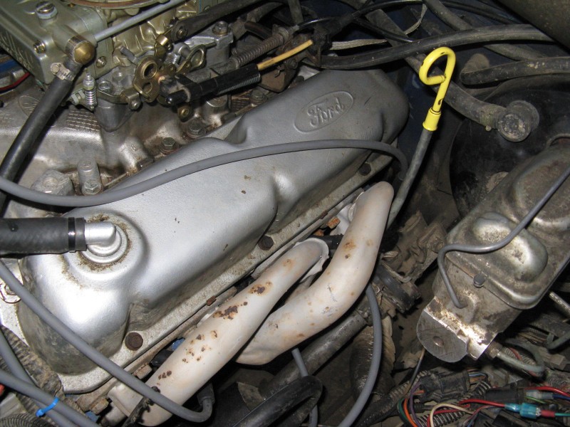

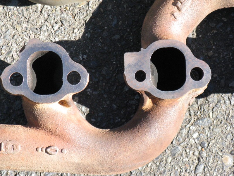

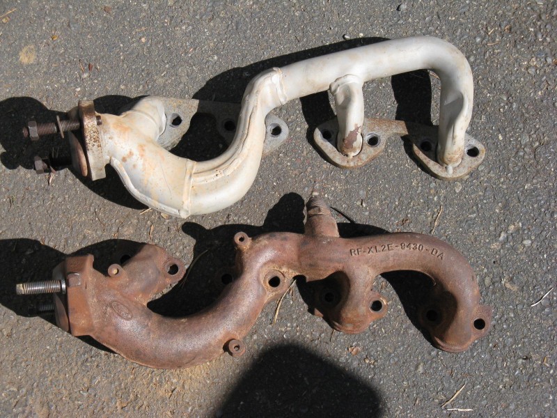

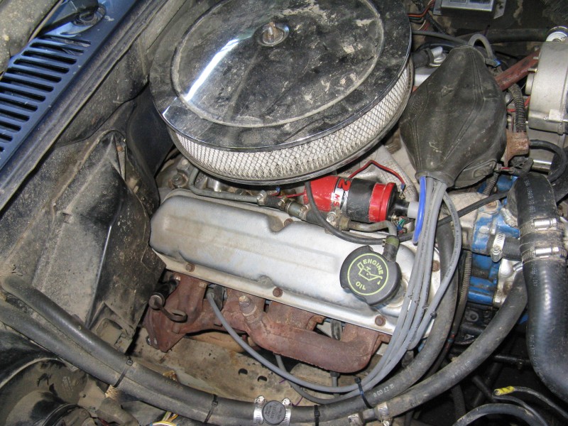

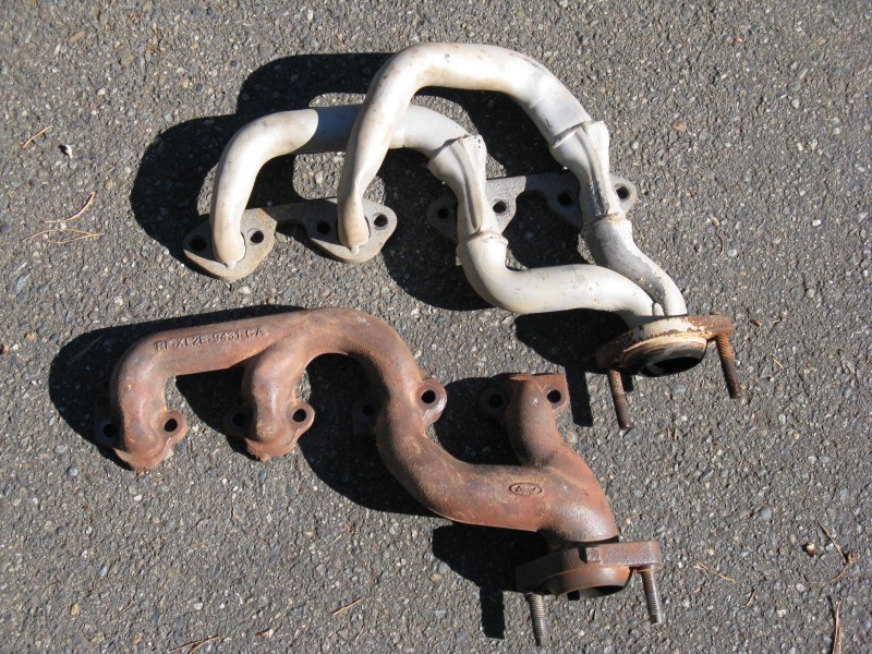

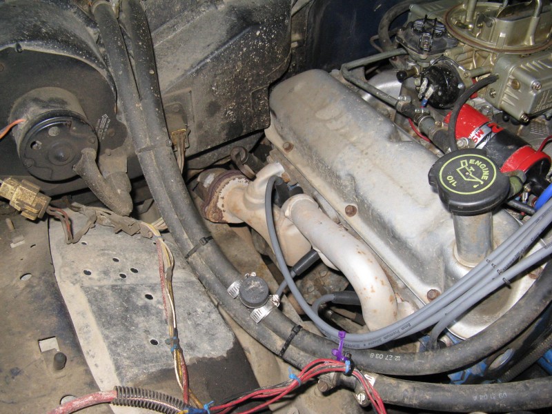

I didn't use Headman headers on my build. I used explorer manifolds. First with the craptastic tubular early ones, then the later cast ones. I picked up noticeable power swapping to the later ones. The early ones flow that bad...
They fit with plate to stock V6 mounts, and fox body 5.0 mounts.
