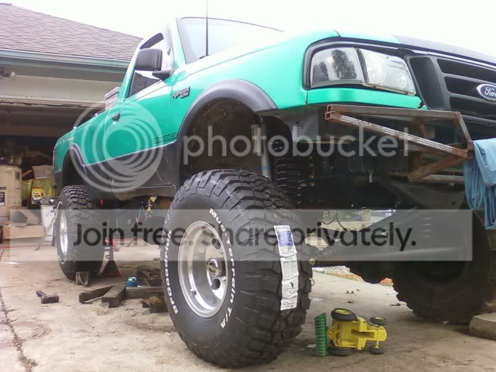

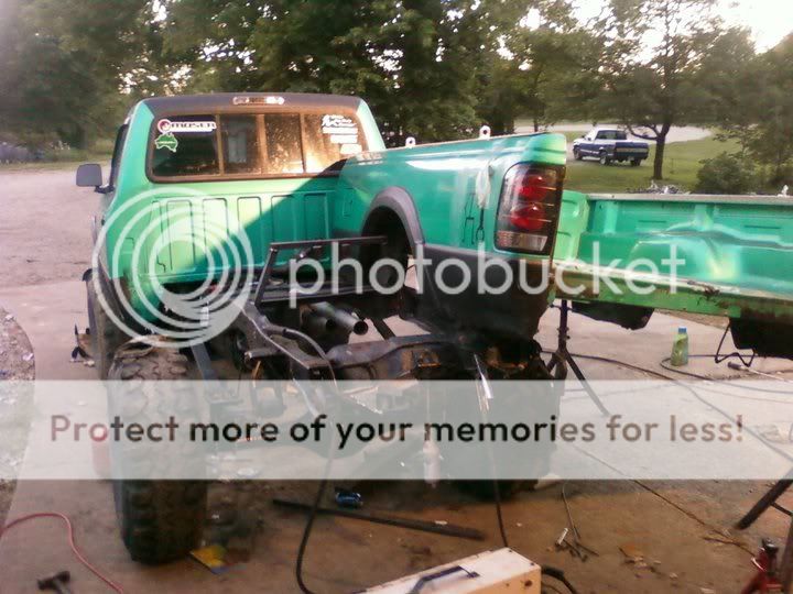

I hope so, it's bout done. Just need to weld the exhaust, And paint my shock hoop. Biggest hold up now is the driveshaft. But if it does go it'll be 2wd...

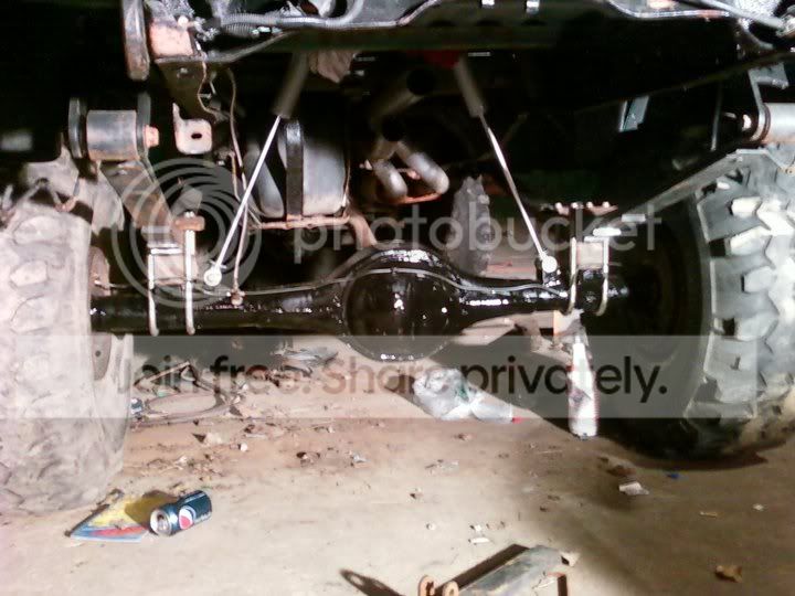

As noted before the truck is almost done, here are the latest pictures...

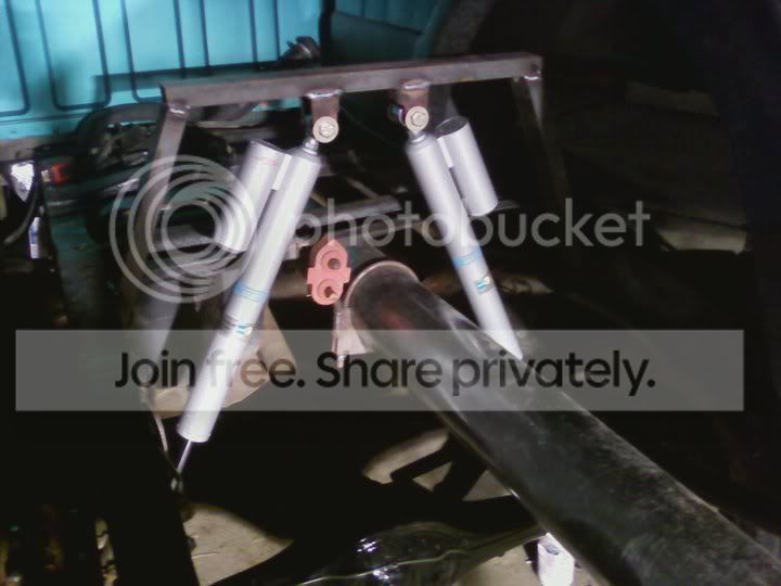

No more wheel hop and spring wrap, and adjustable rear ride height/ spring rate and the ability to carry a lil more weight. Yet still have amazing articulation.
I had this issue where I put 2 35" tires in the bed and it squated just shy of 4". Yeah she's a lil soft in the back. But I'm gunna fix that...
