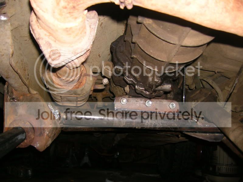

This is the trans crossmember I made up.

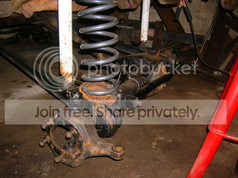

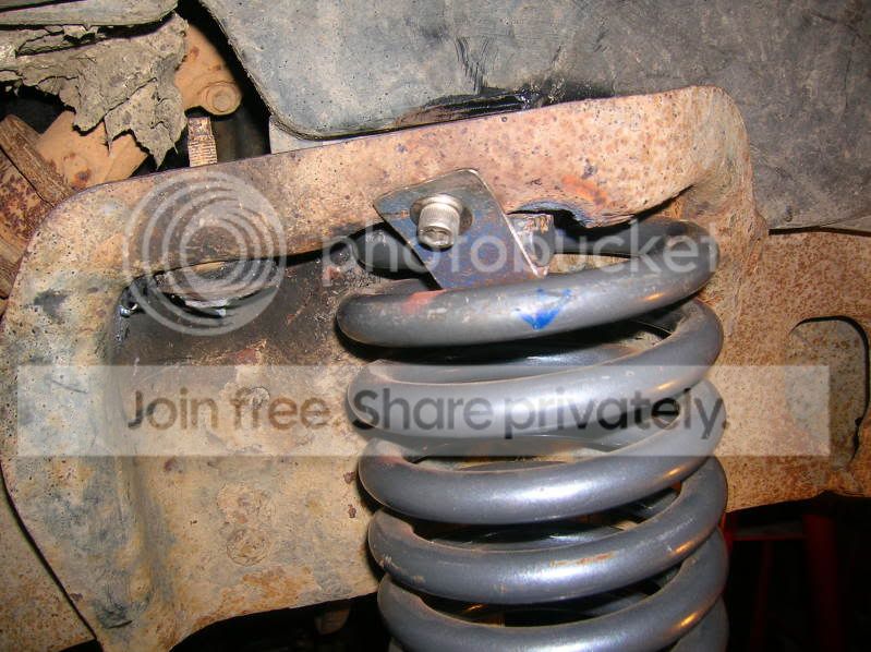

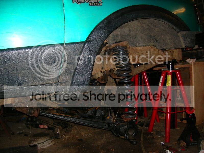

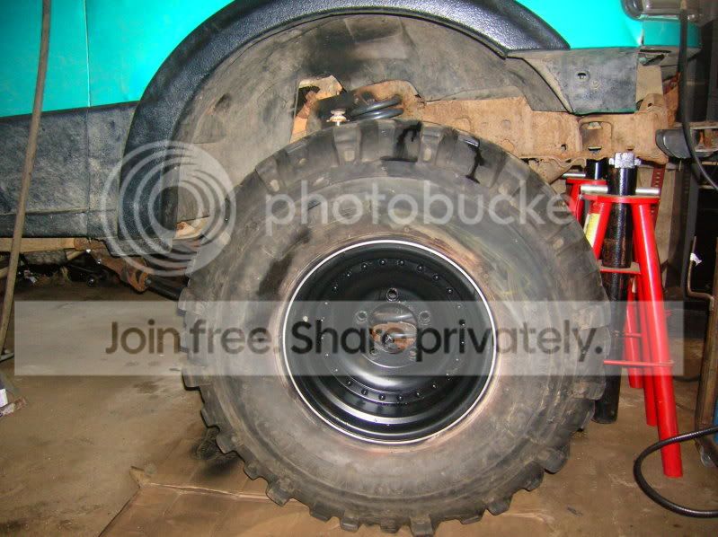

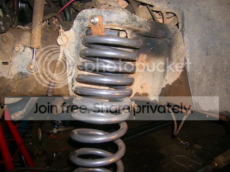

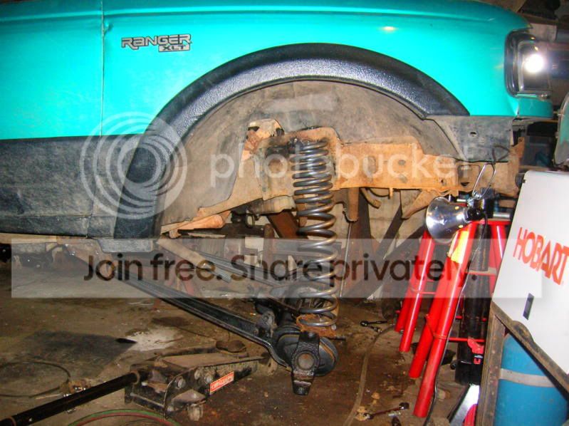

Here's the D44 so far. It's bolted up with all new poly bushings. The coil buckets were modded the fit the EB 5.5 springs. I will be removing the coils and futher modding the buckets for strength and shock mounts.

you should really clean up your cuts with a grinder before you take pics....makes your work seem rushed and shotty...
But it's all coming back out, the seat brackets is getting painted with bedliner when I strip the carpet and do the floors. And the crossmember is getting painted with the bedliner when I gotta pull it out to replace the clutch and slave cyl.
I think your work looks fine...keep it up!!

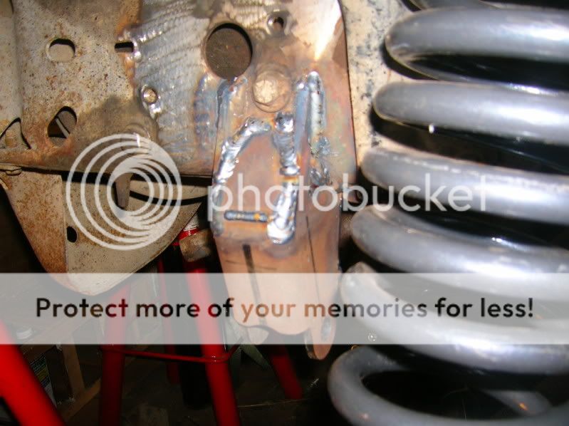

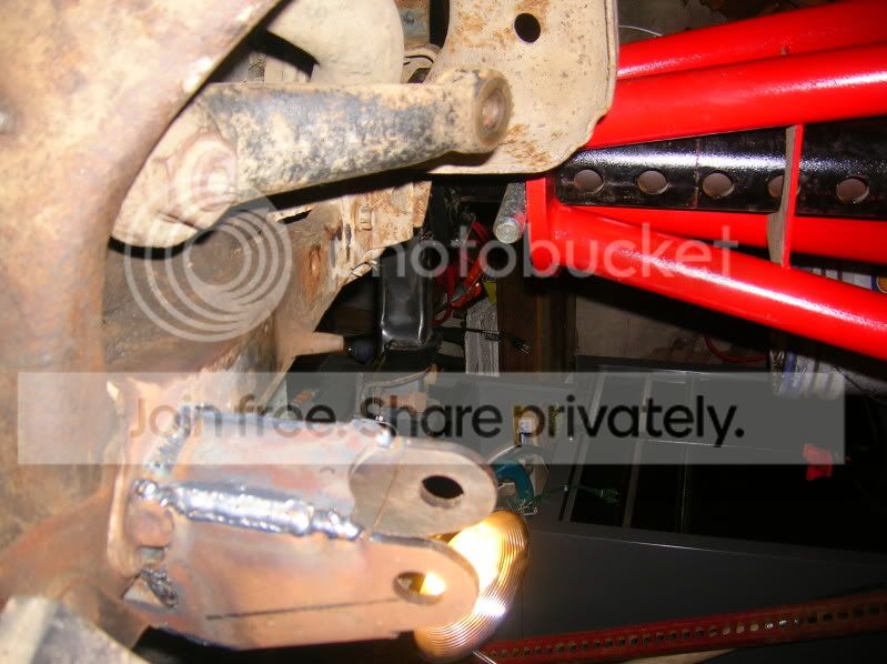

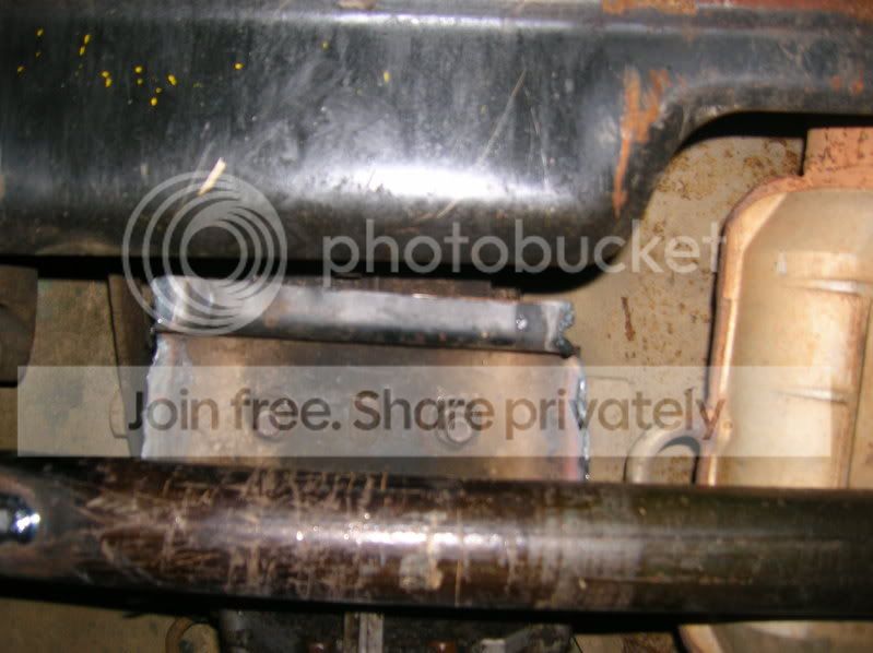

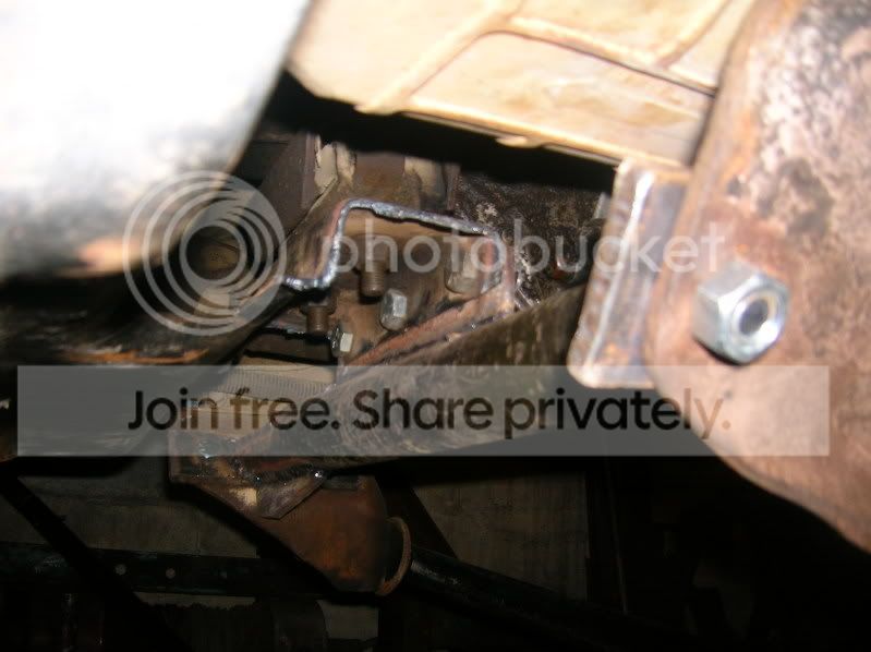

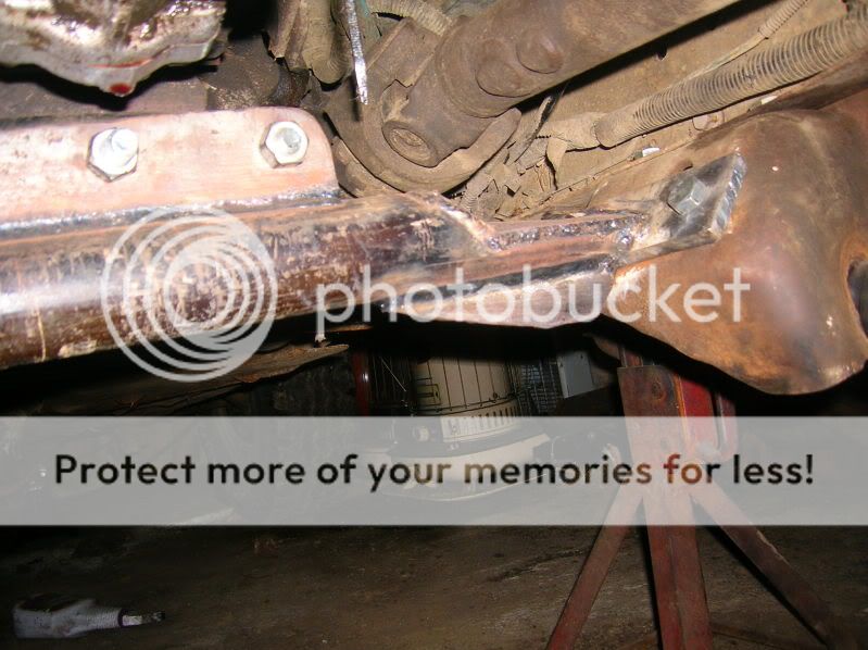

Got my track bar mount welded on. I going to add a couple of plates and a brace to the engine crossmember to further reinforce it. I'm also going to fill the hole in the frame at the top of the front of the bracket. Here's what I got so far...

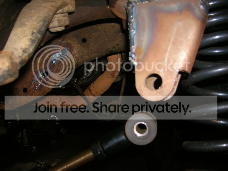

But now I've got this little problem. Track bar is 1/2", the mount is 9/16"

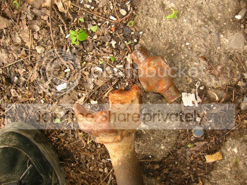

Oh, and I finally got pics of the broken D35 stuff

It's an EB D44, came from a 1975 Bronco sport.
It's actually quite a shame, the body was completely rotted out. It was a fully loaded Bronco, 302, auto, a/c, p/s, etc.
I gotta go back and nab the rear, has the big bearing 9" in it too.

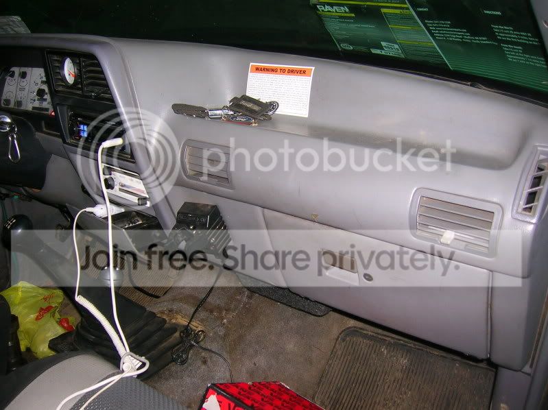

I swapped the grey vents for the black ones
I swapped my pioneer that lit green, for an Alpine that matches blue and red

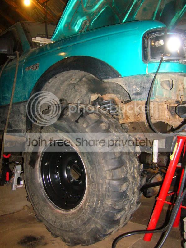

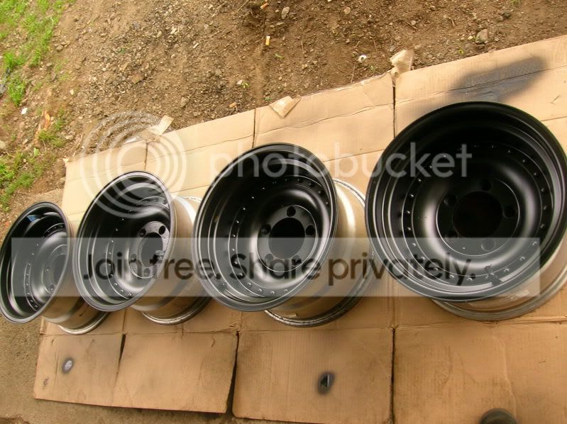

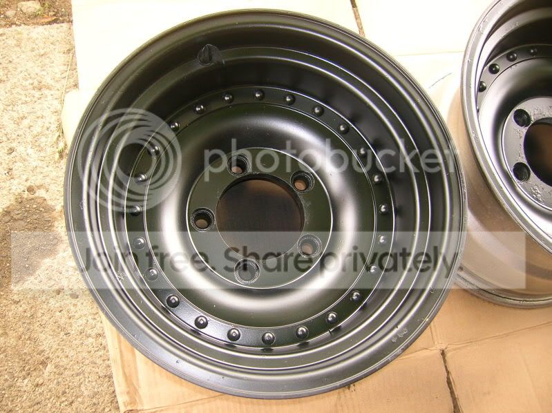

I painted my wheels, sanded the lips.
I mounted 2 of my Swampers
And almost finished the trackbar mount reinforcements, needs a little more welding

Actual ride height will be up about another 4-5"

btw, i can tell you first hand, yes, you do need to reinforce that track bar mount. mine cracked off with a piece of frame this past weekend. i had to plate the hell out of the frame and gusset the hell out of the mount.

And with my track bar mount, I added the 1/4" plates on the sides that go up the entire side of the frame. And I plan to add a brace from the engine crossmember to the mount.
